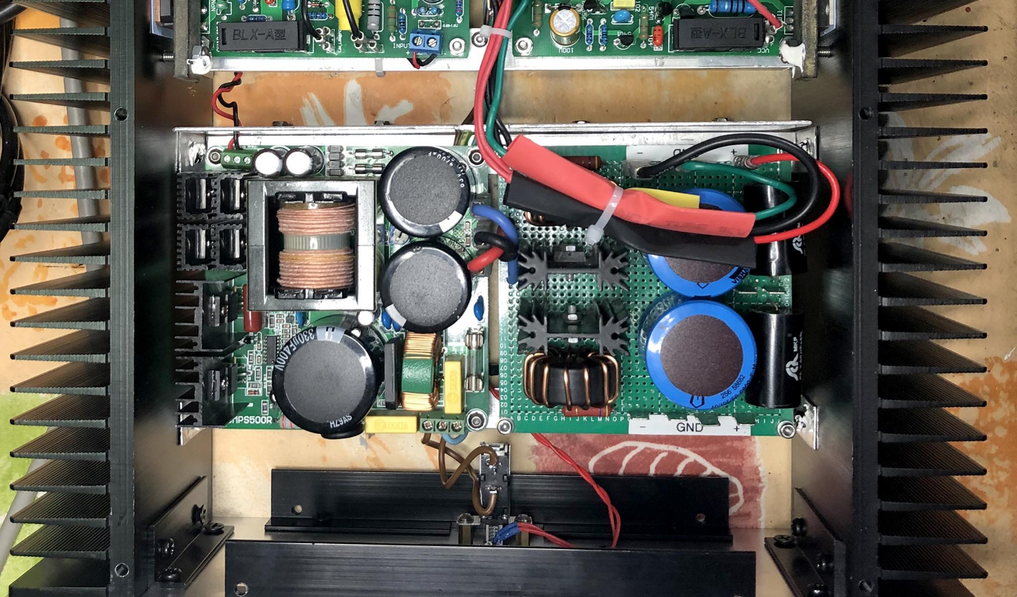

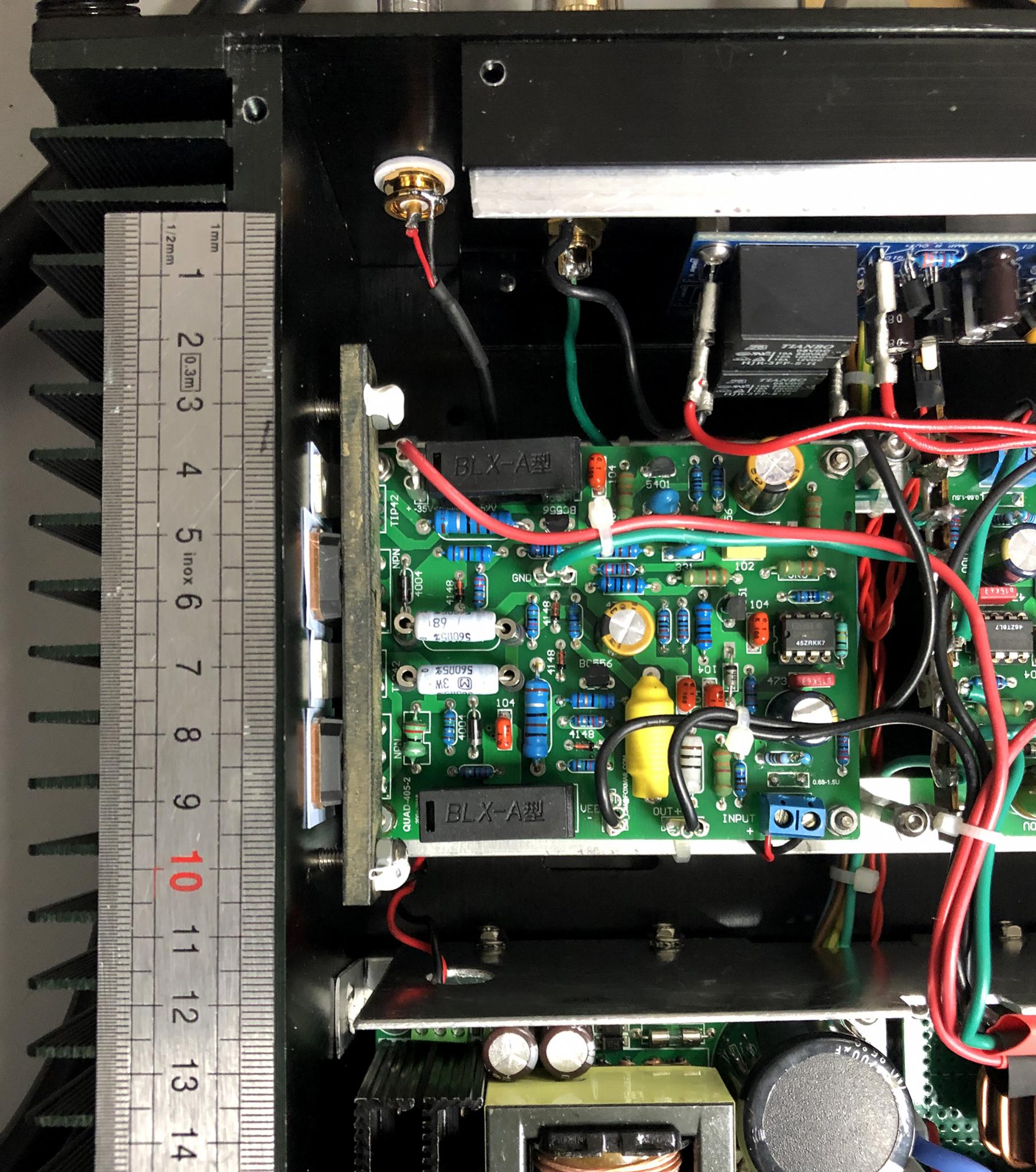

Hello Tiby,
I have had a bad experience with low-end Chinese SMPS. I tested several of them and they burned out after a few weeks.
I am using Connex SMPS500 or SMPS600. I have 50V and 60v version. I also add in some cases an extra PI filter (3300uF on PSU + 10mH + 0R47 + 6800uF + 4.2uF MKP, resonance frequency at 19Hz).
In my Quad enclosure, I have a 50v version.

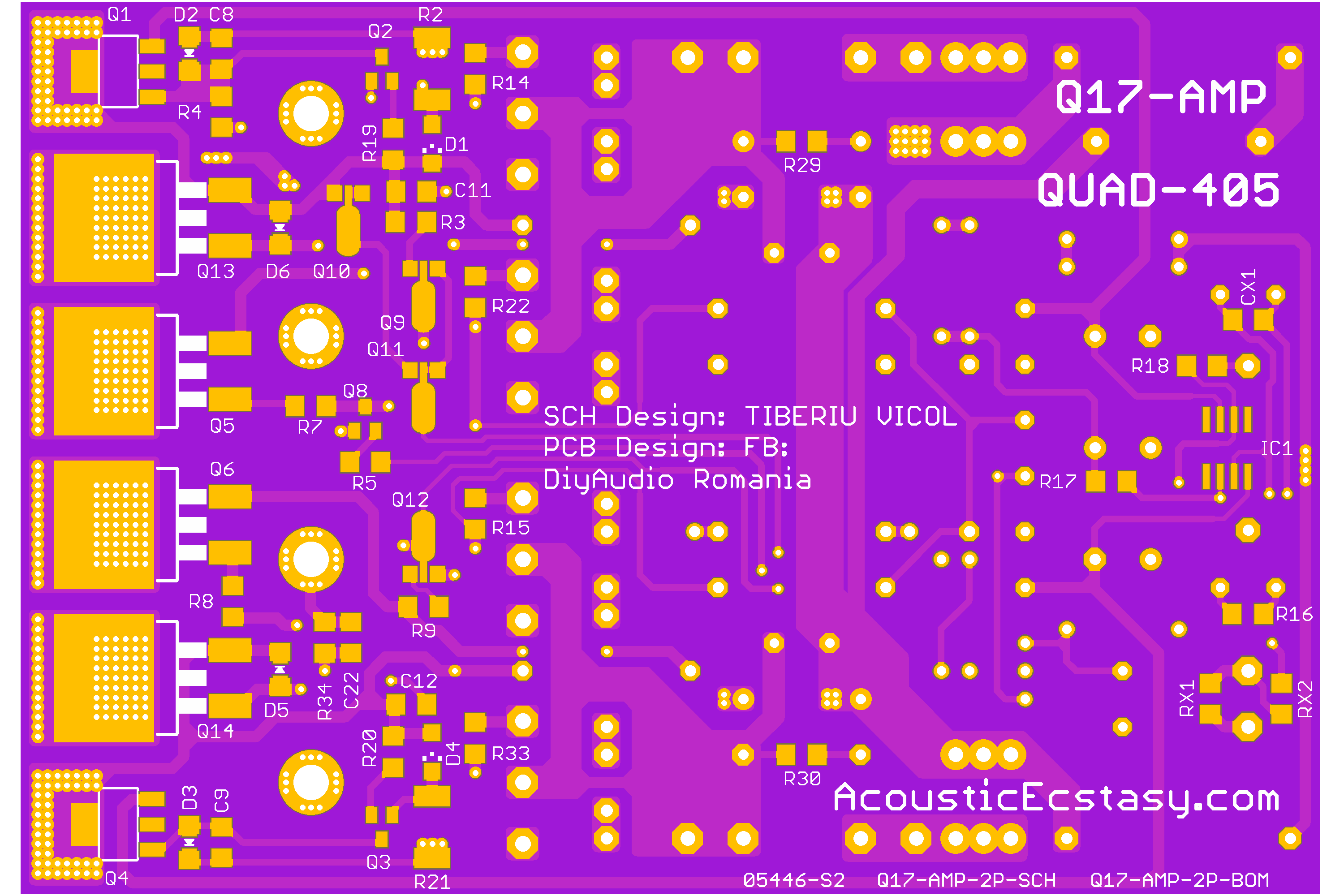

First, I must know if the purple card fits in my enclosure. If not, maybe I can test your SMD version of the board if the SMD parts are already soldered. I can finish the rest.
For the necessary components, I expect an order to Mouser soon. I would take the opportunity to add what is needed for Q17.
Stef.

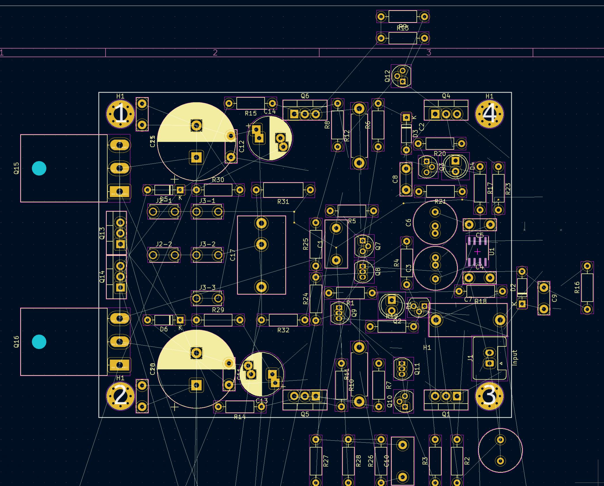

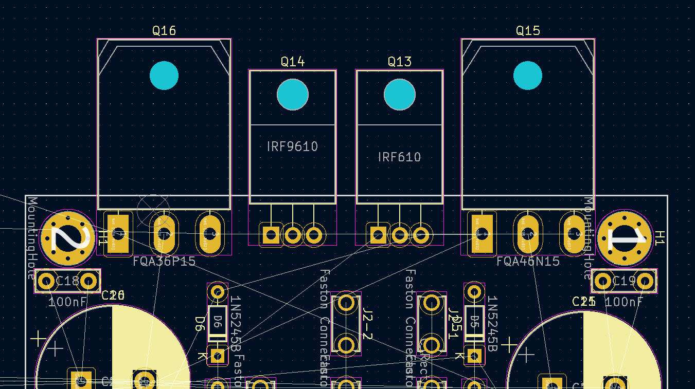

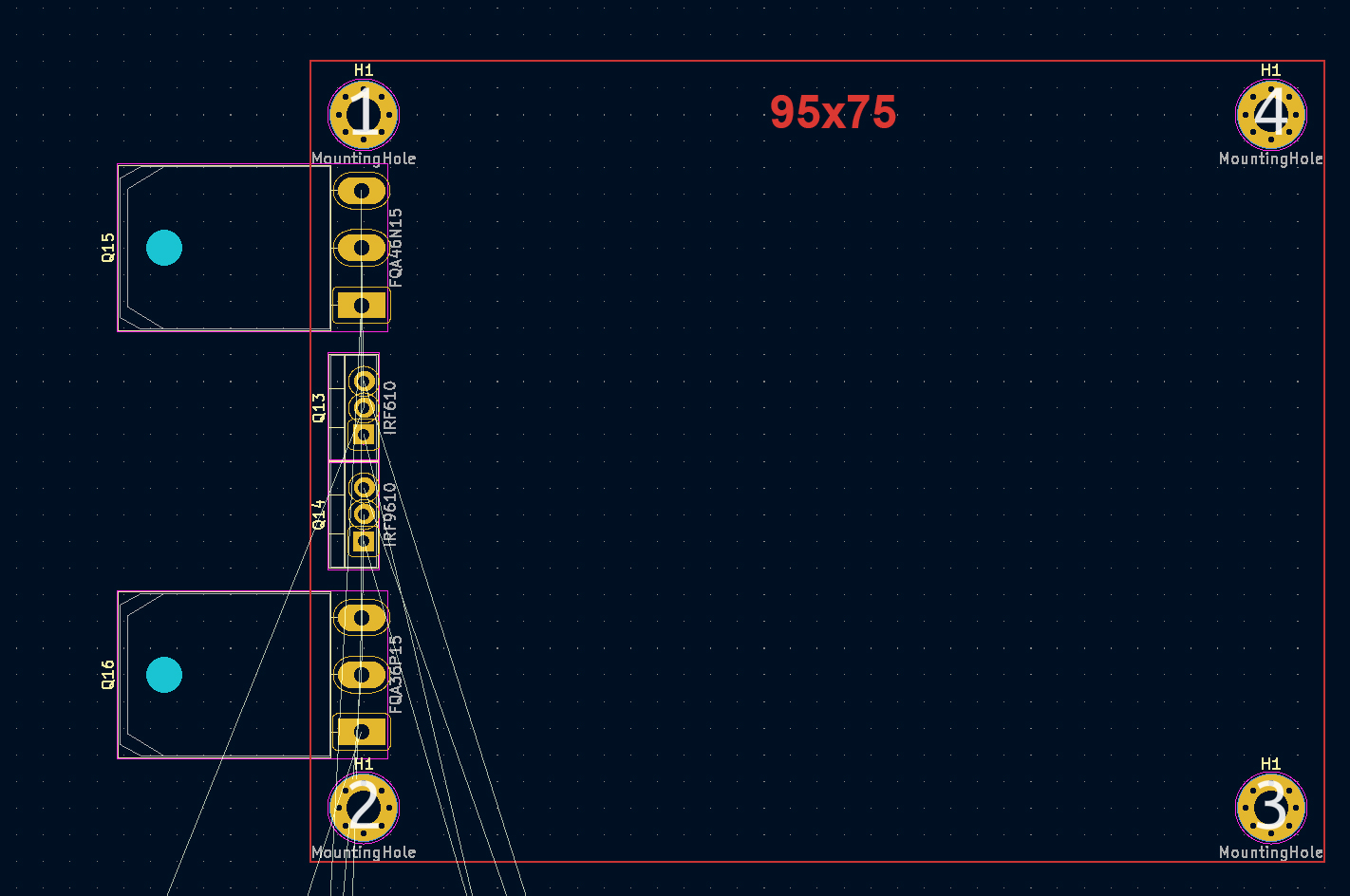

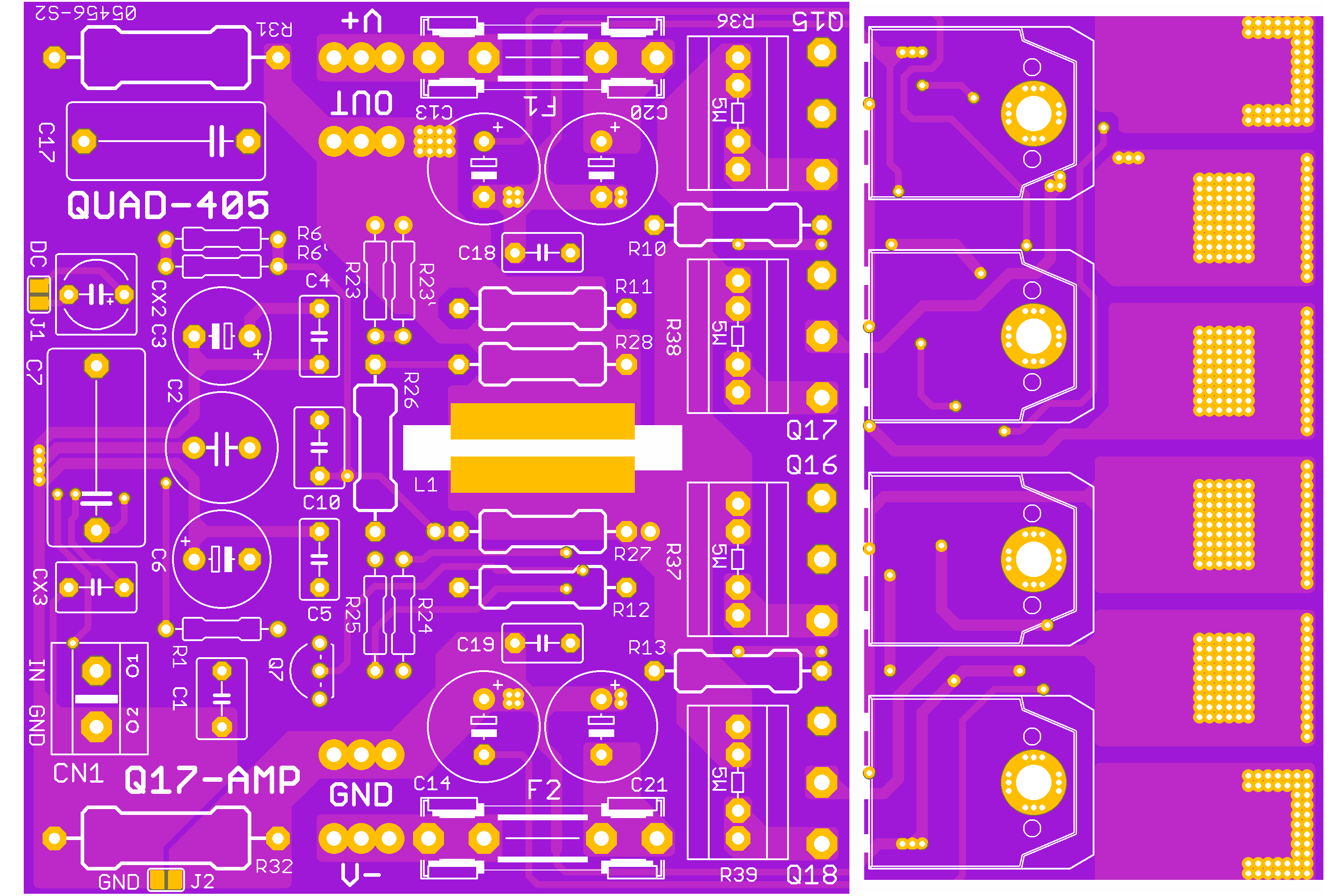

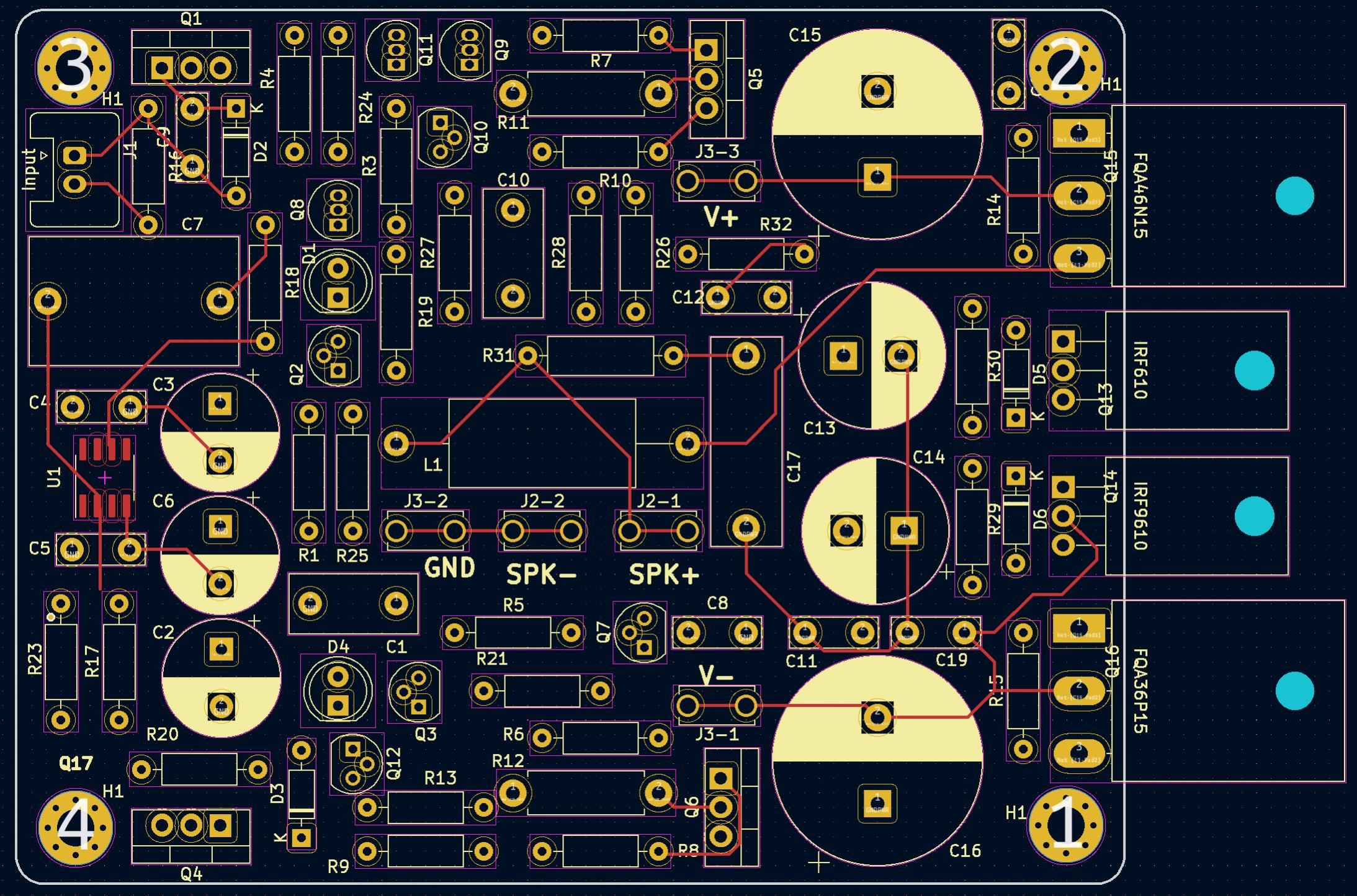

Regarding your PCB with the transistors at the end. Very nice and well thought out.
I wonder if it would not be a good thing to make a version with only two power MOSFETs and the dimension of the LJM board (and same location for the mounting holes). He sold thousands of them. There is going to be demand from those using this board. :xmastree:

Hello,
I have 3 questions if you can answer me.
For the capacities (C15 / C16) on the power supply bus, what is the minimum acceptable value?
For the L1 coil of 1.2uH in radial or axial version, do you have any references?
For the speaker output. Do we need 2 separated pins (out speaker and GND) or can we share the same GND pin as in the real 450 design?
Thank you.
1.For one pair 2200uF/63V is minimum recommended.
2.You mean the position for L1, axial or radial ? This depend on other parts too. For example, the way you mount the board inside the enclosure and power transistors on heatsink.
I would say that having the coil made on a multilayer PCB and mounted vertically on main pcb is the best option. So far Sorin PCB allow this and his coils also measure very well.
3.In case you have a star ground layout, you may use power GND as output.
Again this is up to you and your design.
Tibi
