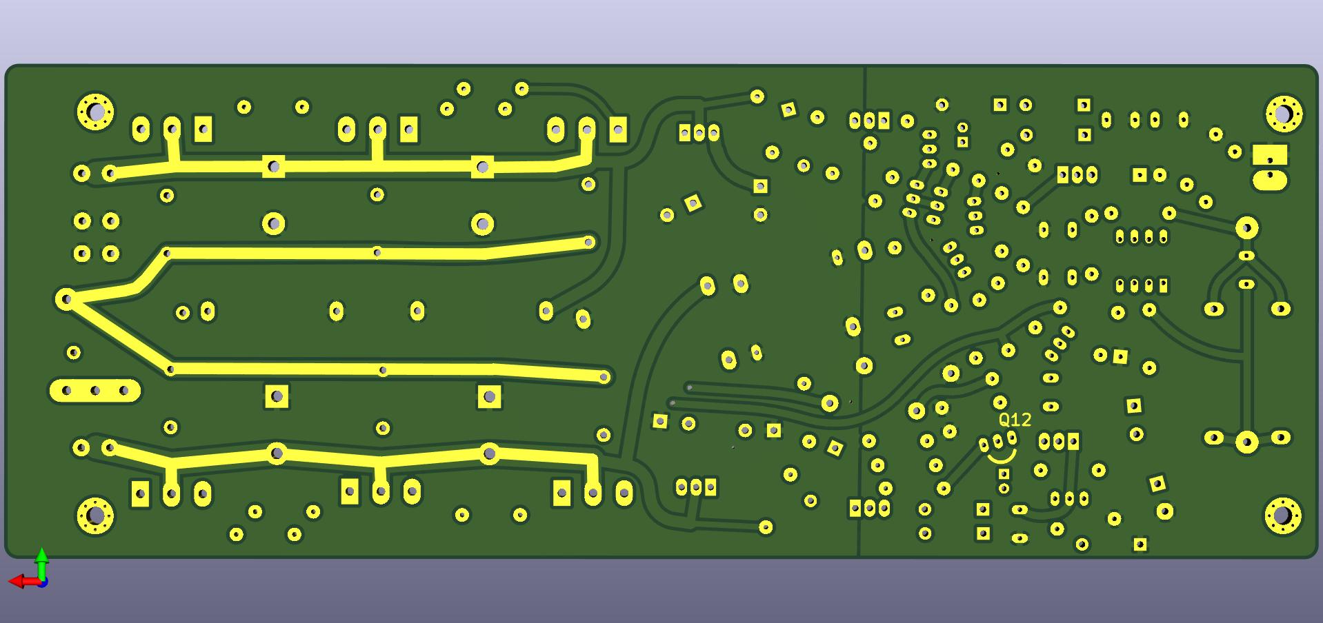

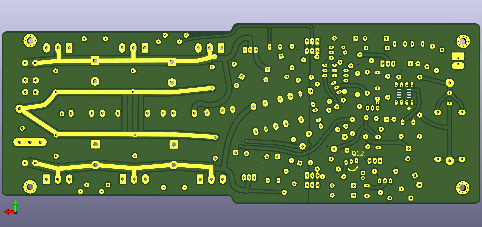

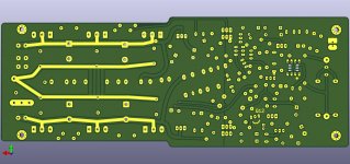

I'm giving the 3 output stage Q17 another chance and have drawn a new layout for it. Again included are footprints for large foils. It doesn't seem ideal what the Wima MKP2 can do, the FKP capacitors sound better. I want to experiment further with C7. My setup with 33nF FKP2 + 1000nF MKP2 played, but just the MKP2 alone was not enough, that was one of the findings from today. Therefore, the old layout was not optimal at this point.
During the revision, I now also moved the coil to the end, so I spare a useless conductor track and I can place the coil further away from the transformer. A very low humming noise was also a deficiency of the construction.
I have also further optimised the tracks and prepared the bottom side of the board for the additional tinning of the tracks.
I'll see what other optimisation options I can come up with in the next few days. For now, this is a board that can show the characteristics of the very well playing two output stage boards.
Regards Tim

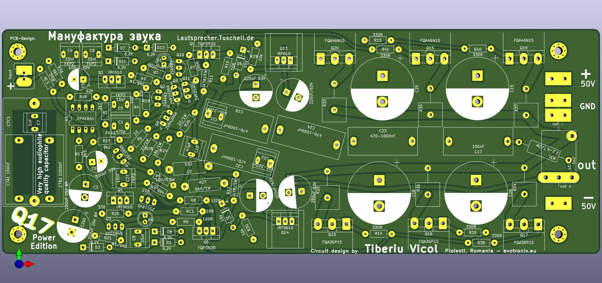

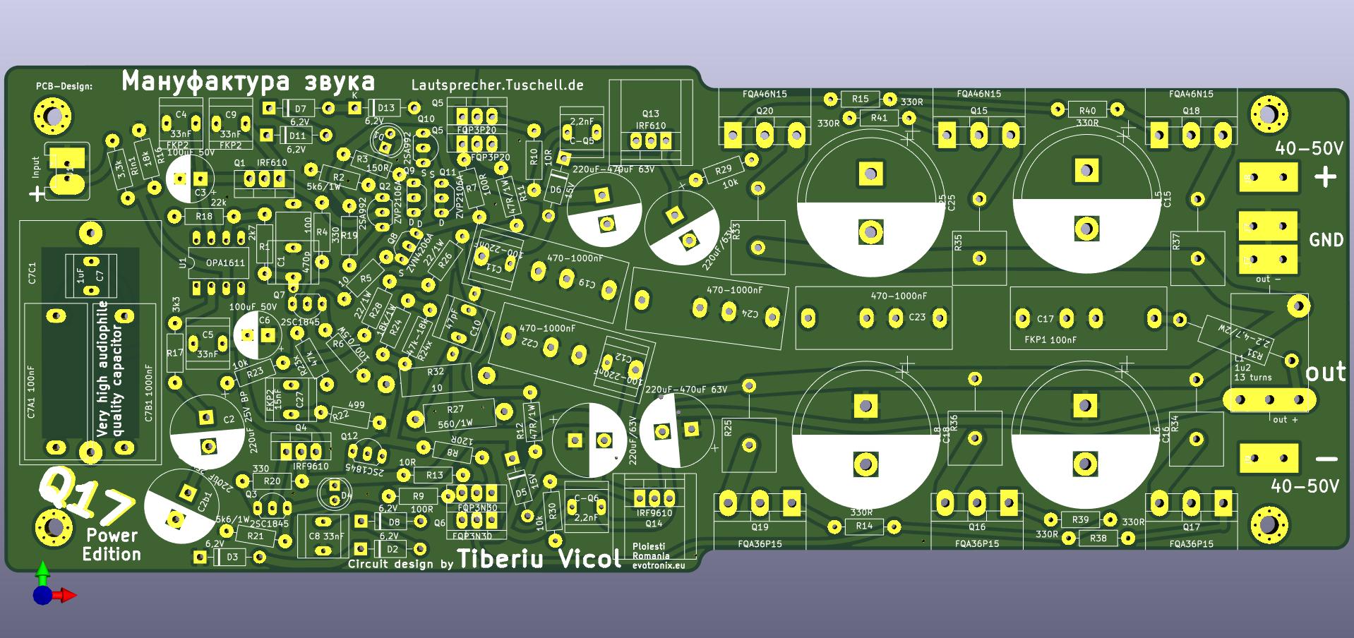

Hello,
I have continued to develop my PCB design, keeping all the essential features of the setup with one or two pairs of output transistors. This is built on a board like the experimental board ( #218 and #253) and has been playing very very well for many hours.
The main difference is the 3rd pair of output transistors and the transistors turned outwards, as well as the footprints for cup electrolytic capacitors. In this case, the transistors to be cooled can be attached to a 50 mm wide aluminium rectangular tube (which is why the driver transistor footprints were doubled), as well as to a wide radiator of at least 114 mm width.
Instead of the potentiometer to regulate R24+R25 I now added a parallel resistor which remains empty depending on the input voltage. R23 is again represented with 10k and can be reduced in value by an additional parallel resistor (this also leads to interference at some point, I had determined 8kOhm in a test setup with two pairs of output transistors and used 8.2k in the finished setup).
For C7 there is a large field of slots for a large number of possible types, also the parallel connection as I implemented it in the experimental board is available.
The capacitors for ripple minimisation and for increasing the small signal power due to the high current capability of foils can be populated in a wide grid of P5/P10/P15/P22.5, depending on how big and in which quality you want to make them. This is even more convenient than with the experimental board.
I made space for Styroflex capacitors C1 and C10 so that you are not limited to Wima or other small foils.
At Mouser, the OPA1641 is not available in the large design (SOIC), so I immediately wrote the OPA1611 onto the layout. I have tested it successfully.
During my experiments with the latest amplifier, I could detect subtle differences in the sound of the OPA1612, OPA1642 and OPA1656, despite all the feedback it generated. The OPA1612 sounded very precise and distinctly realistic. The OPA1656, on the other hand, sounded nicer, not as accurate in its acoustic representation. The OPA1642 sounded a little more striking with an emphasis on the voice. However, the differences are very small. In contrast, an OPA2134 plays harsh and pale in the bass. Compared to these standard types, the three OPAs mentioned above have a clear gap in naturalness, fine resolution, bass precision and resolution in the high frequencies. For me personally, this test confirms that the OPA1611 is very well suited for the Q17 amplifier.
I have now ordered the boards, so I expect to be able to report back by the end of the month whether a version with three pairs of output transistors can then offer any advantages on hi-fi speakers, compared to the standard version from Tibi.
Regards Tim
