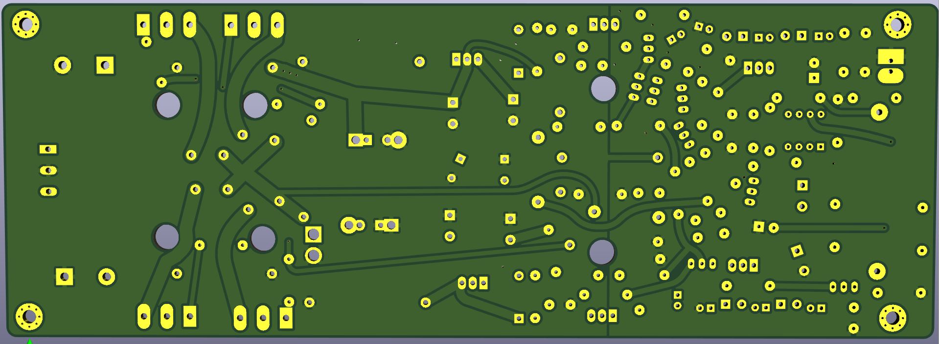

the parallel circuit of C2 does not sound good. I have all kinds of electrolytic capacitors there now and I also bought the MUSE. A single Muse sounds good - just like Tibi has - two 220uF/25V in series sound better. So I have touched the layout again and enlarged the footprints.

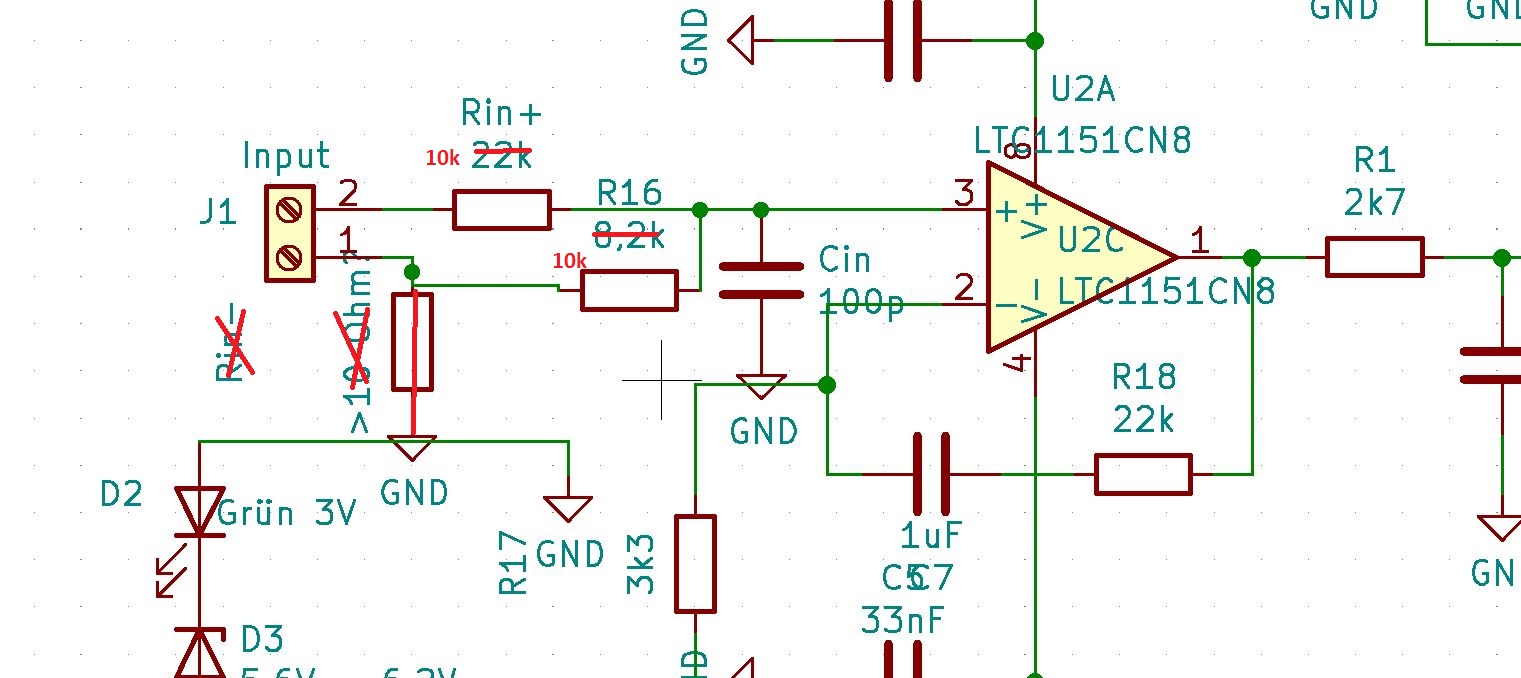

At the input there are now Rin+ and Rin-. It's up to you to decide whether you want to solder wire or resistors. I want to experiment with it to test whether a resistor between GND and input (-) has an effect and what effect.
Regards Tim
I tested the resistors at the input: a voltage splitter 1:1 (R16 = 10k and Rin+ = 10k) is pretty ideal for me, because then the control range of the potentiometer reaches from quiet to ultra loud. A resistor between the (-) input and GND only produces hum, I was afraid of that, but I wanted to try it out. So I installed a wire for Rin-.
This is your current input arrangement, right?

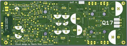

i have uploaded an experiment board here that has some not needed footprints on it.
The unlabeled diodes are for scaredy-cats, I don't understand their sense, because they also burn out in case of defects.
Only one operational amplifier may be installed.
The capacitors C-Q5 and C-Q6 I have not used so far, I would currently leave them empty.
It is up to you whether you equip the output single or double with source resistor. I have built it without source resistor with only one pair of transistors.
R24 = 8k2
R23 = 8k2
Rin- = wire
Rin+ = 10k
R16 = 10k
Cin = empty (my audio cable has enough capacity)
Q9 = ZVP2106A
Q11 = ZVP2106A
Q8 = ZVN4206A
R25 = 0 for + - 33V
R25 = 9k for + - 50V
or something between

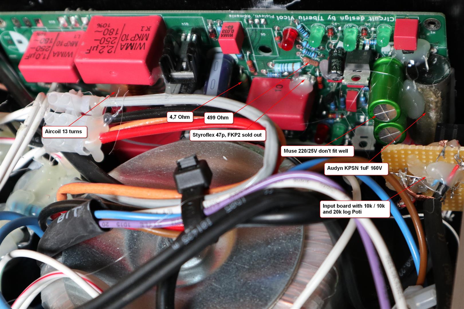

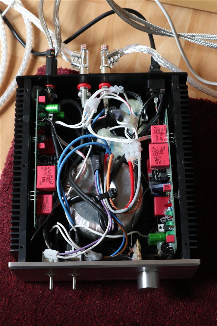

Pictures of the finished amplifier.
Not nice inside, there is very little space in the case. The PCB for the active rectifiers are not there yet, so 4 MUR diodes have to rectify the current.
The amplifier has a 2x 24V transformer, which produces 2x 35V DC.
This certainly does not meet the expectation in terms of sound, so I recommend everyone to use a larger enclosure if you do not have experience in how to minimize and also detect mutual induction.
