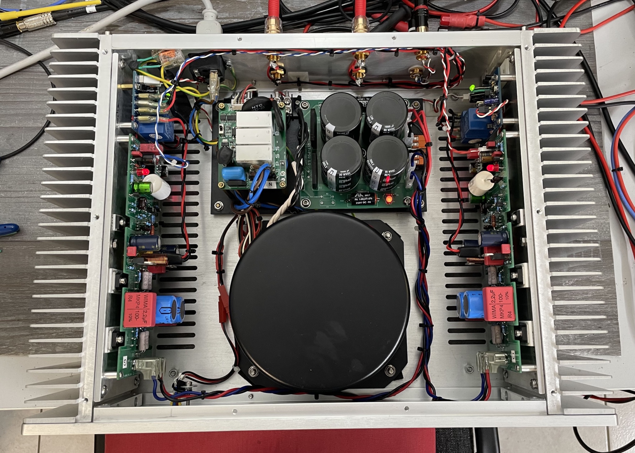

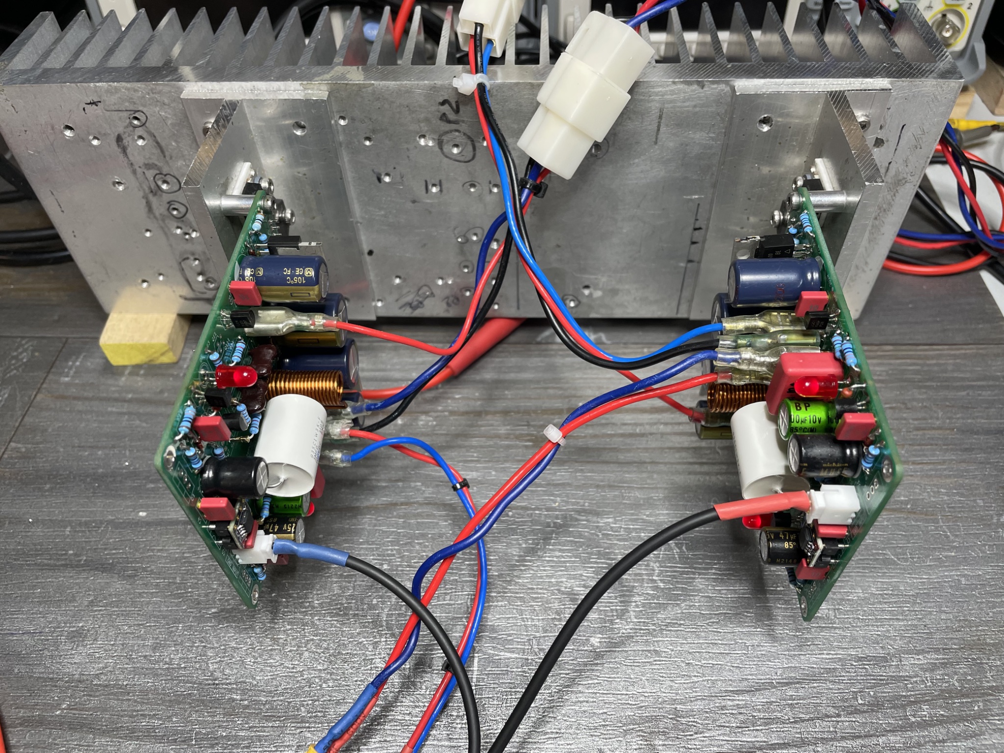

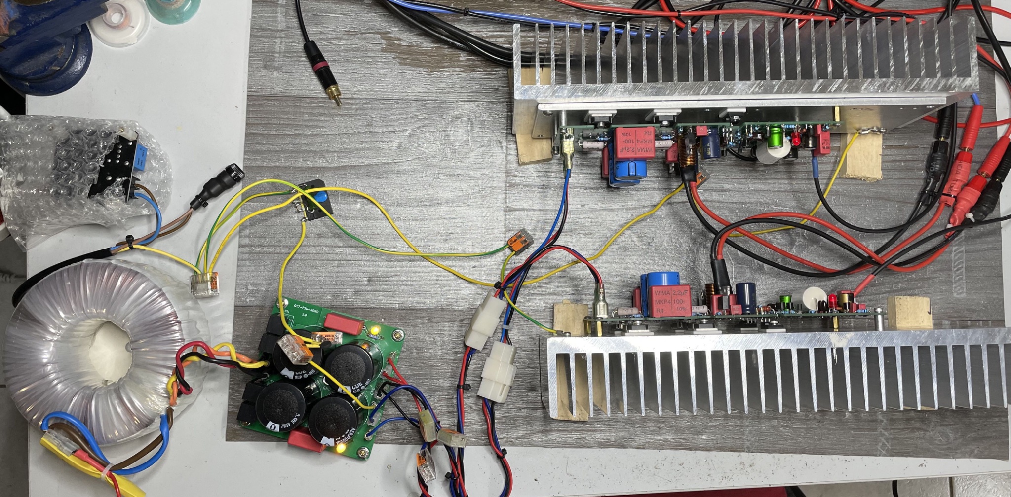

Hello,
I tested the boards with a basic power supply at 58Vdc. Both heatsinks are connected to ground and the GND of the power supply is connected to ground via a 10R NTC and a ground breaker circuit (bridge+R+C).
No noise in the speakers (91dB sensibility). The grounding is good and the 50Hz is at a level that we can't hear. If I move the different cables, we do not hear a rise in hum. The boards seem immune to the wiring.

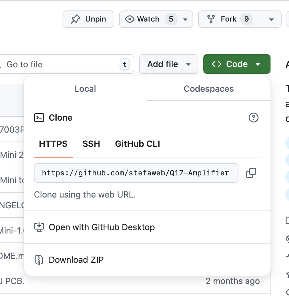

HI,
LTSpice files are here: https://github.com/stefaweb/Q17-Amplifier/tree/main/Q17-LTspice
The best way to bring back files from the Github repository is through the "code" menu.
Stef.

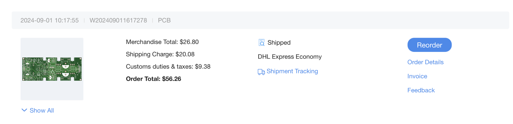

Sorry, I no longer have Turbo PCB in stock.
At https://jlcpcb.com, the price for 5 units is 56$.
For the Turbo, you need a lot of FQA46N15/IXTQ36P15P to match them by pair. May be 10/15 of each. Very expensive.

Thank you for the helpful tip. I was/am not very familiar with How Github works.
regards
Alan

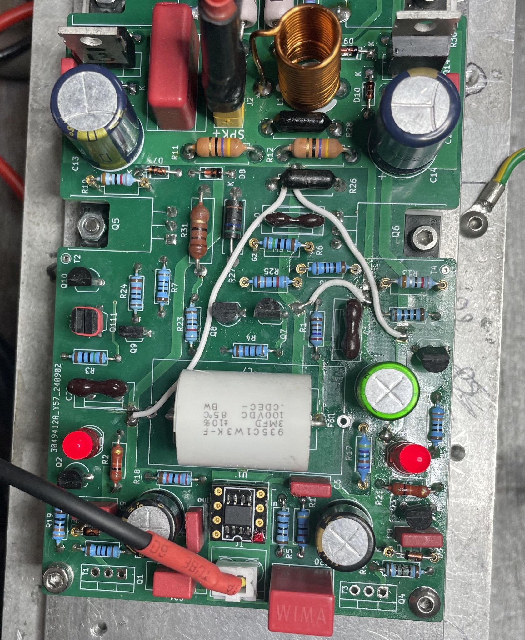

Hello,
This picture shows just one of the many attempts I made to improve the Q17-Turbo ground plane. The PCB published on my Github does not require this kind of modification of course.

Stef ,
In the past I did get a tip from Hugh Dean ( Aspen Amps ) regarding the use of FQA/PF and IXTQ power FETs .
Solder a 470p and 47R resistor between drain and gate to avoid future problems which could happen due the high transduction of those FETs .
This way you slow them down a bit and protect too for the use in amps .
