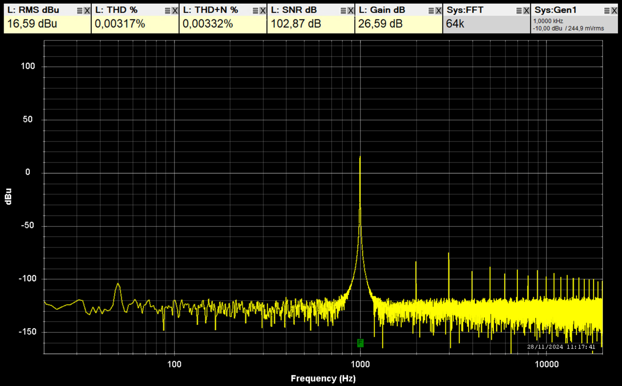

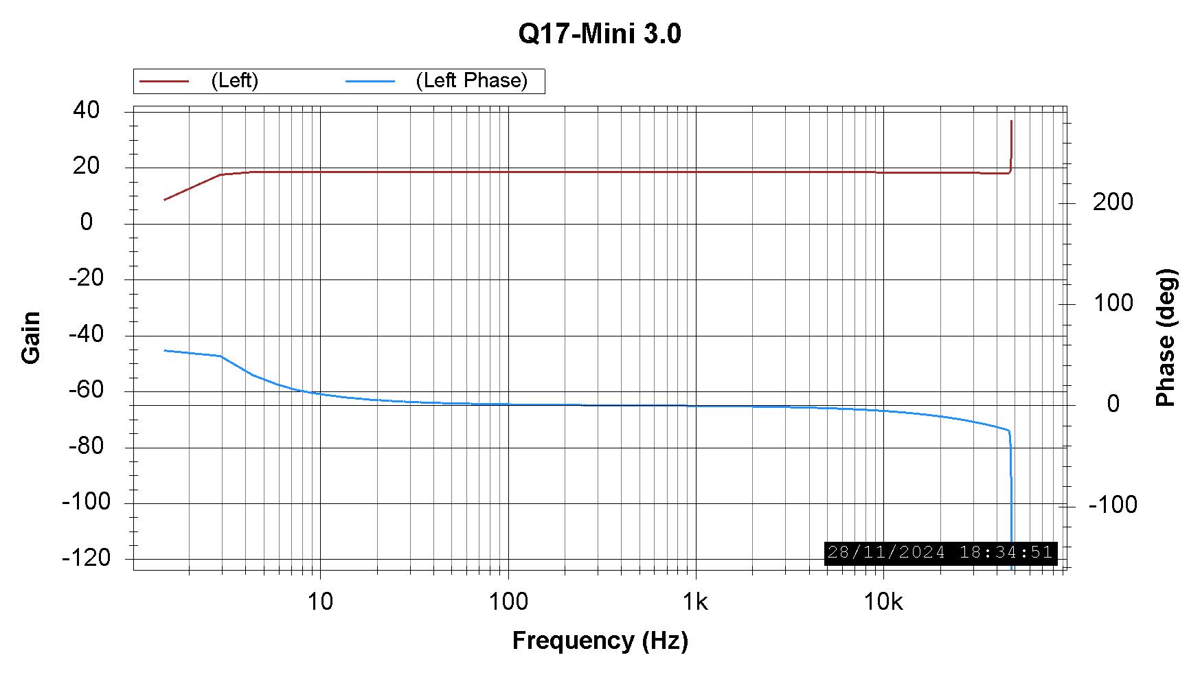

Hello,
I was able to run the Q17-Mini through the QuantAsylum test bench.
On 8R load with -10dB input and the 1.2V sensibility config.
Stef.

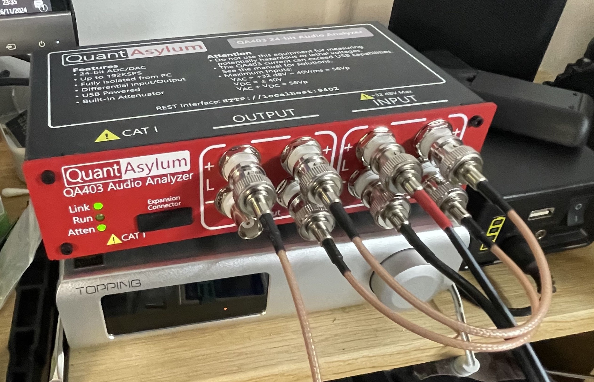

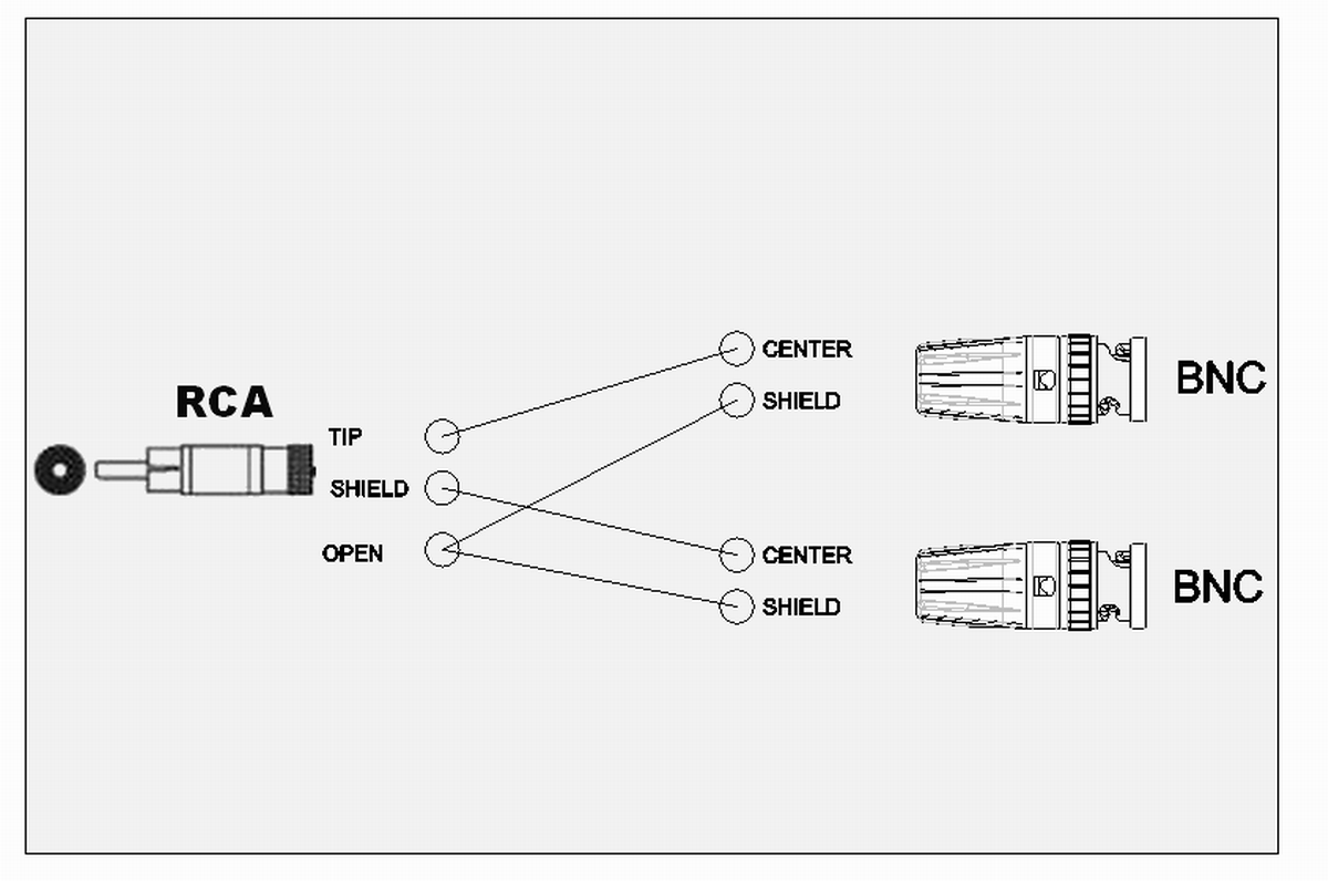

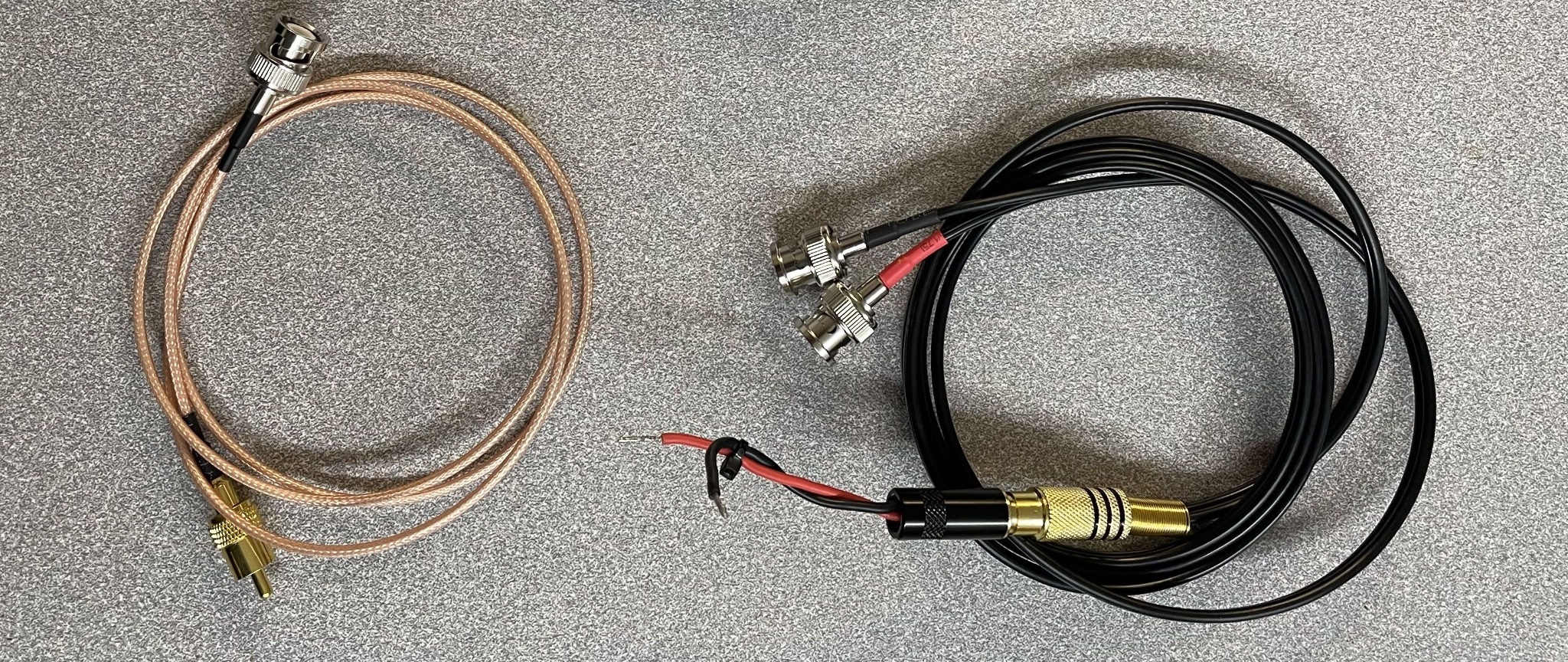

Hello,
The configuration is very simple.
  • One BNC-RCA 1m cable for the output.
  • One 2xBNC-RCA differential 1m cable for the input (to avoid ground loop).
  • Two BNC-BNC 15cm cables for the interconnection of the second channel.
  • A 100W 8 Ohm load.
The 2 x BNC-RCA differential cable can be bought directly on eBay. For stereo testing, you need 2 BNC-RCA cables, 2 2xBNC-RCA cables and 2 loads.
Stef.
