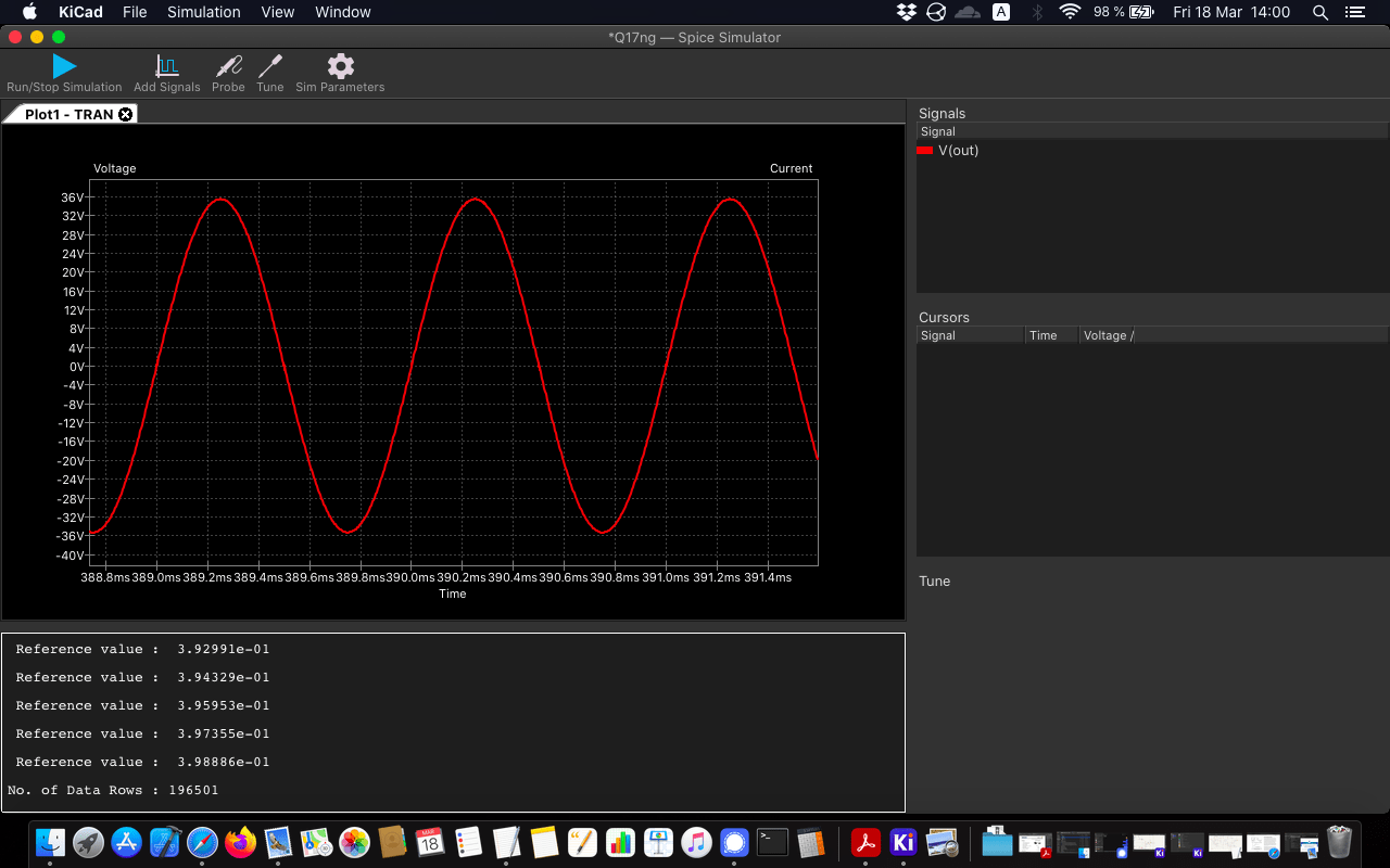

If you like to experiment with simulation, and want to stay within KiCad/Eeschem/ngspice, I have made a simulation setup here: https://forum.kicad.info/t/simulation-examples-for-kicad-eeschema-ngspice/34443

Thanks and o.k.Thank you, Holger ! I'm not familiar with KiCad ngspice simulator, but on next GitHub update, I'll add your files and give credit to you. Are you Ok with that ?

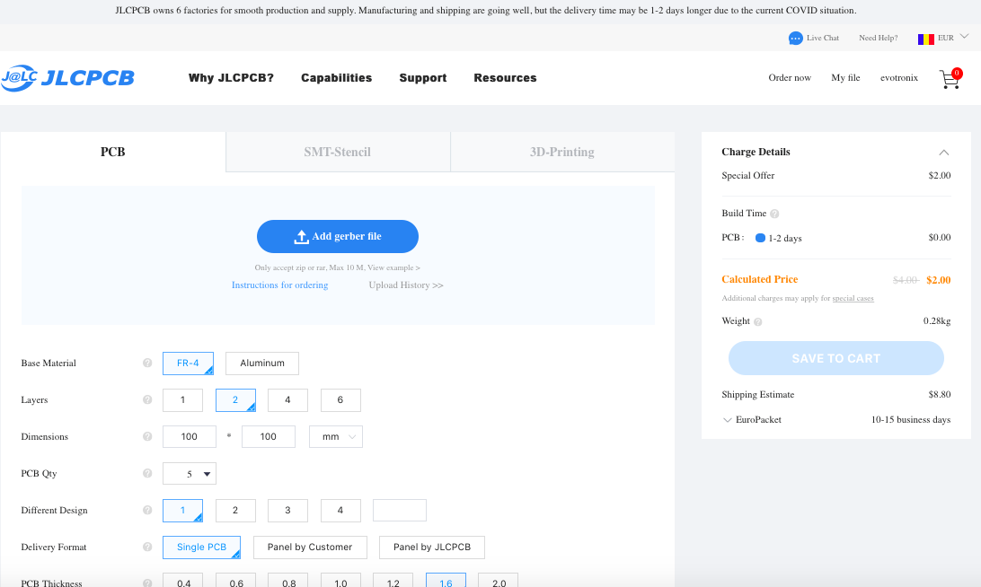

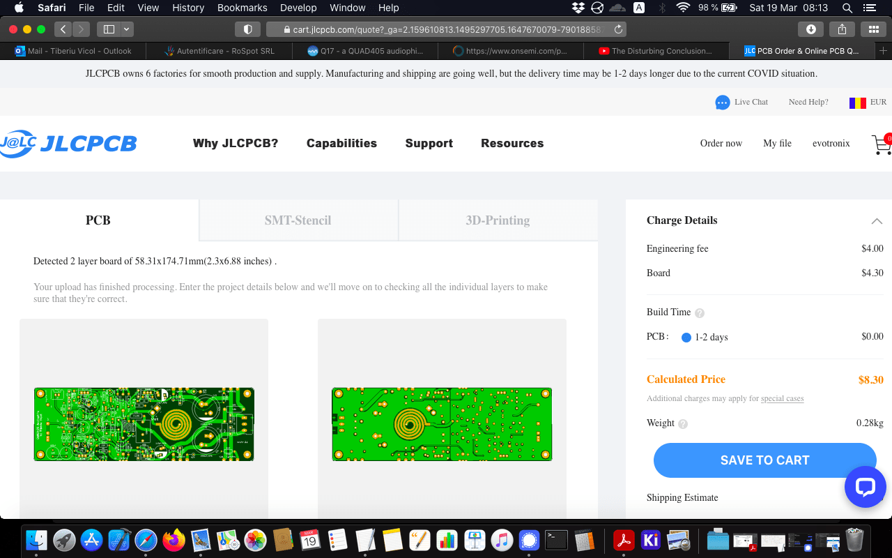

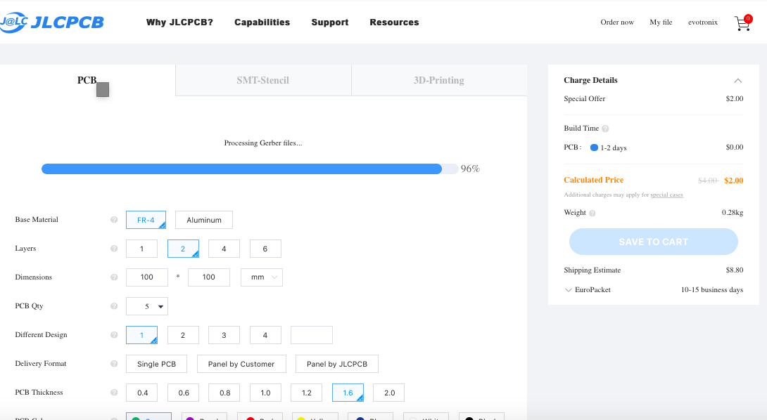

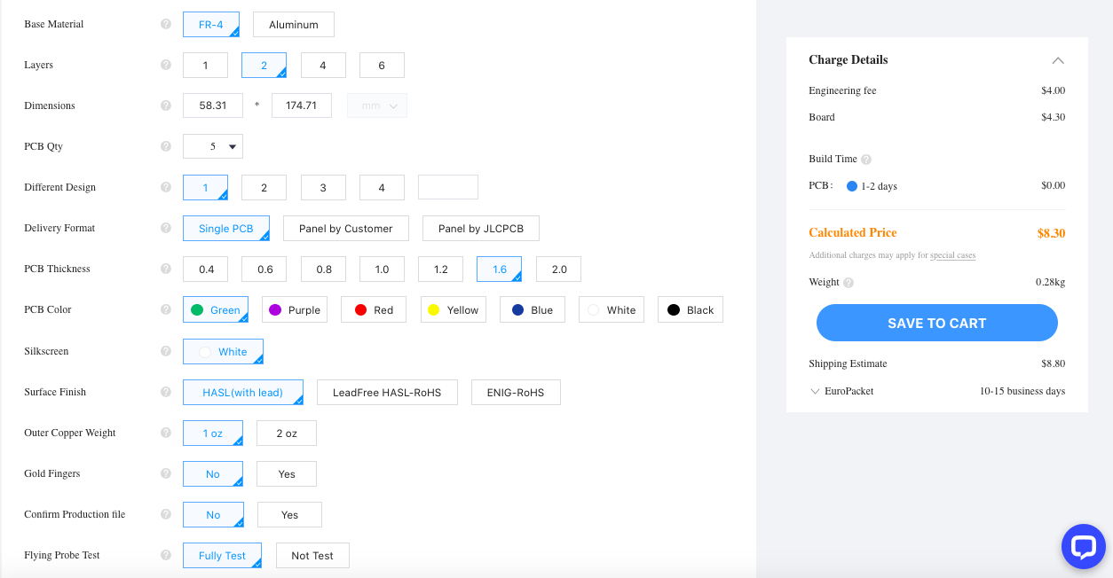

To place an order on jlcpcb or any other PCB manufacturer you need entire gerber zip file.
I'll give example for jlcpcb.
Create an account first, login and top right corner select -> Order now
In the new opened window, click on the big blue button -> Add gerber file
Select and add Q17_2f.zip
Then you will see "Processing Gerber files..."
This take 1 minute or two
Once all is loaded you will see below image:
Now you may go with default selection and click "SAVE TO CART"
5 PCB will cost you under 10$. 10 PCB will be 12.50
Or you may choose better PCB quality at higher cost:
Save to cart, add your shipping details and so on ...
Tibi

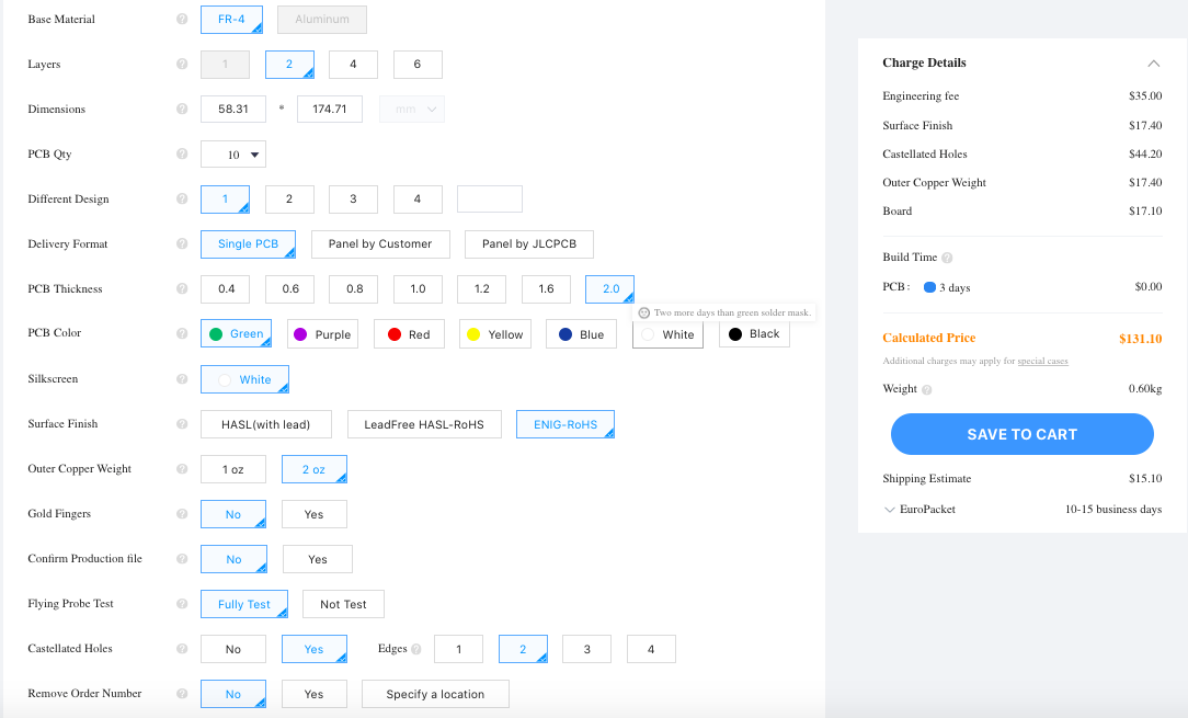

I had a look at the files on GitHub and those from the zip you link to on #1 and they're not the same content. Not complaining, but was wondering if this is just a matter of time before the two are the same. Or not. Have those who've not found the 'double' version have been looking at the GitHub files??? Those from GitHub are from 2021/11/03 while those from the zip are 2022/02/27...
I have a question. I'm going to order amp and PSU boards from JLCPCB and was wondering about copper thickness. I'd thought to go for 2mm/2oz CU but was wondering if that's going to be OK with that rather clever spiral. Can't think it should make a difference, but I'm not anywhere near knowledgeable enough to know it won't make a difference.
I can assure you that it makes a difference whether you order 35um or 70um copper. Especially with the coil, because the coil is an audible resistance. Here audible is to be understood as follows:
Assuming your speakers have very high quality technology, so they are capable of making small differences in resistance audible between the amplifier and the speakers. If that's the case, then speakers with a printed coil of double copper thickness will play drier bass with more precision and punch.
That's why I've always used the large wire air core coil in my setups, as it delivers even more punch.
Advantages to the single layer printed coil are when you have small speakers, or full range speakers or something like that, that benefit from lower internal resistance of the amplifier output and create the illusion of bass by resonating.
Regards Tim
