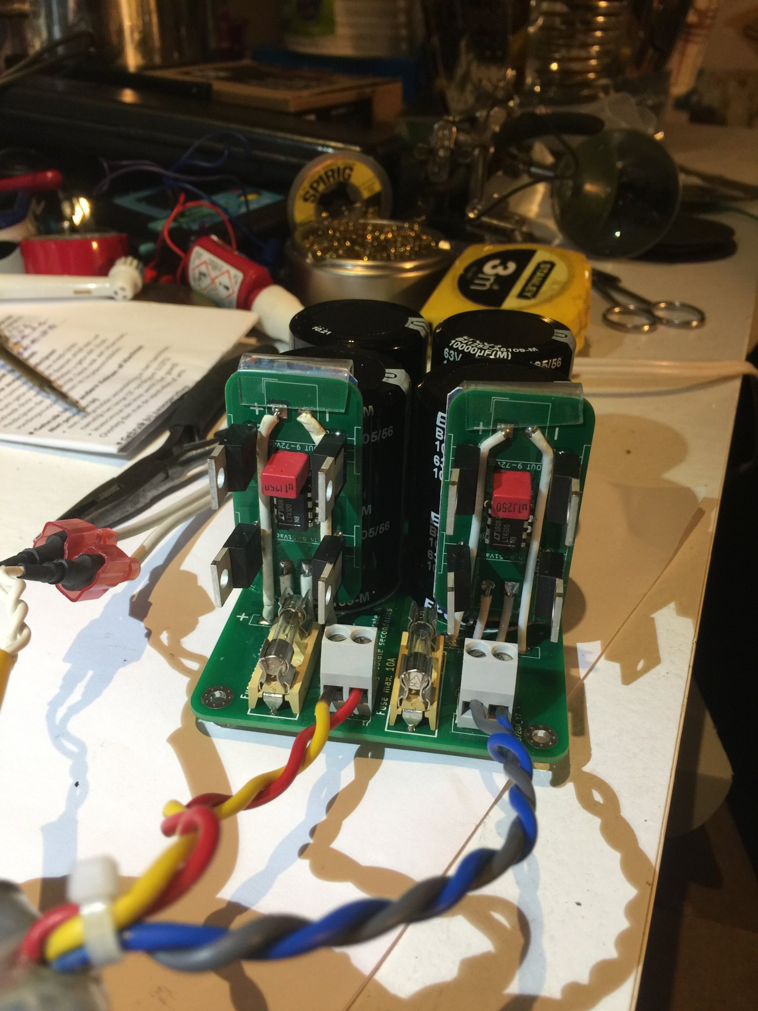

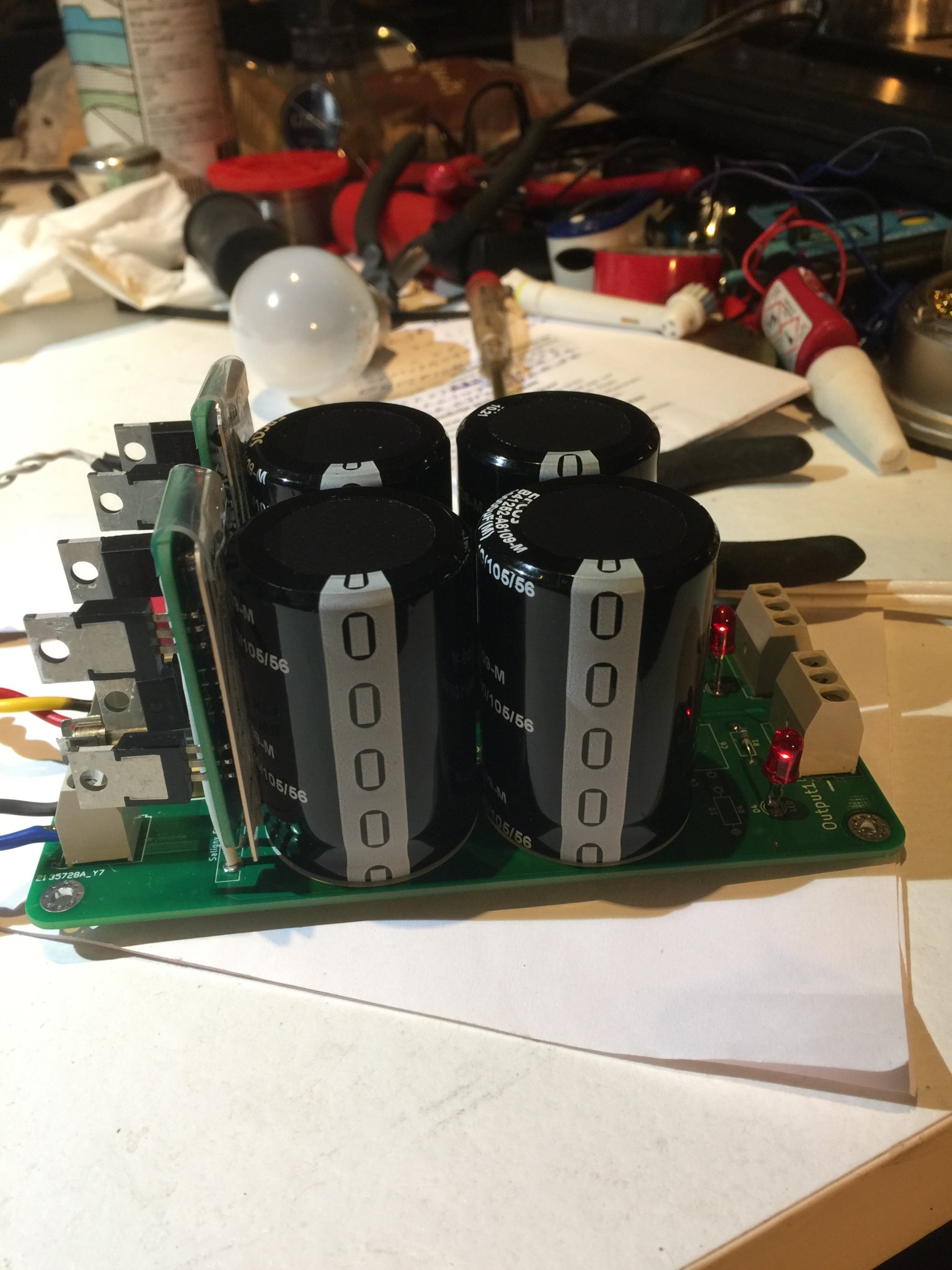

Thank you ! The ideal bridge mentioned here https://www.diyaudio.com/community/threads/ideal-bridge-rectifier-gb.333844/page-21#post-6212303 will work. To use active power supply, which come with this project, you need a smd bridge similar with Saligny Standard.
Hi Tibi,
What is the difference between the 'ideal bridge' mentionned on de first line, and the one used in the 'active power supply'? I thought they were technically the same?
regards,
Ed
Hi Tibi,
regards,
Ed
Nice implementation !
The obvious difference is that one is THT - open source -while other one is SMD - commercial. The SMD one will fit pcb better.
Both will work very well.
Tibi
Tibi

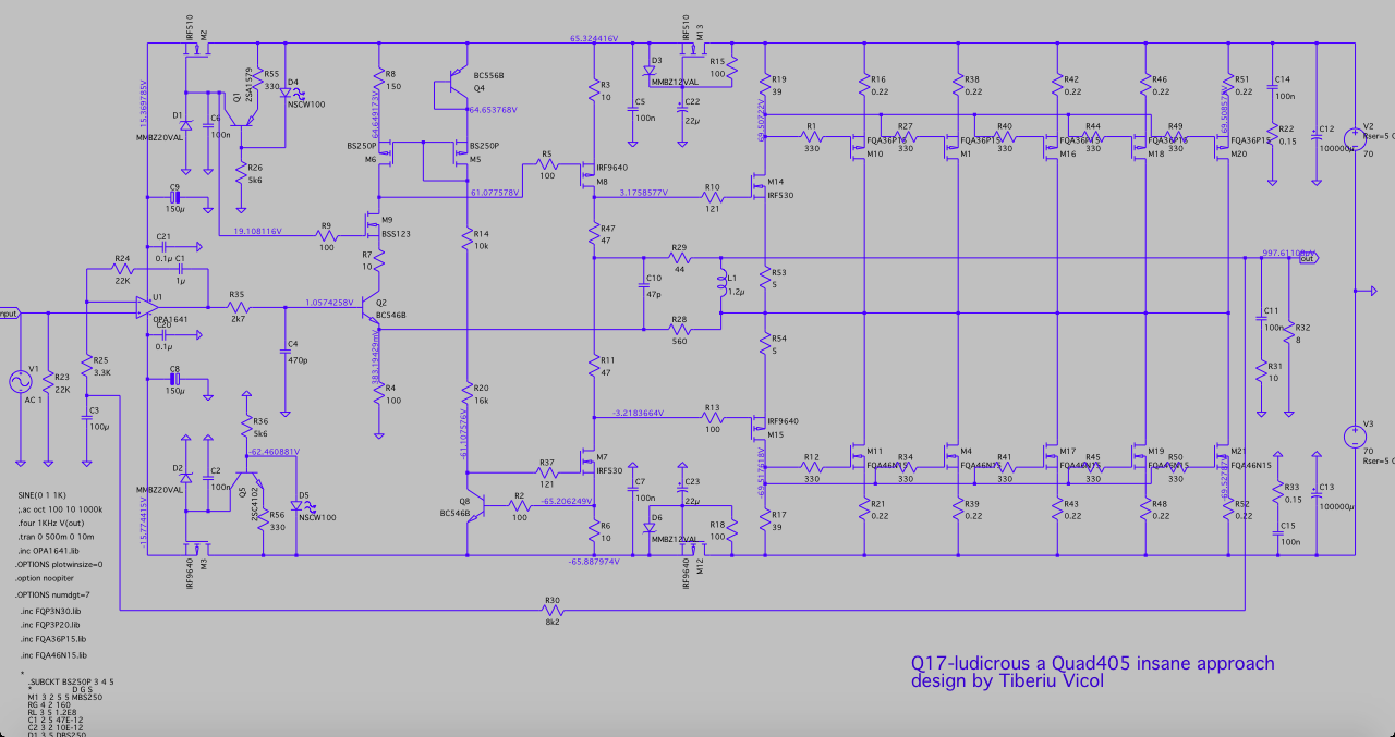

In the last days, I was playing with a very high power Q17-ludicrous.
This will be able to deliver at least 600W/8hm, 1200W/4ohm, 2400W/2ohm.
I already made few high power Q17 using Exicon double die laterals, but this is a different approach due very high capacitance of Fairchild mosfets.
Please take this as an exercise. In real world, some parts must be adjusted. It will simulate ok, but practical implementation will be a challenge.
Tibi

Hello Tibi,In the last days, I was playing with a very high power Q17-ludicrous.
Tibi

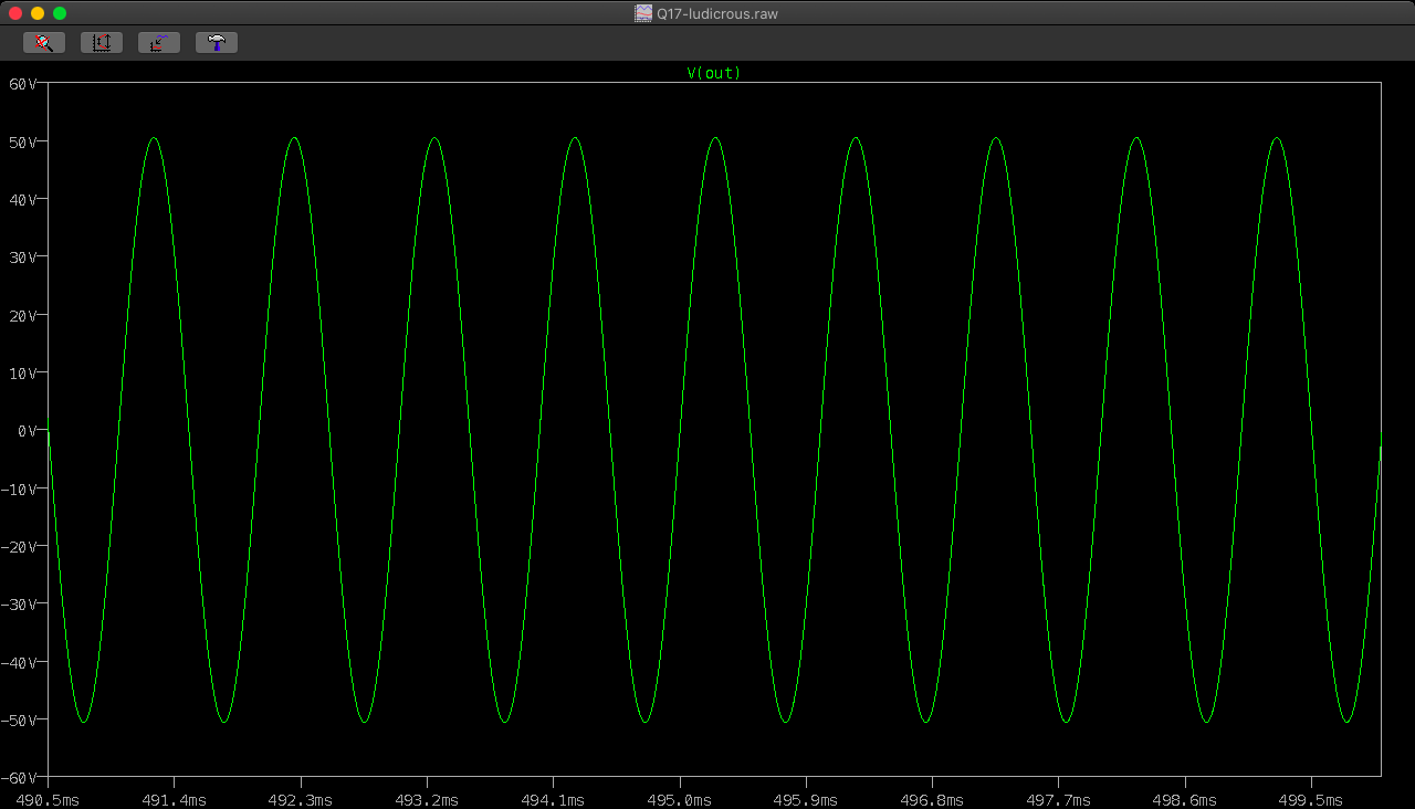

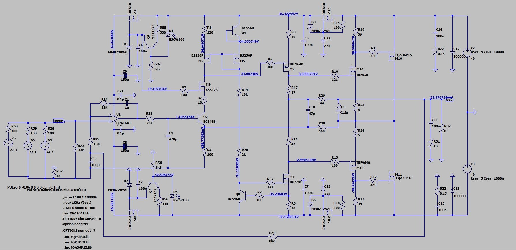

this is a very interesting approach that you are using in your high power amplifier. I have simulated this for critical issues and it behaves more stable than the Q17. Here I compare the Q17 with the new variant with only one pair of power stages. What I still don't understand is why the amplifier needs +- 70V, the simulation stops at a lower voltage.
I overlooked it, of course it works fine with lower voltage when R25 is adjusted.
Regards Tim

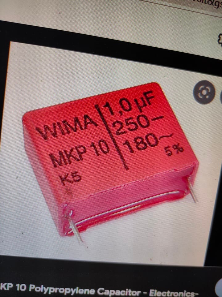

Hello Andrew,Hello Tibi
greetings i am wanting to make this amplifier input 1uf cap i am not sure if i can use this cap.
warm regards
Andrew
the MKP10 from Wima is a good capacitor for current smoothing. This capacitor is suitable as C7, if a FKP capacitor is installed in parallel. I find the combination of the MKP10 and a 100nF FKP1 a good economical solution.
Regards Tim
