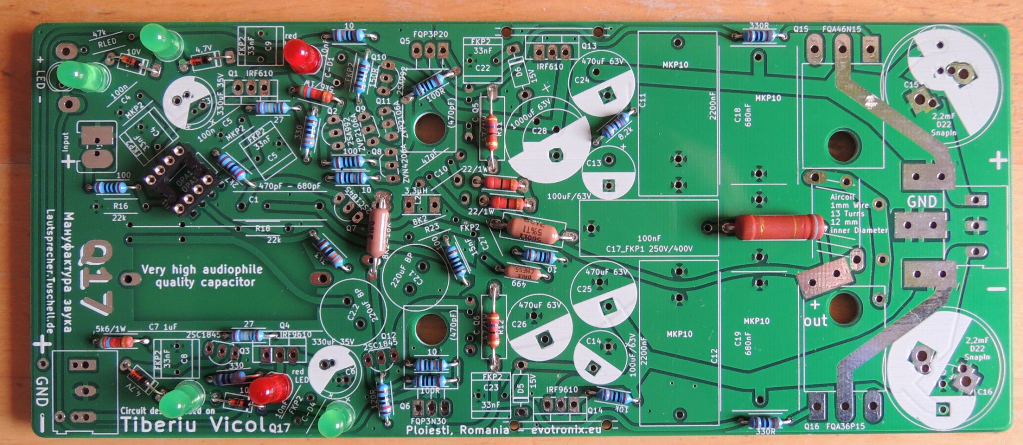

A two pair pcb, including gerbers, is available to download from the very first post of this thread.
I'm currently using a two pair Q17 on a previous version of the pcb, so the one I have posted have some things improved.
To achieve higher power, you need higher power supply voltage. The limiting factor are output Fairchild devices that can be run at max Vds=150V. This translate in a absolute maximum +/-75Vdc power supply which I do not recommend.
To be on the safe side, +/-65V would be my recommendation.
At +/-65V maximum theoretical output power would be around 250W/8ohm. In practice this will be ~200W/8ohm.
This power can be achieved with only one pair of Fairchild as well. These transistors have enough transconductance to push high current in low impedance loads.
Having two pair will allow to drive even lower impedance speakers, like ESL, or almost any high-end speaker.

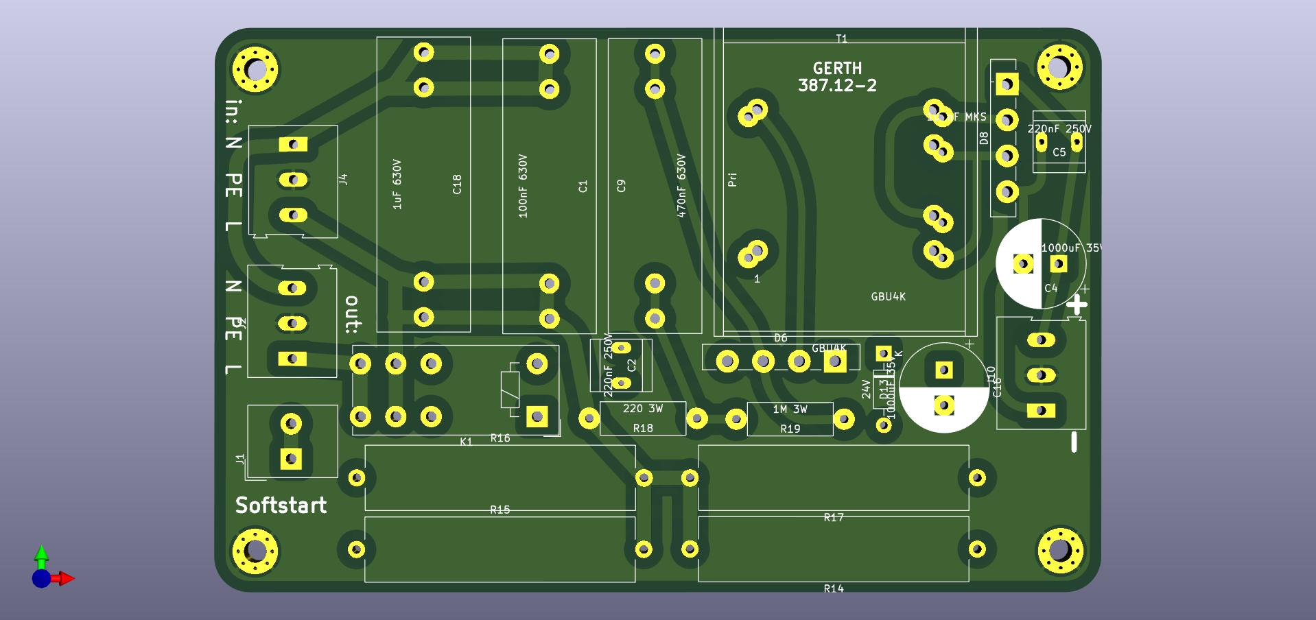

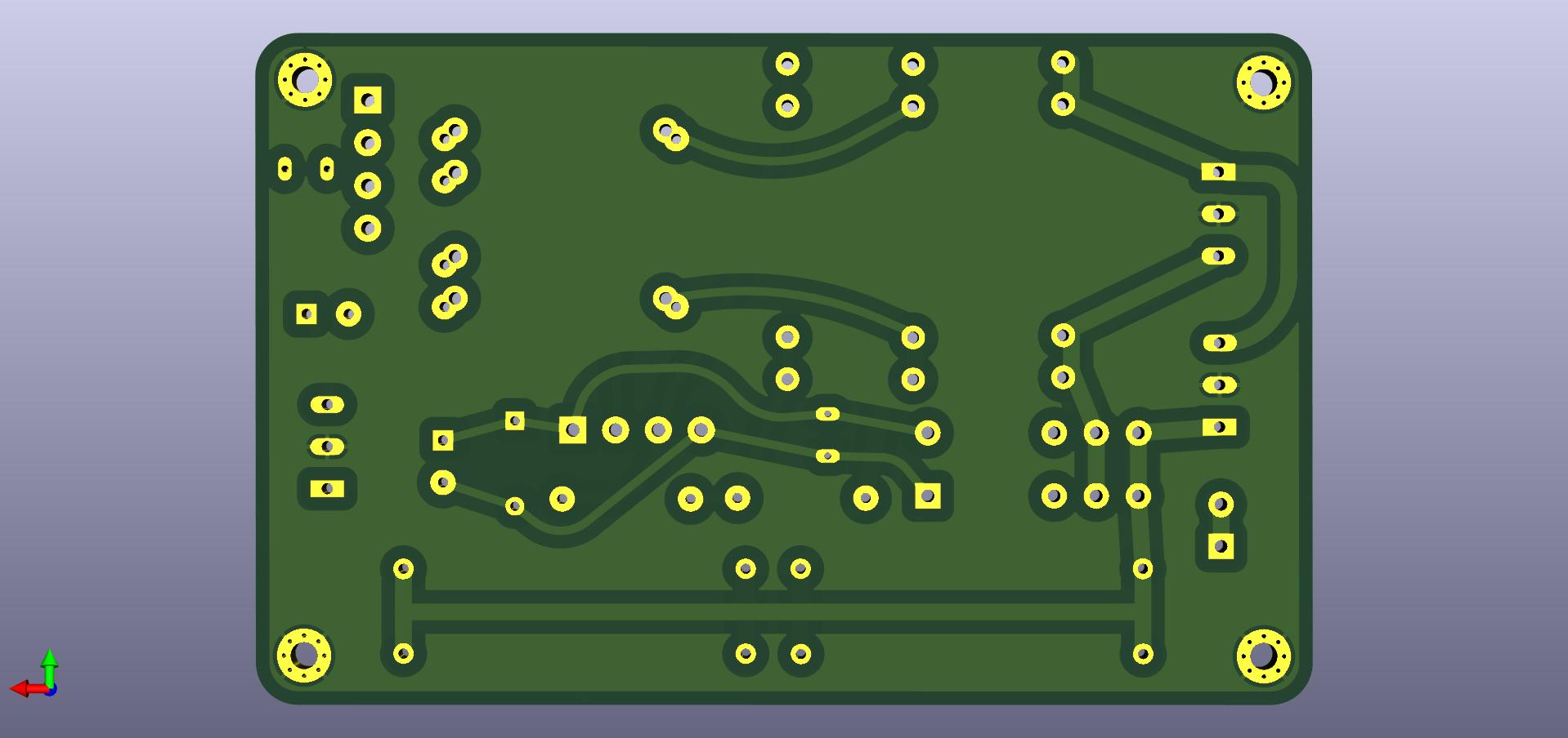

Hello Ed,
I found a softstart and a speaker protection circuit here in the forum, which I also laid out as a PCB a few months ago and uploaded here. Since I always have space problems in my cases, I have these circuits now also individually.
I'll upload you the Gerber for the soft start here, that's quite useful and has often benefited me in my experiments that only the fuse blew but the rest stayed intact.
There is still room on the PCB for a transformer Gerth 3,6 or 4,8VA, as well as rectifier and current smoothing, for example for a radio potentiometer for volume control.
Regards Tim

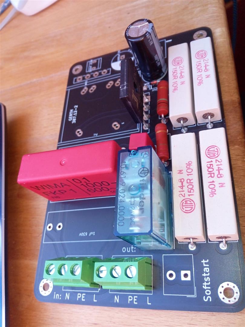

The assembly is not quite ideally labeled, for me it is sufficient.
Here is another picture, on it 470uF MKP4/630V are missing.
The relay is pretty standard, here is the finder: 40.61.9.024.0000.
The rectifier is also quite cheap: GBU4K

Thank you, Manniraj/Tim for your solutions! I am busy finding out what the simplist working way will be. I am busy now with both big resisters and ntc's with a two position switch, so I can cancel the influence of resistors etc. after being switched on.
Let you know if it is succesful,
regards, Ed.
