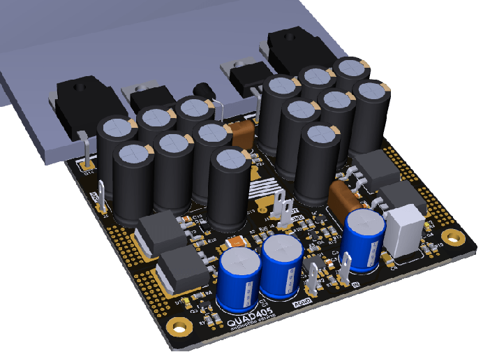

Hi Tibi,
Just to confirm that the Q17 modules that you hope to provide the community will NOT fit into an existing 405 chassis.
David
David
Hi David,
Q17 modules that I may offer in this GB will not fit existing 405's.
I have designed such modules, that fit perfectly in existing 405 chassis, but this was designed in Altium and can not be made open-source.
If there is enough interest I'll put in production such modules.
Enough interest mean over 100 ready mounted boards.
Tibi

I have added column G to group buy list with the option for a blanc smd PCB.
This was designed as a direct replacement for existing QUAD405.
Tibi

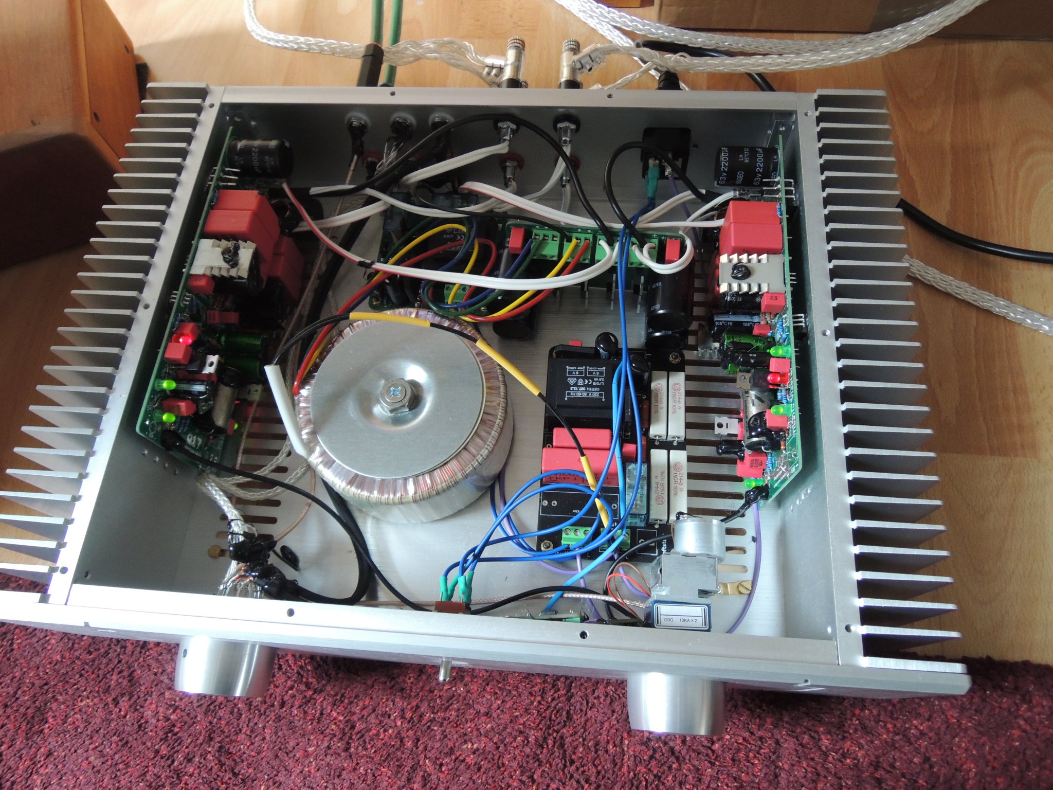

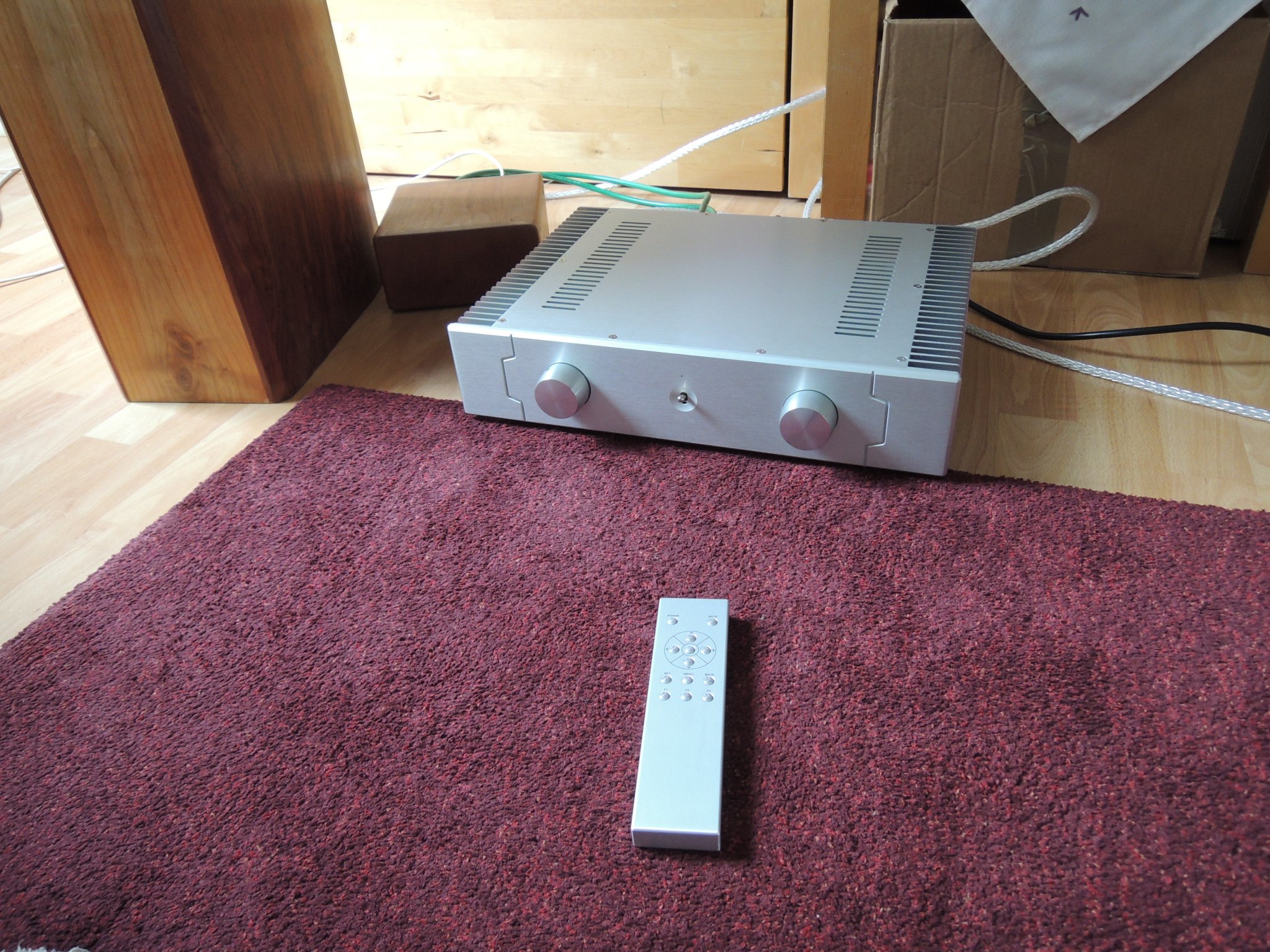

Hello everyone,
After many weeks, I have now finished my latest version of the Q17.
What can I say, it was really worth it. The enclosure is very ideal for the amplifier, even though it has far too large cooling fins.
The transformer turned out small, only 200W, the big ones were sold out. It supplies 2x 30V ~.
What I find impressive is the precision of the amplifier, 38.5mV offset is set on both channels. Sonically it is also ultra accurate, exceptionally natural and with an unshakable quietness.
It is once again a difference from the first Q17.
Regards Tim
Regards Tim

@Tim1999de
I see some progress here !
Great work ! 👍
Tibi
