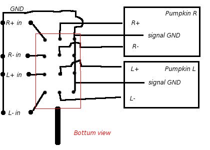

This is how i do it... correct ?
Jesper.

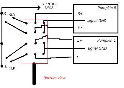

quote from ZenMod:
dunno for your pcb - but for mine correct way is like this
Thank's for the correction on my attenuator schm.
Well i tried to hook it up, the way you suggested, and some hum dissapeared.
look at zenmod's attennuator schm. here
I made a 'star' connection in middle of chassis (not connected to that) from that 'star' connection wires are going into these point's.
1 wire ---> pwr gnd Right channel
2 wire ---> pwr gnd Left channel
3 wire ---> signal gnd Right channel
4 wire ---> signal gnd Left channel
5 wire ---> comming from input gnd
The god thing is, that now my 4deck work's as good as my 2deck-stereo pot. 🙂
But still having that strange -in to GND problem... If i deattach the -in wire comming from attenuator, the :Pumpkin: is dead-quiet! ... But when -in is attached to attennuator there is comming some humming... really annoying. Donno what the problem is. Seem's to me, that it's some grounding issue...
Because when -in is connected to gnd via attennuator the :Pumpkin: is becoming very sensitive.. e.g when i touch some part's you can hear it. All that dissapears when disconnecting -in... something i didn't noticed before. I must say, that i didn't try it on my F4's this testing is done with my LeachAmp, there is ofcause the possibillity that there is no humming when connected to F4... but i sure would like to solve that problem anyway.
Jesper.
