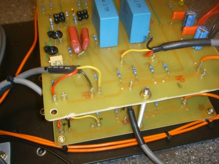

Today i tried to cut some unused gnd (black wire's) connection, and this way i got rid of the visible hum, seen on my CRO!
Humm stil happens though, now it just can't be seen anymore 😉
I attached a picture of my initial setup.
Middle just below blue output cap's you can see the cutout black gnd.
It's very hard to explain how i attach everything on picture's.
But i will try anyway:
The 2 orange wire on right picture is pwr-gnd goes to 'star' gnd.
Going from right to left on picture, red wire is +out which goes to +out(rca for now) Yellow goes to -out (attached on gnd rca connection at end of cable) RCA connectors gnd goes to 'star' gnd.
Left picture the input connection's are located. yellow = -in , black=sgnd , red=+in
All 3 goes to 4deck attennuator.
On input rca, the gnd goes to 'star' gnd.
Yellow is attached to gnd too, at my testsetup.
Don't think my description could be usefull though...

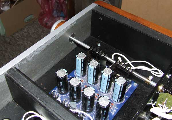

mpmarino said:
I'm really disappointed with the way the knobs feel - too wobbly. They are large solid alu and don't feel right hanging off of a junkyard motorized pot and input selector. I'm building a bearing carriage with stainless shafts for the assembly to eliminate play and make 'er bullet proof..
put selector and pot on back of uckin' fugly case, and make extending shafts from front plate to back;
you can drill bigger holes in front plate and put bearings as shaft guides ...... if ya're nutzzzzzzzzz ....... look at Igor's preamp thread ;
or - be smart

Naahh! Already been done.
I'm using two bearings per 'axle' with thrust washers to eliminate all play
Relay set-ups for atten and select so no shafts thru da case allowed or needed..
.....gotta come up with a clutch for the atten motor. I'm still 'junkin' for parts for the boards, so no time lost 😉
edit: What is messing (well, in a preamp!)

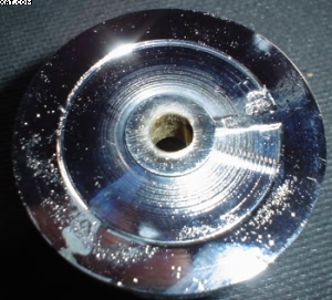

mpmarino said:the knobs feel - too wobbly.
Making them hollow is my preference, i enjoy big knobs (read as you please)
Shrinking a hollow body on a solid base is easy, machine the inside edge of the knob body and there's no seam in sight.
