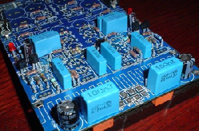

mpmarino said:
the junkyard game
Mark,
if you take a good look you'll see at least three different resistor types on the piccy, the bulk being 2% and 5 % accurate 50ppm 0.6W Philies.(red and gold band)
Which means very little because i handpick and check each component, each R on the board is 0.1% accurate.
I've got at least 10K of the 2% red variety (forgot the exact number), bought the entire lot for $70, a few hundred of each value on a tape.
The Dales i've got at least 5K of, 1987 production series.
The smaller blue caps are 0.68uF Siemens decent quality polyester types, couldn't fit large enough polyprops there and mkp isn't exactly required at those locations.
The big blue MKP types on top are RiFa430s on the output, Siemens KP where the Rifas wouldn't fit.
On the bottom side of the board are high value 1% polystyrene caps, the very best ever made. Previously only used for RIAA purposes because they were filthy expensive.
