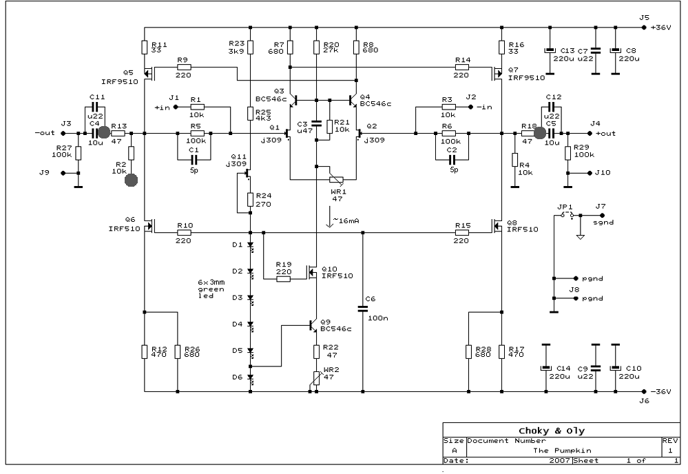

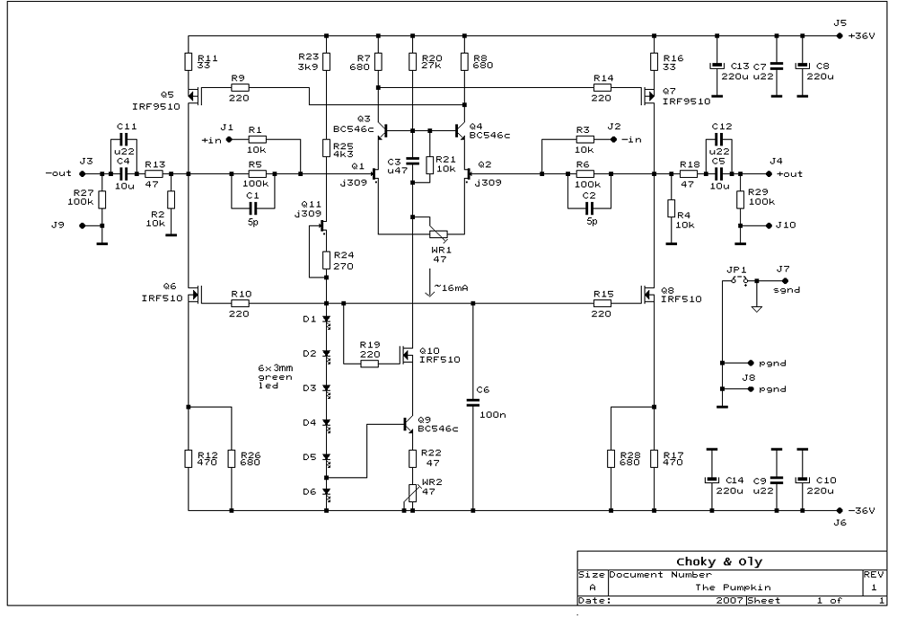

well ...... seems ages ago ,buried in some obscure DiyA Pass thread , after few quickie (on back of napkin) modifications of XYWZwhatever BOSOZ , my budy Lucky Luke (AKA steen) , demanded one little preamp with balls ....
few posts later , LL have some ideas about topology, perfectly good for me , just because I'm good at paper (napkin) and hand calc almost as he is good in making amps ........
little later - I already have some quickie quickie drawn , but somewhat flipped in regard to LL's idea,with added output stage(s) etc.
main reason why I flipped it is because I feel ( well - I rarely think,anyway) that's smart to use some non-audio-fancy-schmanzy Jfet , which is easy to find in near tobacco store, with all other parts .....
well - result is here (lookie lookie schmtc)
crazy process of :Pumpkin: delivery is also crazy documented in THIS
thread .........
I can just say tnx to entire OFF TOPIC MOB , just because they make my life miserable with regular questions "will it drive F4 " etc . :devilr:
anyway ......... for first post is 'nuff
schematic:

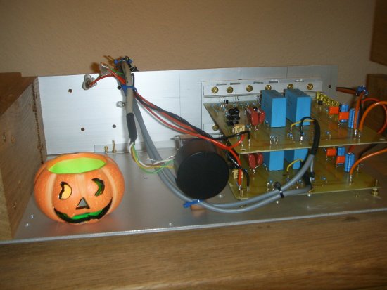

:Pumpkin: setup in my livingroom... Swinging so easily 40v with 1,8 on input !!!
Thank's for all the help ZenMod... Maybee it will be a while before finishing it up...
I made a :Pumpkin: from scratch, designing my pcb (clumsy i know) myself... but the thing is playing really nice, not to mention very relaxing too. All diy'ers, which life depend's on the F4, really should consider the :Pumpkin: to drive it wild an mad...
ZenMod :devilr: :devilr: :devilr: nice weekend...
Jesper.
crazy danske was fast almost as his country man LL :clown:
lykkedk earned his right to post piccies of his own :Pumpkin: because he is first who actually made non-prototype version ..........

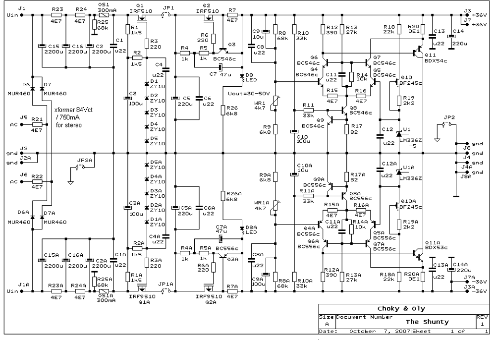

well- steen ordered :Pumpkin:, but he didn't count on my everlasting love for shunt regs .
as result of that love there is The Shunty ........ simply - proper reg for any eeny weeny preamp ........
my friend Oly (AKA Vangelis on DiyA) is responsible for stunning pcbs for both :Pumpkin: and Shunty ; btw. "The Shunty" is his name for that simple reg . you'll see pcb piccies in later posts.
he is also responsible for keeping me in sane boundaries ; well - almost keeping me 😉
when I drew series reg, in front of already drawn and tested shunt part of now existing Shunty, his only (and last ) comment was "that's pure demonstration of force....... why you need that ?" :clown:
I also wanna say many tnx to Off Topic Mob , which constantly make my life miserable with repetitive questions as "will it drive F4?" etc .......... :devilr:
anyway - this was (is) open source project ......... my intention to make decent preamp for regular DiyA members, without braking leg and arm to find obscuremadeofpreputium audio parts (read - toshiba 3 or 7 legged fuses) ...
both schematics are here ; I intend to sell pcbs along with matched crucial parts , in several levels ........ just main boards with parts, just Shunty with few important parts (if they exist at all) , complete package, main boards with just one Shunty ( if you are bean counter) etc.
to cut a story..........
here is The Shunty schematic:

ZenMod, when you tell to place voltmeter, at outerpin of C4 / C5, you mean at the point, where R13 meets C4(-out) , and where R18 meets C5 (+out) right ? - seem's a little hard to understand 100% (at least for me 😉). Well my pumpkin have been playing for several week now., but i will recheck the adjustment's when i somehow in future get chance to put it in box 🙂
C4 / C5 is the 10uF outputcap's you're meaning in the assembly-instruction's right ???
Jesper.

let me see ........
C4 and C5 from Pumpkin schematics ;
outer pins - physically outer on pcb , far left and far right side ......
I'm clearer now?
Yes Yes 😀 I know, i thought it over today, and see what you mean, regarding the placement of the output cap's...
I have attached a schematic, with 3 grey spots on, pointing on the meassuring point's, are they located the right places on schm. ???
Jesper.
