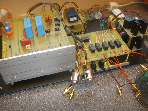

Official making thread... I allway's like looking at picture's, so here is one more from me.
I am making final assembling of complete
. On picture both my newly 'designed' 😀 inputselector + toslink-switch (To switch between 2 digital sources) is to be seen. Right at picture is a dual +5vdc PSU (1 for toslink thing's, and the other for turning relay's on/off)
My inputselector is made completly foolproof (NO COMMENT HERE PLEASE 😀 😀). One(Me) can switch between 3 RCA input's (sry. ZenMod for not making it complete balanced), and 1 balanced input.
The 3 RCA (unbalanced) input's, also closes the -in connection, on both sides of 4deck alps pot. When balanced in is choosen, the -in connection opens up for that signal too. This is controlled by a normal 4positions rotary selector.
Normally i will use balanced out, but also here i made a switch, which are going to be placed on back of
to switch between balanced/unbalanced out.
Just diden't tried it yet... maybee tomorrow ... but have to go now ...
Jesper.

lykkedk said:Please stop all that O.T. guys... hehe 😀 let's get back into battle ...
Anyway, this might be a dumb quistion, but i just got a thought about shortning -out, when not in use, is it ok to short -out to gnd ? or should it just be left 'open' ???
Please bare with me!
Jesper.

Thank's man... Actually i just tried it.
If i feed
JUST don't understand why ??? but nevermind... it work's fine.
I make this unbal/bal selector, so that i got possibility to use with other amp's than my F4...
Jesper.

If i feedwith 2vac sine, then 30vac sine come's out unbalanced, with -out 'open'... with -out closed, it spitzz out 45vac sine... that's a big difference...
Jesper.
it's easy to understand - you always need two points to establish any voltage difference ;
with one leg open , you have gnd somewhere, but not really where it need to be ;
when you ground one of outputs ( you know - you can choose which leg you'll ground
when you ground one of outputs ( you know - you can choose which leg you'll ground) you have established both points , needed for current flow......
be careful - usingwith F4 oriented gain setting - with other amps 😉

Hmmm... Actually i am having BIG problem driving my LeachAmp with
... I must say that i never tried it before i attached my inputselector... hmmm donno right if that's the problem ... will learn more next few day's i guess ... it's irritating but fun too 😉 ....
I attached my LeachAmp... and the inputselector/pumpkin is a GIANT disortion machine.... GREEEAT hummming reallly great! 🙂
I haven't yet tried the
with my dreky inputselector and my F4... btw.
Will tell, about problem in few day''s...

I am pretty sure, it dosent matter... but anyway i would choose to gnd the -out...
Jesper.
