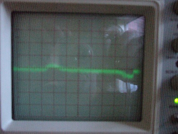

the real question, choky OLD chap....my F4 sings with my squeezebox and I can only get the volume up half way....this means that thinking about pumpkin is idling away the time for no good reason???
Ed
Ed
oh I do feel good playing OT with Mr OT himself.....apologies
1. yeah the buzz is with shorted and open inputs
2. buzz stops when switch is flicked off
3. can't measure any ac with dmm it only goes to 3 decimal places on 2v setting, i.e min reading is 1 mv.
4. spks are 96db average , which is why its probably annoying........
I'll get the scope out tomorrow and move stuff around.....seriously, I didnt mean to take your thread OT but thanks for sticking with me....
regards
Ed

how much caps you have in PSU filtering ?
are input RCAs isolated from chassis ?
have you PTC between safety and audio gnd?
is it 50 or 100 HZ buzzzzzzzz?
it's same in both channels?
is it same in one channel if you remove supply to other channel
etc
one by one ,please

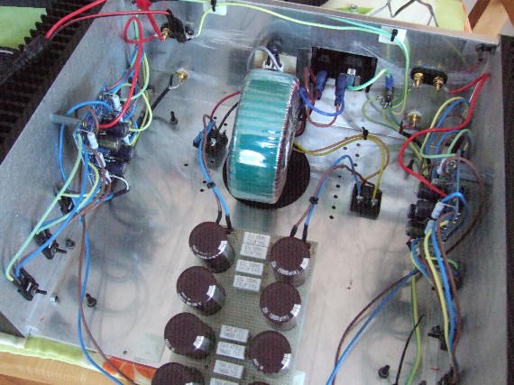

vitalstates said:Hi choky
sorted the F4 buzz, it was RF from the tranny, just the same problem I had with the F2. For info, the common factor is clairtronic transformers....
This cured it completely:
why on earth you place that drek ditto to input terminals and cables ?
turn it around - place it on blind front plate , place PSU pcb in middle of amp ;
find biggest tuna can , eat what's in it , and make lalalala shildie pot for crummy donut
patience mon brave, nothing is fitted in that pic, its all just resting in free space......I just took the pic to show the orientation that works.....
btw we don't have tuna tins that large(well maybe we do but I havn't seen one)...but I'm going to mount the tranny on a bracket in roughly the same place it is shown and turn the ps board round 90 degrees where is has more room.........its not artistic, but hey it works
this is what it looks like when lying flat on the floor in the middle
vitalstates said:patience mon brave, nothing is fitted in that pic, its all just resting in free space......I just took the pic to show the orientation that works.....
well - since all is sorta dismantled now - try it as I said ;
there is less harm in routing 220 line all the way to front plate , than keeping lousy xformer near sensitive lines
