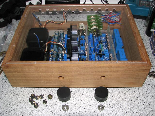

Here is a temporaray pic of my Pumpie. The plexi-lid is really a nerve-wrecking piece of work!! Other than that, it goes as planned;)
Ballbearings in front are for extension rods. The rubber washers are for decoupling of the transformers!! Minor details, but important.

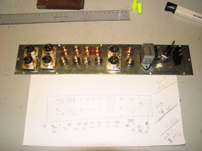

As you can see on the previous pic, there are vent holes at the rear. I have made similar holes in the bottom plate (alu) But at the front! The plan is ; when the inner get hot, the convection will start going, pulling air out of the entire cabinet. Any ideas that you think could better my approach, is welcome! Here is a pic of the rearplate, it will get fairly packed....
BTW the earplugs are for when the Pumpkie starts singing:clown:
