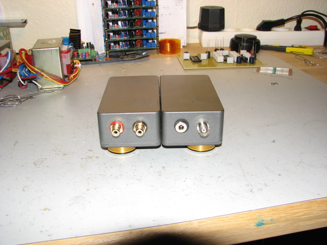

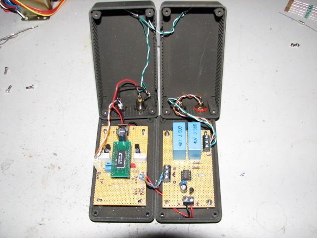

I hooked up the simplest imaginable DAC to my Pumpkin/AX setup. Just for fun and out of curiousity. (And ofcourse for liking a solder job!) How small and simple does it get? I dont know, but a DAC of 125X125mm is pretty small I guess! (5"X5") Here is pic of the front, its a TDA1543 DAC.

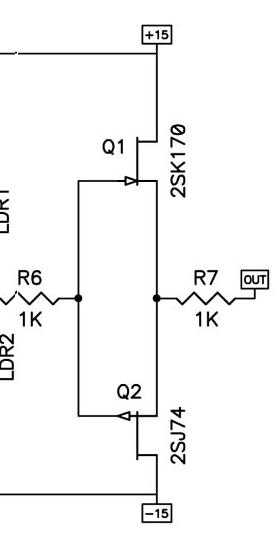

"buffer for Blues" or Borbely buffer ( two N Jfets in toob fashion 😉 )

Steen - I just tried for you that version ( if I'm not wrong - PD's ?) of simple 1543 DAC , feeding 22K input impedance of next stage ;
there is not enough dynamics ; sound is -sorta interesting (different than SSDac with xformers , certainly ) but just with occasional glimpse of life in it ; details are almost there , but everything is somehow flat ;
you'll always know that impedance mismatch is in case , if you have wakoo response of volume control ....... turning it up almost without normal response , and then suddenly you have enough volume ;
purely subjective described ...... 😉

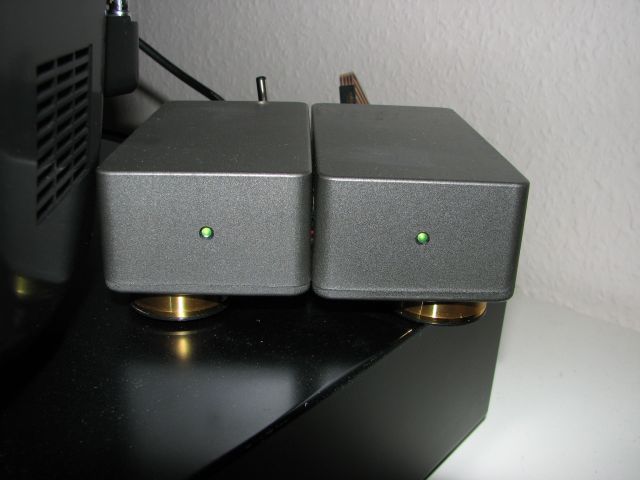

jacco vermeulen said:
Very nice, what is it ?
A pair of Pumpkin and Shunty! 😀 😀 😀
The heatsink on the Pumpkin is an old cheapie NOS that I found in the cabinet. It was bought long time ago for less than US$2. I saw and adapt it for use on the Pumpkin. Now it measures the full width of the PCB and is 50mm high, 15mm deep and has a base plate of 5mm thick, fixed with stainless steel bolt and isolated from ground plane with teflon washers.
The heatsink for the pre-regulator of the Shunty is also an old cheapie NOS that I bought for less than US$1.0. It protrudes a couple of mm beyond the PCB. The CCS and the shunt Darlington transistors are installed on 2 RISC CPU heatsinks that measures 51mm x 54mm and 16mm deep that have base plates of 5mm. The 2 heatsinks are bolted together using 25mm Al flat bar. These CPU heatsinks are provided with fans but have been taken out and thrown away! They cost about US$2.50 a piece in the junkyard here.

I have tested the pair at an ambient temperature of about 29 degree Celsius, still air. Everything goes fine and the heatsinks on the Shunty are warm to the touch only. That one on the Pumpkin is hotter but still don't burn my fingers.
Don't have thermal couple for my Fluke 189 for temperature measurement but may buy one some day. Will let you know the ¢XC/W then.

pooftaaaahhhhh , puffer , stossdampfer
I dunno exact number or name of the pdf - go to Borbely's and look for "new Jfet frontiers"
naaaah ......... just download all pdfs , and you'll find mucho dobrih stvari
on the other thought - look for "Borbely " and "Papa" on these DVDs I sent you .

The perpective of Papas Buffer-paper is a good news for me.
