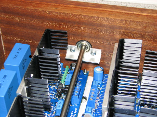

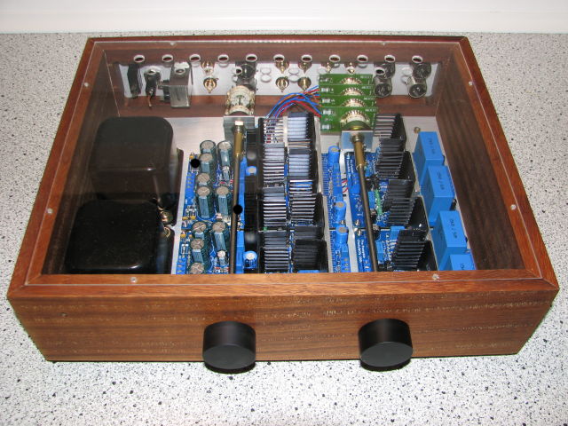

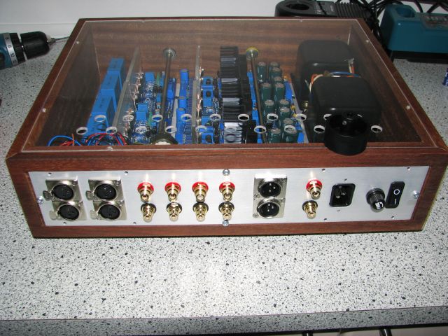

Not quite finished yet, but all the mechanical stuff and supports are done.
Here is a pic of the current state. Simple does it, I am striving for a very clean look, now that the lid is see-through😉 The faceplate has 2 black knobs and one green (! not blue, for a change) LED.

I hope that with the ballbearings and all that, it will "Pass" on to my son ( Well,one of them😉 ) In perfect working condition....🙂

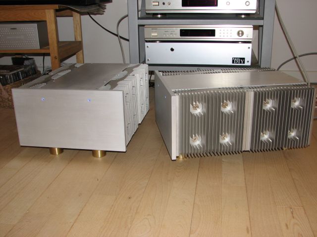

Yep the "finger" heatsinks does look like they belong, now that I have mounted 12 of them. If it works out temp. wise, I might keep them. It was a heck a work to install them ....
My Aleph-X monoblock's are another category 2 build🙂 Take a look😎
The A-X's really do like the Pumpkin, I think that the voltage gain in the A-X's is pretty low??

BTW: The pumpkins are soldered, working on the shuntys.
