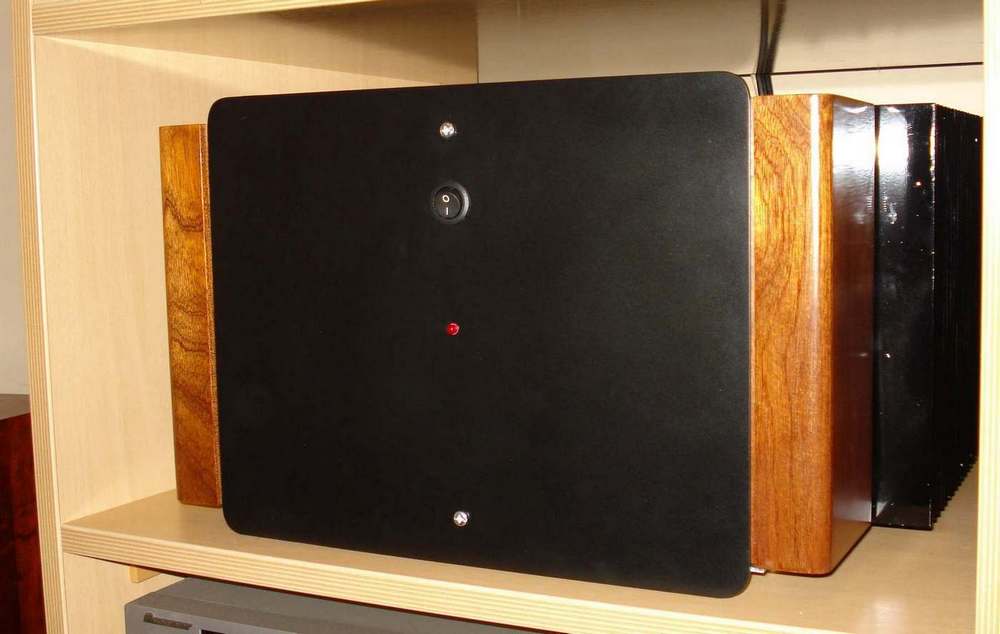

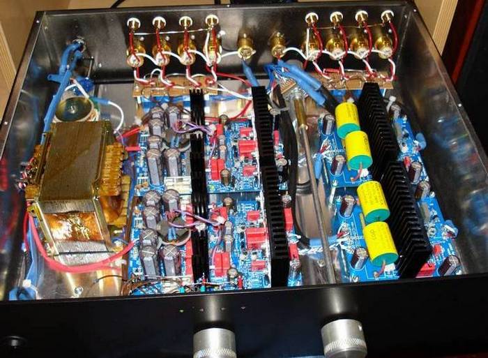

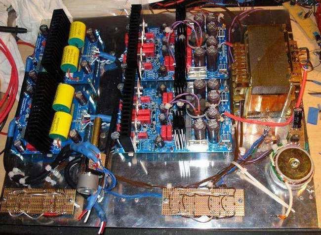

spavleski said:
Workie, workie![]()
Me too😀 The pumpkin is getting a new home and bigger heatsinks , the case is with "see through lid"! Who could resist with all them green led's in there? Not me....
Pumpkin volume control
So Mr. Steen, do I see potentiometers in place of the Twisted Pear stepped volume control and input-output boards?
Would you care to elaborate on the changes and effects on sound, if any? I would like to benefit from your experience and reasons for the changes. . .
Thanks!
Steve Z
Thanks!
Steve Z

Steenoe's Pumpkin revised
Looking closer I see he had done away with input and output connectors too. Very nice trick -- two less connectors in the signal path. In fact, there are no connectors or controls anywhere on the new box! 😀
Steve Z
Steve Z
