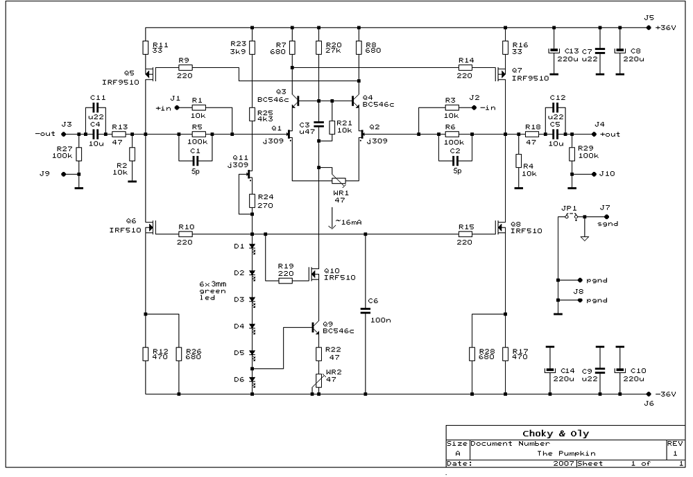

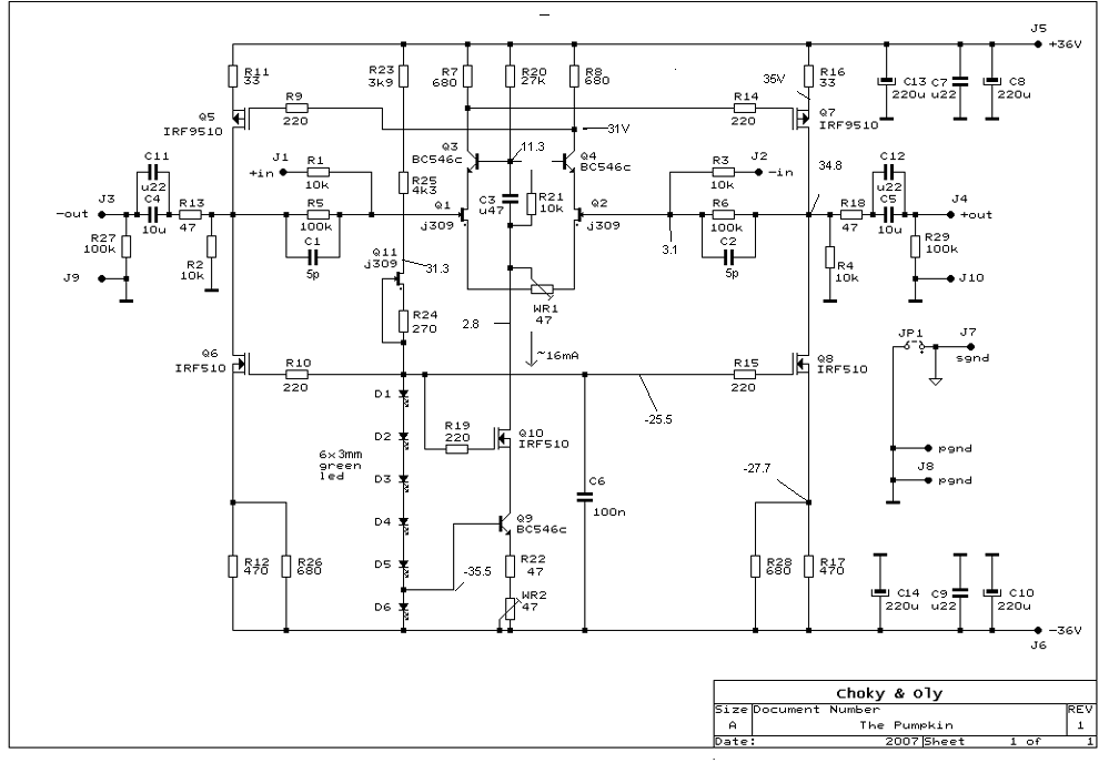

nono
open that schmtc with paint , or whatever - and give us few measured values , drawn on same schmtc
if you have no pmpy schm for that - here it is:
edit:
which exactly 2SK170 you use - BL or V suffix?
jazz said:Hi
as ordered schematic with voltage measurements.
grtz
Joris
edit: sk170 GR (sorry junkbox)
in that case - R7 and R8 increase to 1k3
goal is to have no more than 3 to 3,5mA through each GR 2SKs
you have problem with led string - which needs 5mA for proper operation
if you can't set R24 for needed 5mA through R23,R25,Q11,R24,led string chain......... than use plain bjt critter instead of Q11 - C up,B down , 130- 140 ohms as R24 - between E and B ; that way you must have ~ 5mA through biasing chain
regarding 3mA through each side of LTP .......... increase R22 to 140~150 E
jazz said:Hi Zen Mod,
Thanks for the advice. Ok gr version takes to much conversion, wanna stay close to your circuit.
For now I'll just double fets, with extra 1-10R in source should provide current sharing and hence compliance with 7 ma per halve of LTP right? Is just to get to grips with the circuit and setting procedures. I'll figure out how to get ccs in led bias string to behave.
I'll see if i can order j309 somehow. local shops say they don't know them, but farnell has em.
thanks
Joris
ps ccs in bias string is using 10x trimmer for r24, i figured the changes would require something like that.

jazz said:Hi, just fiy...
Up and running, nice and promising. Change back to 309 gave some offsett so a little matching left to do.
Now to put it in to a nice box and it seems i've got a new gadget. Thanks for the circuit and support.
cheers,
Joris😀
