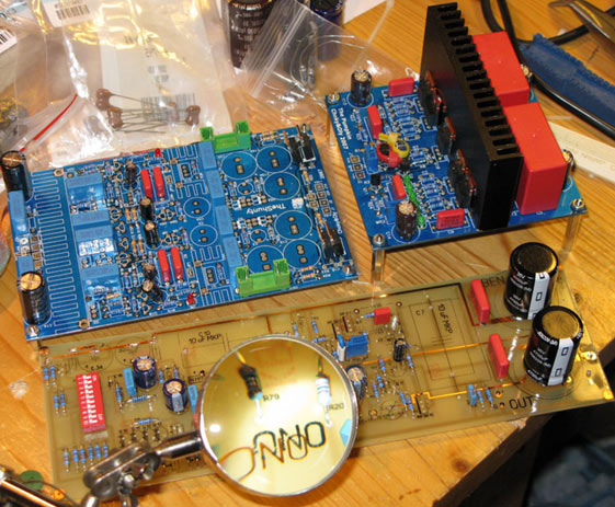

As marino posted these lines, at the very same time, I was asking our Master Zen :
Originally posted elsewhere by Manu
... while waiting for some caps for pumpkin, I decided to finish my ONO, I began 5 years ago... May be they will Kuscheln in same case, who knows...
BTW : Would be Shunty a good reg. for ONO ?
He replayed almost immediately :
Originally posted elsewhere by ZenMod
... it's completelly possible to feed it with Shunty , but be prepared to double dissipation - read - double heatsinking.......
maybe smartest thing is to relocate all mosfets and darlingtons to external heatsink ...
Isn't great?
Is it unity gain?
Manu

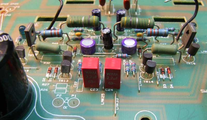

hershann said:Sorry to interrupt all the intelligent discussions - and adding noise to the nice signal all of you have been generating.
Doing some calculations:
So if corner freq, F = 1/(2 x pi x R x C)
(where R = R1 X R2 / R1+R2, and R1=shunt resistor of output and R2 = input impedance of F4)
And if I use 3.3uF for C4, C5.
R = 100k x 47k / (147k) = 31973
therefore F = 1.51Hz?
So give a factor of 10 where it starts to fall off the curve - so my calculations shows that it is good for 15Hz?
Correct?
her shann
