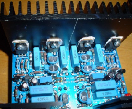

hershann said:
Anything needed to be changed on Shunty if I use a 36v-0-36v transformer? Found a 72VCT 50VA transformer that is much smaller than the 250VA 84VCT I found earlier - but I guess 50VA might be too anemic.
I do not need that much gain planning on 5 or 7 - so a lower max voltage swing does not matter.
Still looking for suggestions for good source of EI transformers - only sinker is that I am going to need 240V primary.
her shann
for Shunty:
change one of zenners (in D1 - D5 string) for 4V7 , so - you'll have ~ 40V after Q2
set (with WR1 ) output voltage to 30V
in case that you can go so low - increase R9 to 7K5
same procedure for negative side of Shunty
you'll be fine even with 50VA , just look is it too warm .......... in case that these 50VA aren't real ;)

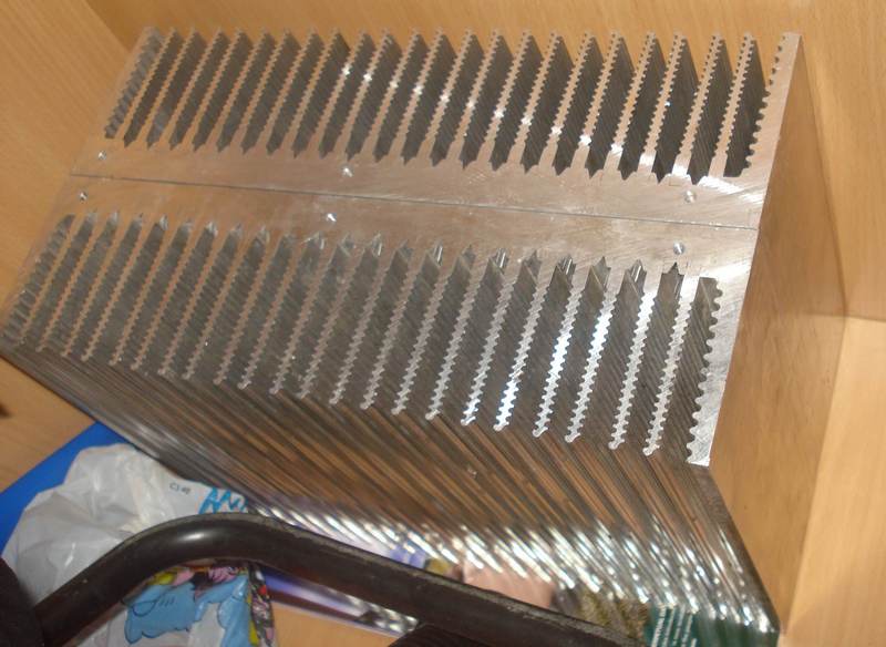

jacco vermeulen said:
Q : which commercial pre-amps have shunt regulation ?
Me think a heatsink above 3C/W for the Shuntee is a hot cat on a tin roof.
OK in open air, with a cover on top Iznogood for the lytics.
Maybe if Rovsing keeps them high enuff.
The heatsinks get really warm. A few ventilation holes in the pcb would help in that respect. Just in case my crazy man, ZM, is gonna do a second run of boards;) Raising the heatsinks to add a little airflow underneath will also help, ofcourse.
Running only 72VCT like me, helps too;)
Steen (with 2 dedicated preamps, specifically designed for him:D )
How cool does it get?
