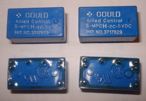

Relay 5V
Hi, I have a bunch of relays as shown on picture. There are 5V rated.
Aim is to use it as Input selector for balanced (Relay is 2X2 type).
What kind of rectifier would be good to be prepared for runing the relays? To use separate trafo, grez and 7805 I guess would be the best option...

Re: Relay 5V
Thanks Zen, Mod and Spavleski for answer about trafos.
Nice to have some engineers up there...
Yes it works very well (don't forget little caps accross relay coil and protection diode).
Although I have heard that switching behaviour should be better if you use sistors to control the relay. You can use for instance some transitor arrays (most have protection diodes).

Jacco : is there any parts-type or brand on this planet you don't know or never heard about?Nice, Allied C is an aviation gear brand

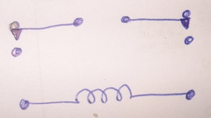

spavleski said:Schematic (Zen mode drawing...)...but Zen seems to be right...why bother with PCB. Zen what does exactly mean PSU floating.
that means that any end of relay PSU isn't connected to audio gnd ;
in engineering words - relay psu is isolated from audio psu
Re: ZM is spoking ...... (spikete spik)
OK - So, whole PSU made for relays not to be conected to any ground. Correct?Zen Mod said:
Re: Re: ZM is spoking ...... (spikete spik)
we'll solve that minor issues tomorrow via skipi or phone ....
anyway - point is that you must have either dedicated winding for that 5V psu , or dedicated small xformer ; when you make ordinary PSU of that ( written in my previous post) , you just not connect it anywhere in system , meaning on audio psu ; they are galvanic isolated or whatever ......... two completely independent circuits .
diode across each relay coil ( wired in anti-phase (orientation) A to + side of coil) is for peak suppression ......... ya remember what induction is ......... how eeeny weeeny ceiling bulb can be responsible for melting contacts on wall switch .......
when that psu is isolated - it's completely irrelevant which pole you choose sending to selector switch
spavleski said:OK - So, whole PSU made for relays not to be conected to any ground. Correct?
Manu said:Yes.
Simply that :
(Better switch 5V not GRd may be.)
