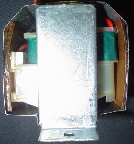

use that EI and place it in separate box ; 600VA donut is really overkill ....... even for Pumpkin
both transformers you show are probably too large ( physically and inducing hum wise) to be in same box with active electronic
Keeping the trafo in another box is not very high in the WAF - how effective is it to do a aluminum partition or an aluminum cyclinder to surround the trafo (using a tin can? ) - in terms of reducing noise? Or is it the fact that the trafo is bolted to the chassis that causes problems?
I don't mind having a larger single chassis and keeping the trafo as far away from the channel pcb as I can. But I guess if its no go - then I'll use one of those desktop computer power supply boxes to house the power circuit.
her shann
Manu said:My (humble) experience is that Al is not really (or really not) good in shielding trafos radiations.
Distance is far better, or some iron-sheet.
I had good experience with little piece of wood for méchanical decoupling from chassis.
Manu
Whatever material you choose for the shielding, keep in mind that it's a matter of thickness. Steel can offer the same shielding as aluminum, but require less wall thickness.
Anyhow, you need more than a tin can to make any significant shielding. I did some testing on the subject, for a 1000VA torodial trafo you need approx. 12mm steel to get the magnetic field under control adequately for placing it next to a sensitive circuit.
Magura
Copper don't hurt but is not so efficient against magnetic radiations. Actually only u-Metal is.
If magnetic strays is the problem. Distance cures it completely. Depending on how strong the radiations are (how big the trafo, but not only) a of course. So " ... both transformers you show are probably too large ( physically and inducing hum wise) to be in same box ..." (Zen Mod)
Manu

Manu said:Magura : you're right.
But :
Distance is for free
manu
Free.....and a lot lighter! The boxes I ended up making for shielding the before mentioned 1000VA trafos, are even heavier than the trafos themselves, tipping the scales around 12kg a piece for the shields.
Unfortunately distance is an opposite liniar function of WAF
Magura

hershann said:Don't see many 2 box solutions for commercial preamps.
You are wrong.
Placing the transformer in a separate small shabby case is very common, the ones which also have the rest of the PS in a separate box are un-common and only a handfull.

AR2 is right - in many commercial preamps man can find eeny weeny xformers , which radiating field is way weaker than of any xformer you (hershann) posted ........
on the other side - Pumpie with Shunty isn't everyday's preamp ...... just look at amount of energy it needs, without any additional fancy gadgets
Why are we so fastidious when preamp manufacturers seems to have no problems? Don't see many 2 box solutions for commercial preamps.
I think that a hi end preamp in 1 chassis has probably gone thru much R+D in this regard. The maker likely went through several layouts and several trafos before settling in on an arraignment.
I'd rather just stick it outside
