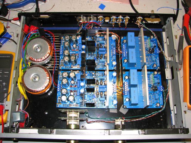

As Jacco point it out, because of my nice dagnall 2x50V tranny, it would be of advantage to have some volt loss before first reg in shunty (in order to avoid too much dissipation).
Which change concerning R21 to R24 would be fine/allowed for this purpose?

Manu said:As Jacco point it out, because of my nice dagnall 2x50V tranny, it would be of advantage to have some volt loss before first reg in shunty (in order to avoid too much dissipation).
naah......... just let them bleed ....... (AC - Welcome to my nightmare -greatest cabare album I heard ......... )
put bigger sinks , and be sure that first elkos have enough voltage

Manu said:
Yes, but have to find more suitable (sizewize).
Shunty will be my ruin. But worth it!!!

50x1,41=~70V
ya have 45 V after series reg, so - dissipation per each series mosfet is (70-45) x .15 = 3,75W .......... piece of cake for little one - I think that even with mentioned heatsinks, they will be fine .

steenoe said:
Manu, that heatsink is not a lot too big, the Pumpkin/Shunty does get pretty hot in use You better keep an eye on the temp of those heatsinks that cool Q1/Q1a also. Mine passed the 60 deg C. mark easily, with no lid on
(I am running 48 V AC under full load, 48-0-48, no load is 50V so the supply sacks 2 volts with the Pampkin connected)
Thanks a lot ,
oh yes, sure I ll keep an eye on temp.
Refering to what you say, I am afraid that just a sheet of Al (event if thick) will not suffice at this place. Although, we will see. As Tarzan used to say : probieren geht über studieren.
Manu
