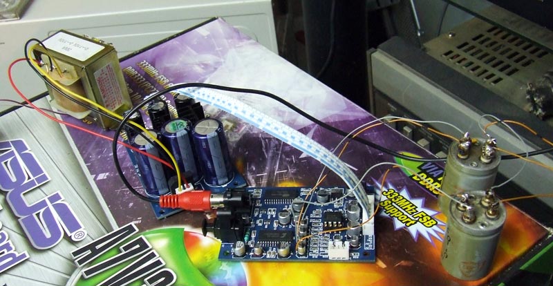

me thinks that they're olde americanino Lewyt xformers , which truly yours personally butchered from olde americanino WWII xmiter ..... on junkyard ......... where else ?
one xmitter - one xformer
3K6:18K
something like this - from machmat pagines :
3K6:18K
