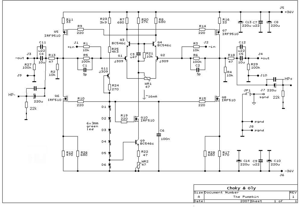

hershann said:
For the Pumpkin - assuming the max output cap of 10uF - I guess it will still not be adequate for a headphone with input impedance of 300ohm as the LP filter will still be loping off a huge chunk of the bass.
Thinking of using the balanced output to do double duty to drive a balanced headphone too. I guess the only for this is to add an electrolytic :xeye:
her shann
you can find decent electrolytics in range 100-220 uF, and you can bypass them with something nice , in range of 1-2u2 ;
just hang them ( electrolytics)on inner side of present output caps , solder 47K from output side of caps to gnd ( for bleeding those big caps ) , connect da cans and enjoy .
as I said - I tried my proto Pumpie with AKG K270 Studio ........ ;)
nota bene - do not forget to power off power amp, when you are in mood for headphones ........ :devily:

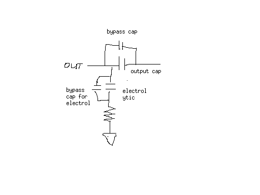

Pardon my poor comprehension - so you mean -ve leg of electrolytic to output of film cap and +ve leg of electrolytic to resistor which is then connected to ground. So the electrolytic is not actually parallel to the film cap at all.
Your drawing is not excactly correct! The Electrolytic cap must be in parallel with the outputcap. Said in another way; you can replace the outputcap, with the electrolytic (and add the resistor as Mr. ZM said)
Edit: And bypass the electrolytic with your faverourite filmcap ofcourse;) I beleive there is provided for that on the Shunty boards...
Edit Edit: I would use at least 220uF, and even that, I feel is too small. I usally go for 1000uF for headphone applications like that.
One good combo that I can recommend is 470uF Panasonic FC bypassed with a 1uF Rifa PHE426 polyprop. At least that is the best sounding "cheapo" combo that I have ever heard;) Using a smallish cap on the output of a Headphone amp does cut the lower octaves somewhat;)
In that case - it's just replacing the output cap or paralleling the output cap with an electrolytic then. Since there is already a R27/R29 (100k) shunting to ground, why is there a mention of having a 47k ohm resistor connected to ground? Is that to replace R27/R29?
Will the electrolytic cap degrade the sound somewhat when the pumpkin is used as a preamp then?

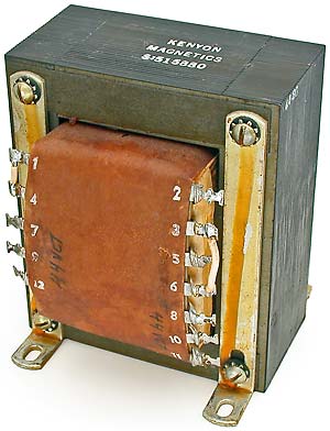

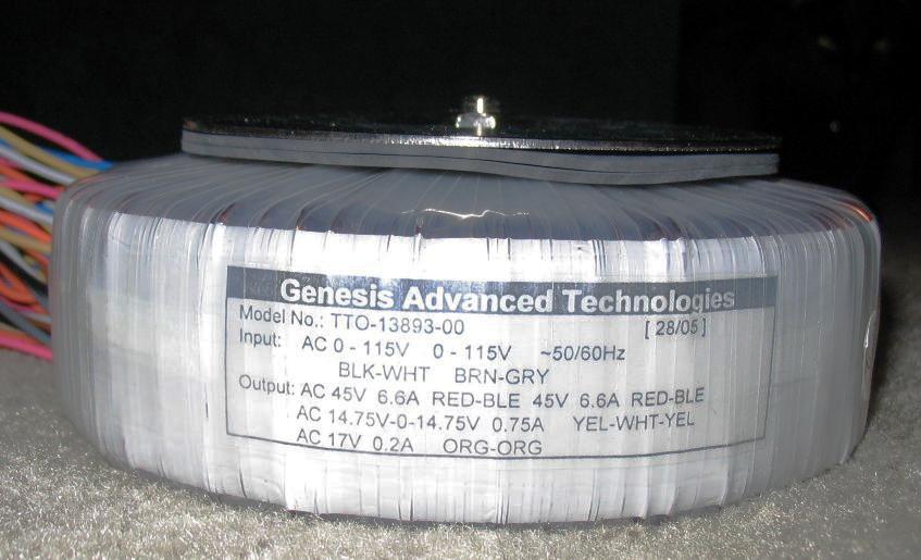

Cookbook says EI transformer is preferred - I supposed due to better noise characteristics and ability to withstand DC etc.
For my Pumpkin the transformer is going to be mounted near the front panel and the audio circuit right at the back (the pot probably actuated via an extension rod).
So should I go for the old EI transformer 250VA, 42VCT x2 (pic 1) or the toroidal transformer 600VA 90VCT (pic 2). They are similar in price - with the EI at $20 and toroidal at $29.5.
BTW how easy is it to shield the EI's stray magnetic field?
her shann
use that EI and place it in separate box ; 600VA donut is really overkill ....... even for Pumpkin :clown:
both transformers you show are probably too large ( physically and inducing hum wise) to be in same box with active electronic
