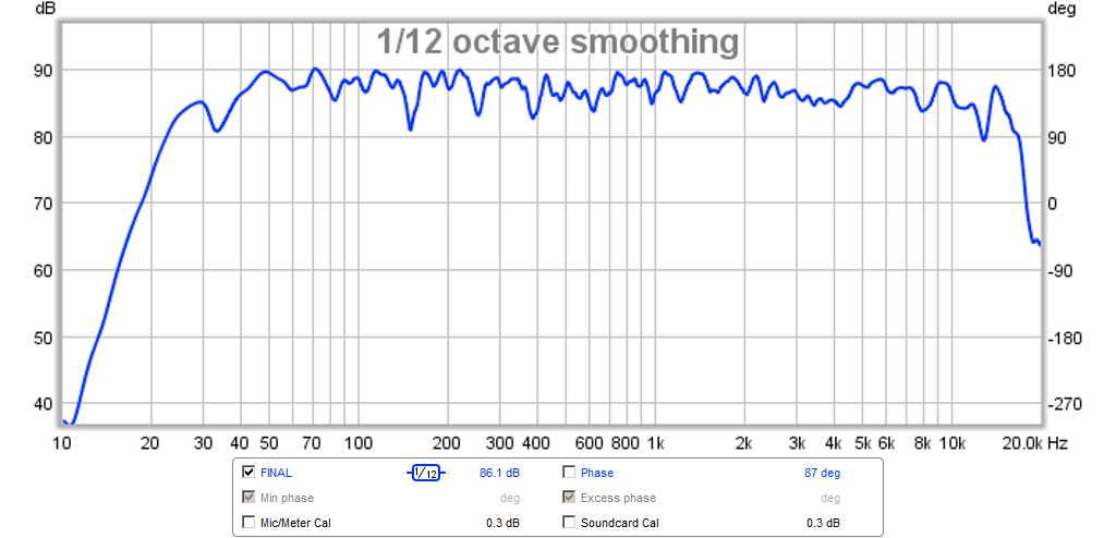

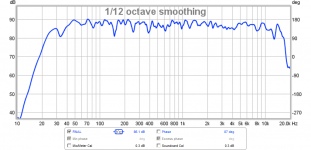

At the suggestion of a member on the multiway forum, I EQ'd flat the cone breakup peaks at 5kHz, 7kHz, and 9kHz (between -3dB and -5dB applied). As they seem to be pretty constant with directivity, it seemed to be a good thing to do. Also, the peaks are in the range above the critical 500Hz to 5kHz vocal range where all the phase and spatial coherence are important so I did not think the EQ would detract from the single point source impact. Here is a sound clip of the new EQ'd system. I think it sounds smoother and the transients appear more defined.
Here is the new measured freq response from listening position:
Let me know what you think...

Sounds nice from my synergy horns! Your setup and eq seems quite neutral.

Here's the freq response at the exact spot where the mic was on my couch.

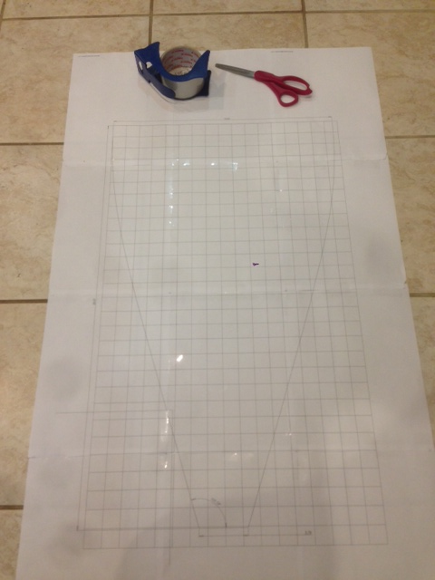

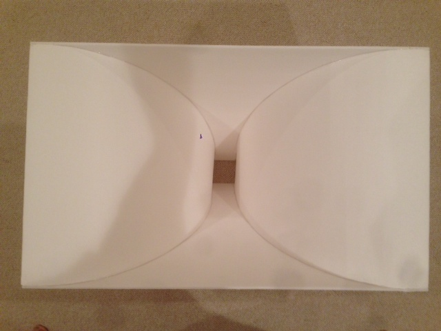

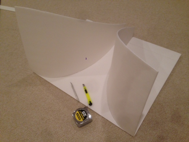

Tractrix horn build begins
To start things off, the 2d flat pattern for the 3d curved panel was generated using sheet metal un-roll function in SW. Then it was printed at full-scale using the Acrobat print to tile function. I then taped up the sheets to make the pattern shown. Next step will be to transfer the pattern to foam core using the punch many little holes through the pattern with a ballpoint pen.

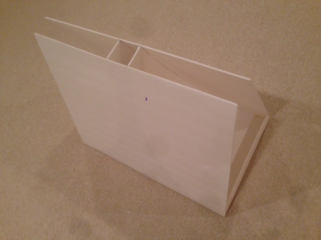

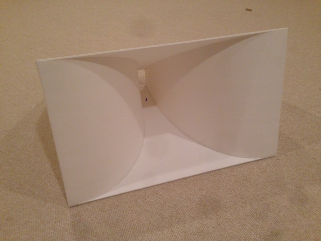

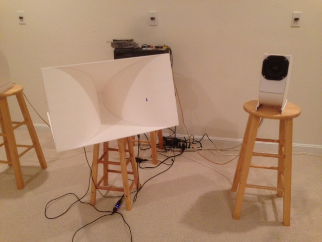

Tractrix horn build #2
Here is the almost completed tractrix horn made out of foam core. It measures 28 in wide x 17 in tall x 22 in deep. Once an accurate CAD-generated pattern is cut, the assembly went very quickly as it self-forms into the right shape once the throat and mouth edges are anchored. I still need to add the driver mounting flange, some bracing, and a rear chamber. It is larger than one would think once you hold it in your hands (see photo next to Nautaloss and stools for scale). Luckily it doesn't weigh anything. I held it up against the driver with my head in front of the mouth and it really amplifies the sound with no seal on the driver. Sounds good to my ears so far...

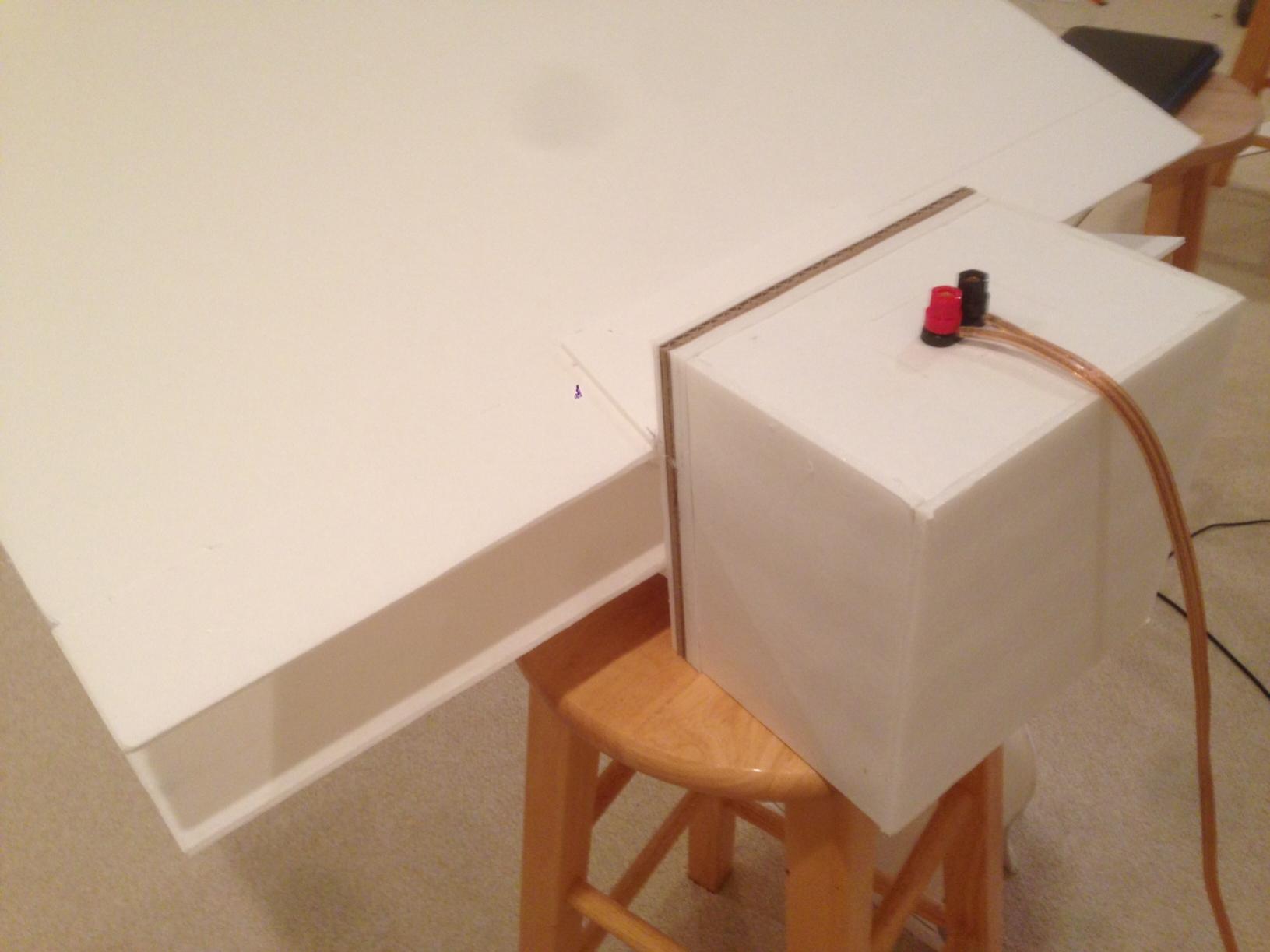

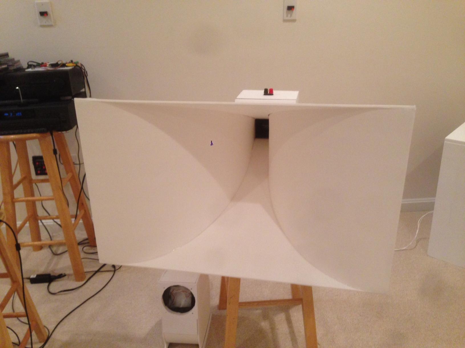

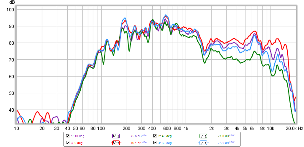

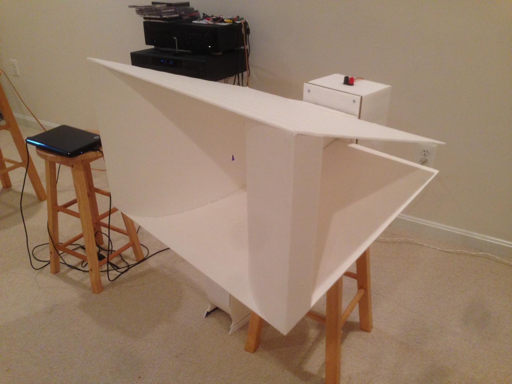

First Sound with Tractrix
I made a 5.25 liter rear chamber lined it with grey foam, added binding posts and quick disconnects. The driver mounts to the horn flange then the box covers the back of the driver and is screwed on tight.
Initial listening tests indicate that the panels vibrate a lot so I will have to add bracing later. However, the naysayers who said nothing more than 5kHz will get through, and they also said the polar directivity won't have anything off axis to speak of, they are, fortunately, all wrong. The tractrix as designed indeed lets HF's through and works off-axis. I get 15kHz on axis and it drops off with angle but clearly this is substantial HF getting out of the horn. Some rough polars (+/- 3 deg) show that the directivity is not bad. Up to +/- 30 deg is very respectable. I did not have time to remove the baffle step shelf EQ from the Nautaloss so this is certainly not optimized. I need to give it a rising response so that it will be flat, but this driver has lots of headroom so that should not be a problem. The 1.7kHz dip corresponds to 4in - probably the rear chamber reflection. Ideally a Nautaloss back chamber would be ideal.
Probably the baffle step shelf EQ not neutralized but looks like you got it nearly down to 100Hz if "EQing the 150Hz-1500Hz area down by 10dB", then in a home system it could be 2 way instead of 3 way. Though you written earlier that the 3 way'er is meant for very high SPL sytem and not for home use.
Thanks for kind words Byrtt. As soon as if have time to redo EQ we will see how this can work. I will probably add constrained layer damping on panels.
