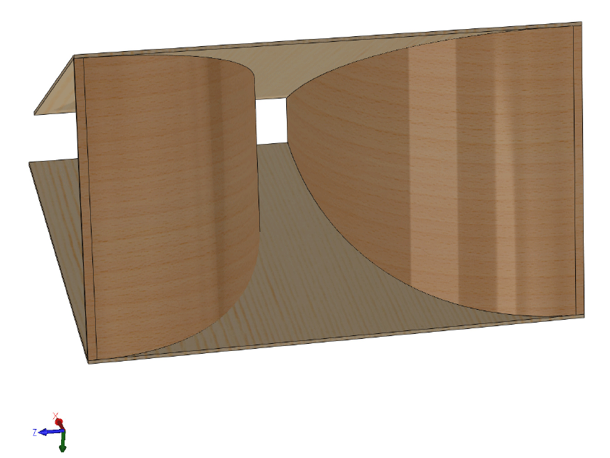

I am making some progress on the design and layout for the tractrix horn using Volvotreter's spreadsheet. This horn has a design frequency of 175Hz for a 7.1cm square throat. The predicted response was shown in post #39. Approximate dimensions are: 0.67m wide x 0.45 high x 0.54 m long. The design appears to provide about 109 dB sensitivity at 2.83v and 1m, and a 130 dB SPL at 1m and 37 volts when driven to xmax. Physically, the design looks like it could be a good candidate for some bass-injection ports a la Synergy. Maybe mount a pair of 12 in drivers top and bottom with slot ports along the corners and maybe get bass extension down to about 80Hz before handing off to a sub.

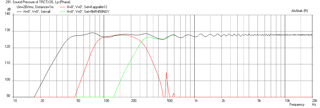

Predicted response modeled in Akabak with 16-segments:

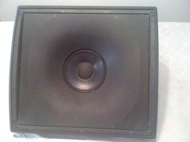

I'd be curious about the response in a horn with fabrication as proposed a few times no here by Tom Danley.
You know, extending the shape woofer cone with stretch fabric and then impregnate it with epoxy to shape it a bit like his coax synergy horns...
This is a neat technique but this is more of a waveguide to help improve directivity than it is a horn. I have modeled this (SM100) and it works quite well with a 10in coax and a CD. Does not get the same 109dB sensitivity as the tractrix though even though both drivers are nominal 95dB to start. Also using a single fullrange for the critical 500Hz to 5khz and in the case of the PRV gets you to 15khz. I like the stretched fabric idea though. I think Danley uses molded plastic.
Tractrix 2-way Synergy

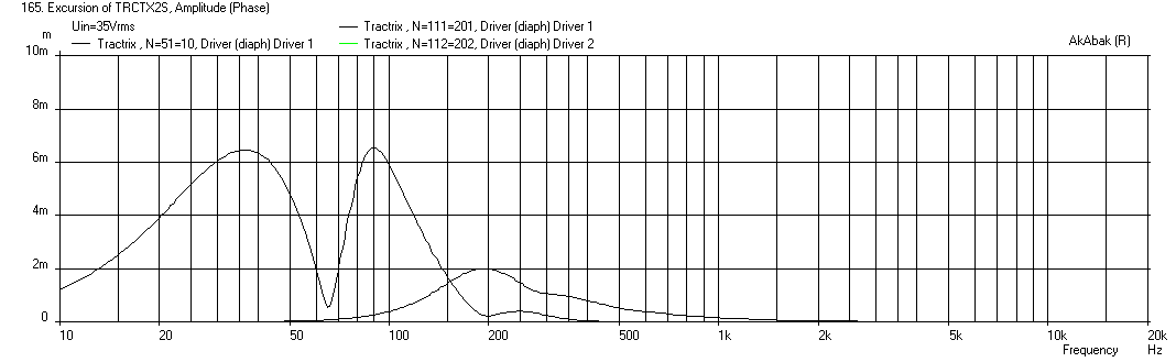

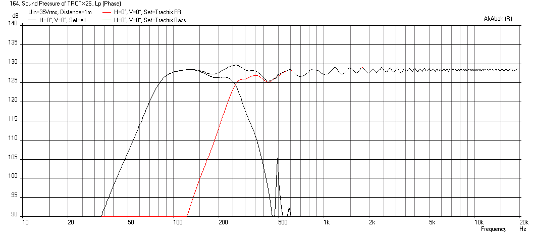

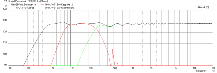

I added a pair of Kappalite 12's driving some injection ports in the tractrix at a few strategically placed points to get this nice 2-way system that reaches down to 80Hz for a good hand-over to a subwoofer.
Freq Response at xmax of both drivers (with some relative gain adjustment):
Cone Displacement for 5MR450-NDY and Kappalite 12:
Pretty cool huh?

I'm a little sceptic about the response in that horn. While the naked driver does very well off axis I think it is a result of the cone shape. Putting it behind that horn might screw that up. A prototype will tell us that though.
I think the waveguide I proposed would have more of a chance to keep that nice off axis response intact.
We will have to see how the prototype works. However, it is based on a type of design similar to the Bruce Edgar horn which I believe were well regarded for their uniform directivity. Some things that may be required include a thin layer of open cell reticulated foam around the throat to smooth out some of the early off axis reflections from the driver onto the walls of the horn.

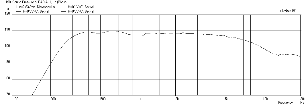

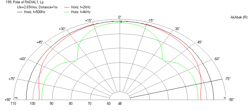

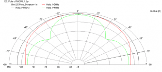

Radial horn to approximate tractrix in Akabak
There is an option to use a "Horn" radiator element which accounts for the non-planar nature of a horn's mouth output. It is actually very computationally intensive as the mouth is subdivided into many segments and each solved assuming propagation vector based on geometry of horn mouth flare. In Akabak Salmon T factors are used to describe the curvature with T=0 for catenoid and T=1 for exponential. As a guess, I am saying that the tractrix is somewhere in between a catenoid and an exponential, the degree of which is controlled via how big or small T factor is from [0,1]. It is interesting but the sensitivity at the lower frequencies is similar to the plane wave tractrix presented previously but there is falloff in the HF's, probably a lot closer to reality and it starts to drop above 5kHz and is down about -12dB by 15kHz. This is still very usable but some HF falloff is to be expected with this model. The nice thing about using a Horn radiator element is that a single element specified by the throat, mouth, length, and T factor, completely describes the horn. Putting in the same throat, mouth, length and T=0.5 factor, I get the following predicted frequency response:
What is neat is that the polar response now looks very nice for 500Hz, 2kHz, 4kHz (up to 2 kHz the directivity is uniform):
Seems to me you'd give up a lot of the good qualities of this driver for the gain in sensitivity. Most of that not needed in a home environment right?
That's why I proposed the more shallow waveguide a la Danley. This is already a very sensitive driver but also has very nice controlled HF response for it's size. It would be sad to loose that i.m.h.o.

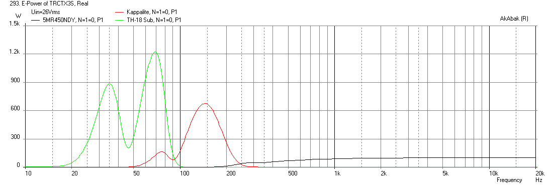

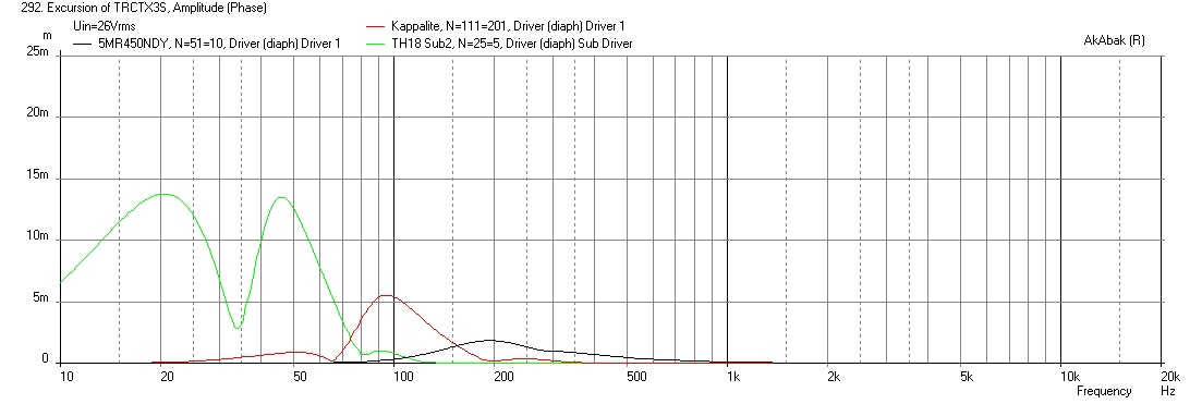

Tractrix 2-way Synergy w/ 2x TH-18 subs
This is purely academic at this point but I wanted to show what the 2-way tractrix Synergy and a couple of TH-18 subs could look like and the power they take. More of an exercise to see how to show three simultaneous sims on one speaker system.
The following gain factors were used: 0.95 for 5MR450-NDY's, 2.0 for the dual Kappalite 12's, and 3.5 for the dual 18 Sound 18LW2400-8's. At 26v overall, this This gives 24.7v for the highs, 52v for the mids, and 91v for the subs.
Here is the predicted freq response at near xmax of the Kappalites and 5MR450's and the thermal AES limit of the 18LW2400 subs (1.2kW):
Here is the corresponding cone displacements:
Here is the electrical power input (note that value for sub needs to be x2):

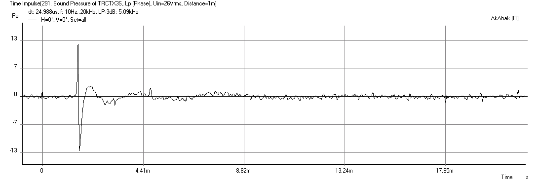

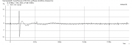

Here is the impulse response:
Even pure academic and targeted another application used at home very audiophile picture 1 & 4 add headroom be a dream and probably distortion too. SPL wise a private party could involve not only nabours but streets away.
Wasn't sure if you are saying that the results look good or bad from an audiophile standpoint? I would be less worried about the neighbors and more worried about what damage the SPL's will do to the walls/windows/structure of the house (not to mention one's hearing loss) 🙂

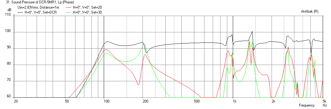

DCR with the 5MR450NDY (4 ohm version)
Here is a design for compact DCR that reaches 100Hz. Cabinet 6 in wide x 6.67 in tall x 5 in deep for upper chamber and a 6 in wide x 3.33 in tall x 5 in deep lower chamber (all internal dims), and a 2.0 in dia x 6.5 in long vents (all three). Note that the vents will require some clever elbows to get 6.5 in length into a 5 in deep cabinet. If used with a -12dB/oct high pass at 100Hz, the 2mm xmax won't be reached until 15 volts input. At which point max SPL is about 108dB.
