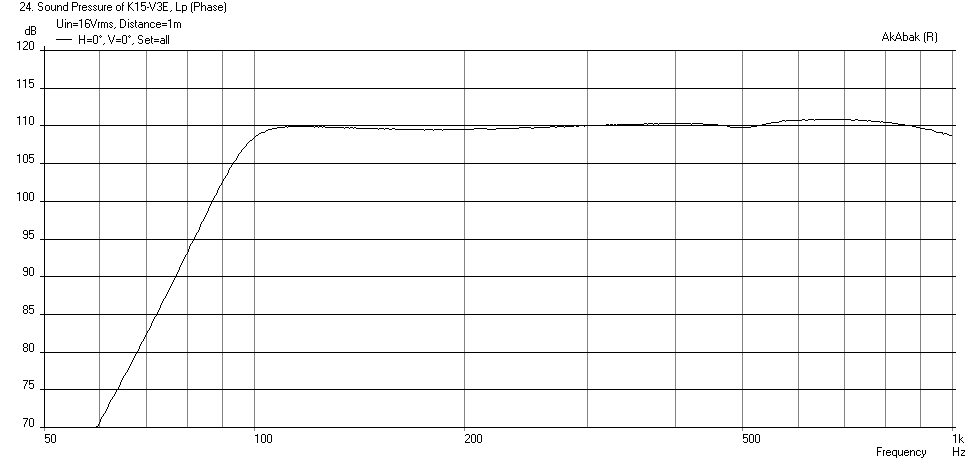

I might try a FC Klam one of these days soon. Here is what the sim predicts for the 0.35x scale K15 with the 6MR500 driver at xmax of 2.5mm (16 volts).

That 115BK looks interesting. What is your impression of how different does it sound compared to K15? When I scale the K15 down to a small size to get only 100Hz extension, the dips that would normally be in the 200 to 500Hz range really go away. It is just a sim so don't know how it works in reality. There are some 3d effects between the wings and cone when things get this small.

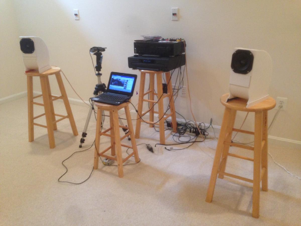

5MR450NDY in Nautaloss Stereo!
Finally received the second driver and installed into the other Nautaloss box. Set it up using a 175 Hz XO (24dB/oct) and a boost to the subwoofer of +5dB overall output to compensate for the higher sensitivity of the tops. Well, I fired it up with a tune from YouTube, and even with such a limited quality source, it sounds FANTASTIC! The dynamics, articulation, and overall impact are amazing. With the MR450NDY's being true point sources as opposed to the the dual Vifa's, the coherence/imaging, sound stage, and presence are just superb. The highs are not lacking. It sounds really, really, GOOD. 😀
Here is a photo of the setup:
attachment.php
Here is a sound clip from YouTube as the source.
Have a listen to it and really think about trying these drivers out - they take fullrange to a new level in that the head room is huge and the peak SPL's are very high if needed. You can play very loudly with modest amps. Almost party levels.
Thanks reporting xrk971, sound clip sounds very live, is the file a recording from your room or is it as you write "Here is a sound clip from YouTube as the source".
Imagine it sounds good, this based you earlier learnt me the importance of 3-4 feets from backwall, plus your one point sits aprox in middle of floor and ceiling. Such setup gives me very good sound with A10.2 sitting alone 40-20Khz though the driver needs heavy EQ to be as i think real neutral not the same as A10.2 neutral and the bottom needs a boost because of sealed box. Guess you can reach clean sound and high SPL in room, being a pleasure being in the room.
Great....
Just observed myself than when setup is spaced away from backwall/floor/ceiling like yours, at same is a relative simple pointing device 1 or 2 way and tuned to good sound in room, then sound from other room with open door is relative good too just without inface sound. Where with speakers tight spaced to walls/floor/ceiling and/or more multiway driven, sound from another room with open door really change character (Power response from certain frequency range rule, often the lower end).
Yes, the imaging and sound stage really improve when the speakers are set at least 4 ft from back wall. Sometimes I close my eyes and I can pinpoint the drum kit location, the cello, the piano, etc and the singer. There is something different when the full range driver is a 5 inch vs a 3.5 inch - it just feels more visceral when you hear cymbals, drums, and even voices. Anyhow, I am really happy with these speakers now and will just be listening and enjoying them for a while as I work on a new box for them that will allow them to reach maximum SPL with less cone motion than a sealed box.
