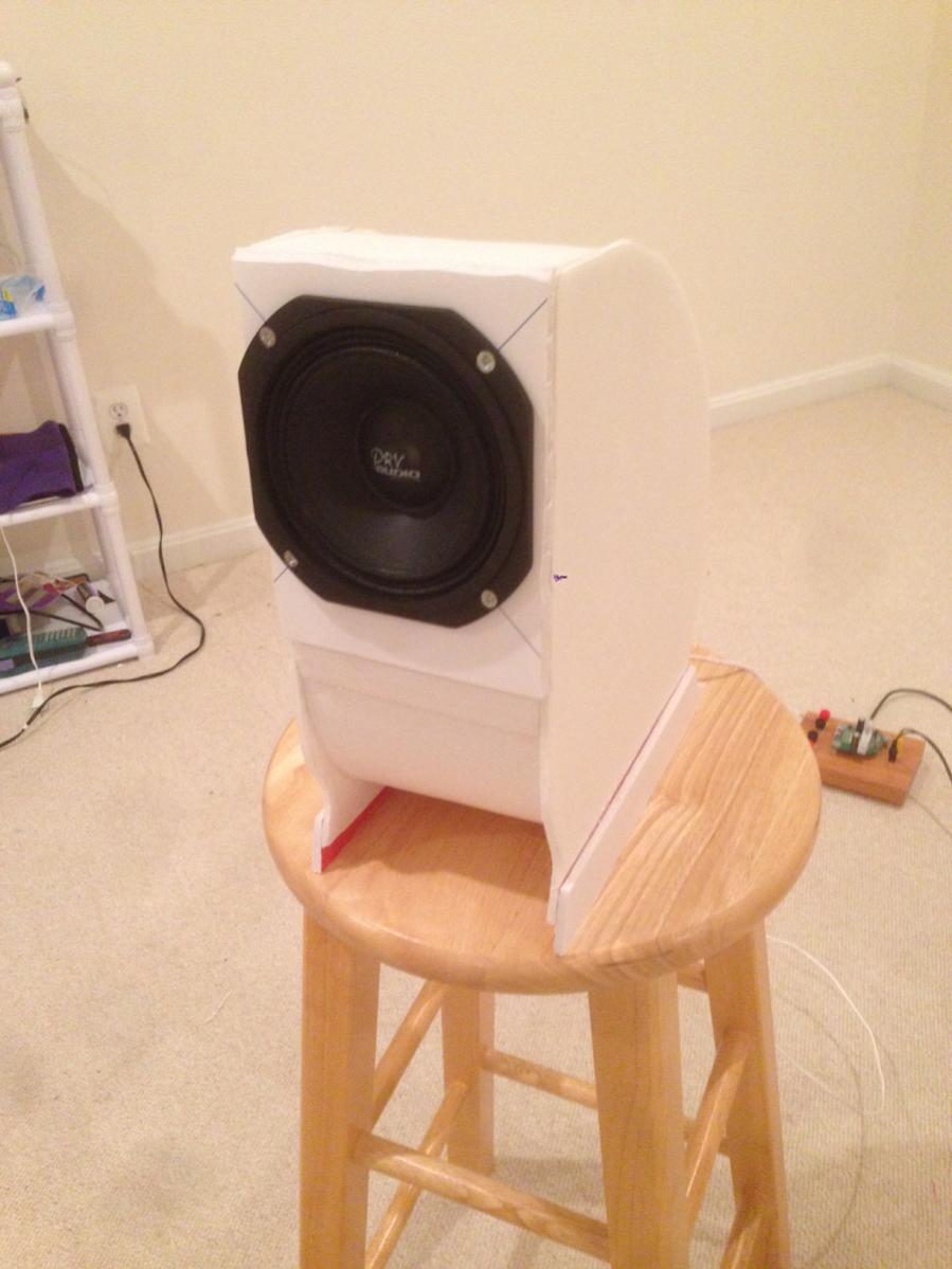

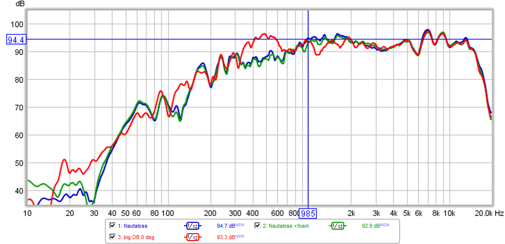

5MR450-NDY stuffed into a TC9FD's Nautaloss
I wanted to see what a sealed cabinet would look like with this driver so I shoe-horned it into my existing Nautaloss spiral sealed TL enclosure that normally houses a much smaller Vifa TC9FD. I had to add a third layer of foam core on the baffle for extra strength, I removed some bracing with a razor, and added more closed cell foam and stuffing behind the driver. Here is a photo of the oversized driver sitting in a tiny Nautaloss:
attachment.php

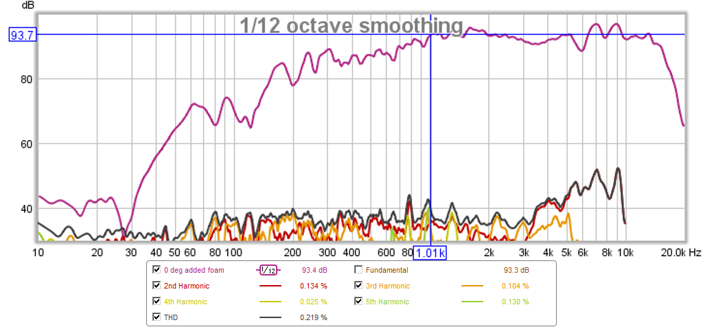

I think the Vifa's Nautaloss is too small for this driver as you will see that there appears to be coloration in that the response is not flat anymore. Listening to it in the Nautaloss, it sounded a bit bright and that is probably due to the rise between 1-2kHz. Here is the frequency response and HD at 0 deg, 1 meter away, 2.83 volts drive voltage:
attachment.php

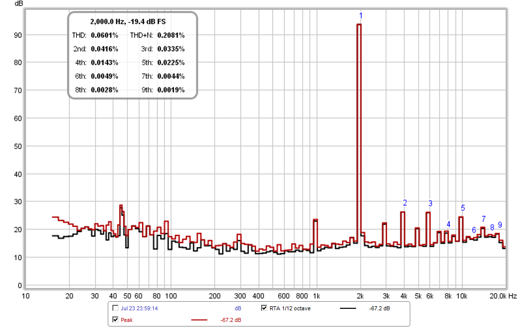

Note that the HD with the sealed Nautaloss enclosure is very low, lower than it was in the OB configuration. Just to demonstrate how low the HD is and how clean this signal is, here is the RTA with a 2kHz sine wave drive at 2.83V (the HD is more than -60 dB below the fundamental, and the fundamental is a very sharp peak - which explains why this driver sounds so good as it is very clean):
attachment.php

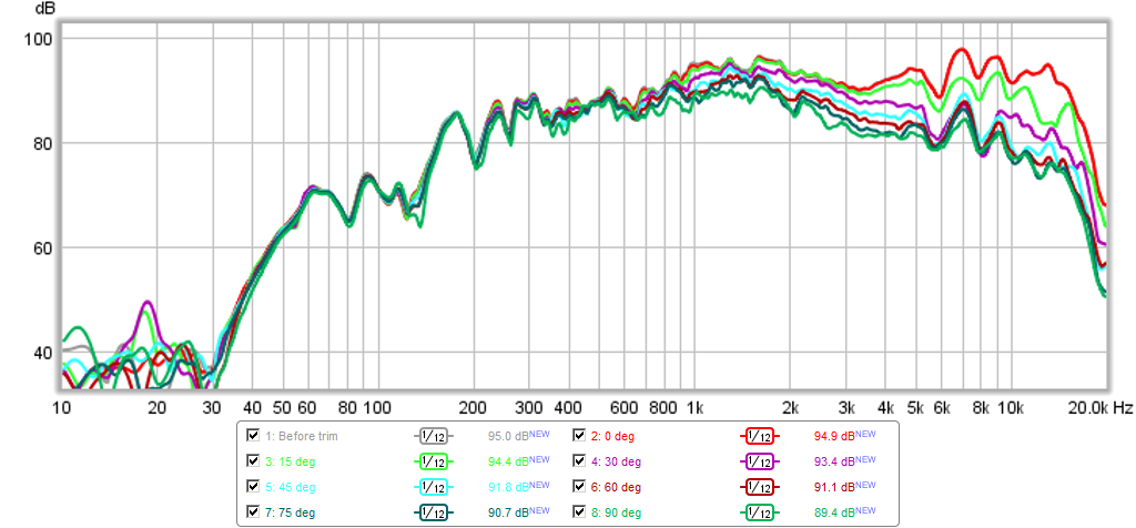

Here is the polar response with the Nautaloss at 1 m from 0 deg to 90 deg in 15 deg increments:
attachment.php
Here is the comparison of the Nautaloss and a larger OB (22 in wide x 35 in high, driver offset so that it is 9 in from side and 9.5 in from top):
attachment.php
The OB is clearly flatter which means that the Nautaloss is too small to act as an acoustic black hole. I think the Nautaloss can work with this driver, it just needs to be designed from scratch and made bigger.

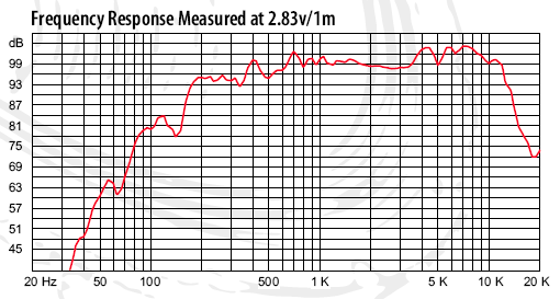

Here is the bigger brother to the 5MR450, a 6.5 incher with 100 dB efficiency with a pretty good looking response:
http://www.parts-express.com/pedocs/specs/294-2706s.pdf
A 100dB sensitive driver with 250 watt power handling, Qts of 0.41, has ultra-low distortion, and a 100Hz to 13kHz range is pretty cool. 😀

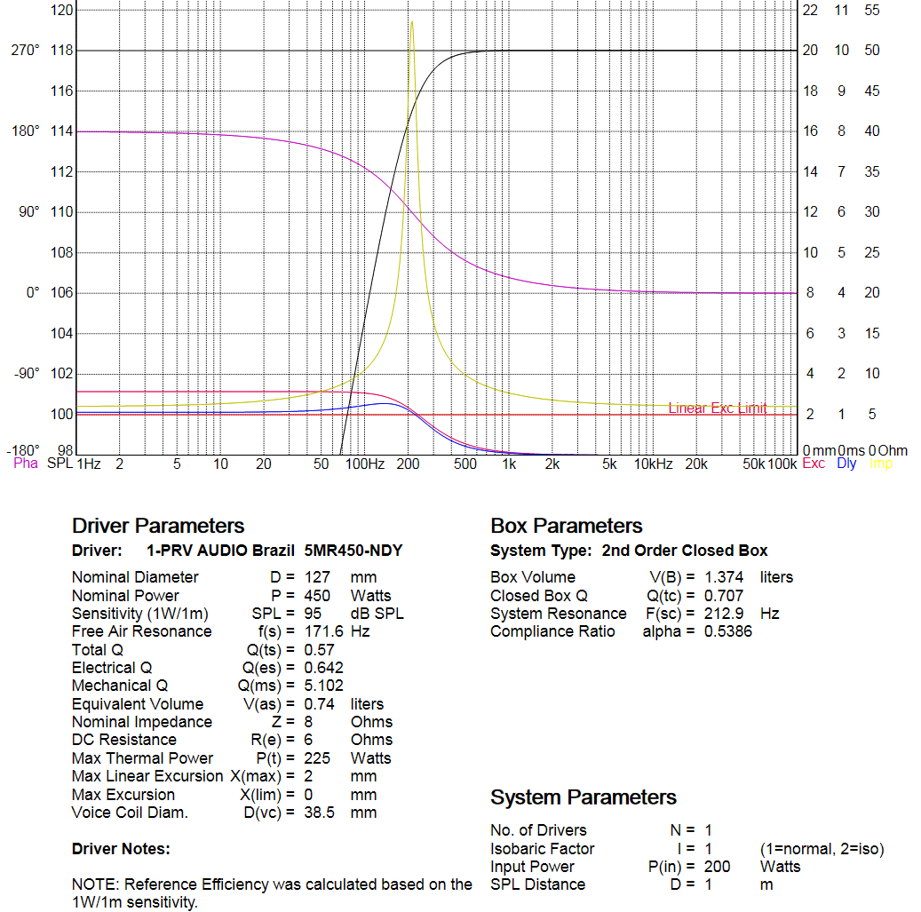

Just for info my program "WinspeakerZ" don't agree the 6 liters sealed box example in post #1, seems some deviation in box volume and SPL.
In program setting Qtc 0.707 gives 1,374 liters verse 6 liters (to get 6 liters mean Qtc setting around 0.604).
In program setting 200 watt as input gives 118dB SPL verse 113dB (needs highpass around 230hZ to keep Xmax safe at low frequency).
Attach picture with plot and known driver parameters (only driver parameter missing seems "Le" voice coil inductance).

I only used 6 liters because that is close to the size of the box I had and one can control Qtc directly in AkAbak by setting it independent of volume. In reality this can be done by adjusting level of stuffing. Having much smaller 1.37 liter volume will of course allow higher SPL but will give a very congested boxy sound as all that back energy radiated can come back out the cone much easier. Let me rerun the sim in AkAbak with 1.64 liter and Q of 0.64 and same HPF and see what I get. I don't think there is disagreement just that we used different volumes and Q.

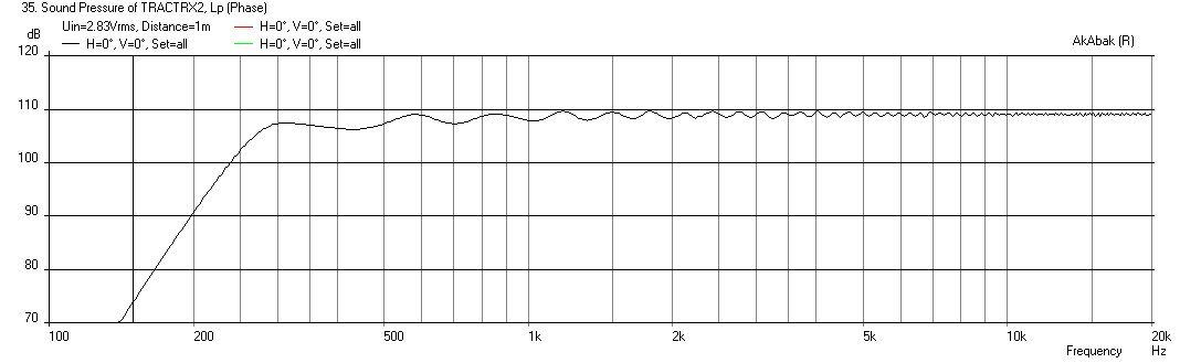

Using a tractrix profile calculated using Volvotreter's spreadsheet with 2 curved walls and 2 flat walls (http://volvotreter.de/downloads/Tractrix_v1.4b.zip), then modeled in Akabak as a 16 segment waveguide I get the following response for a 0.67m wide x 0.45 high x 0.54 m long tractrix horn with a 7.1 cm square throat. It provides a speaker with about 109 dB sensitivity at 2.83v and 1m, and a 130 dB SPL at 1m and 37 volts when driven to xmax - which also corresponds to 225 watts rms max thermally limted power rating. This is with a sealed 6 liter heavily stuffed rear chamber.
This speaker is very sensitive so cone motions at 100dB SPL at 1m are in the 50 micron range, and as a result, HD is very very low. I would guess consistently below -60dB THD.
