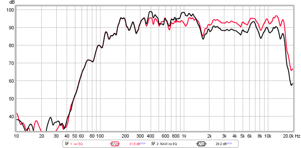

New EQ with Polar Data & Sound Clip

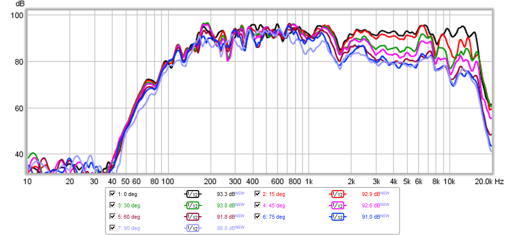

Here is the polar response with the new EQ optimized for this horn.
Even with all the panel vibrations, the sound is pretty good. I can imagine that once I get rid of the vibrations, this can sound very clean. One thing I am noticing is that the horn appears to really be loading the cone movement well. If I stick my hand all the way in and touch the cone, it barely moves but the sound pressure and vibrations coming out are much larger than one would expect from such tiny movements.

The horizontal polars look tractrix-kind with the increasing directivity towards the HF. The narrowing coverage also helps the HF to get back up (by alot, 10-20db in your case!), some might forget that. If you would have done contant directivity horn (ie. conical) your HF response would be much less.
What kind of frequency shaping did you use and what does the raw 0 deg response look like?
Have you measured vertical polars yet? Those would also be interesting.

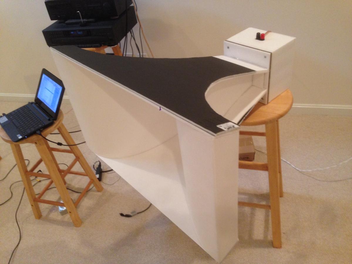

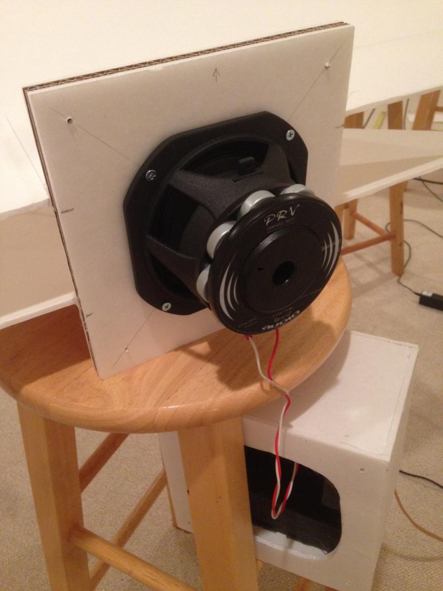

I made a 5.25 liter rear chamber lined it with grey foam, added binding posts and quick disconnects. The driver mounts to the horn flange then the box covers the back of the driver and is screwed on tight.
Initial listening tests indicate that the panels vibrate a lot so I will have to add bracing later. However, the naysayers who said nothing more than 5kHz will get through, and they also said the polar directivity won't have anything off axis to speak of, they are, fortunately, all wrong. The tractrix as designed indeed lets HF's through and works off-axis. I get 15kHz on axis and it drops off with angle but clearly this is substantial HF getting out of the horn. Some rough polars (+/- 3 deg) show that the directivity is not bad. Up to +/- 30 deg is very respectable. I did not have time to remove the baffle step shelf EQ from the Nautaloss so this is certainly not optimized. I need to give it a rising response so that it will be flat, but this driver has lots of headroom so that should not be a problem. The 1.7kHz dip corresponds to 4in - probably the rear chamber reflection. Ideally a Nautaloss back chamber would be ideal.

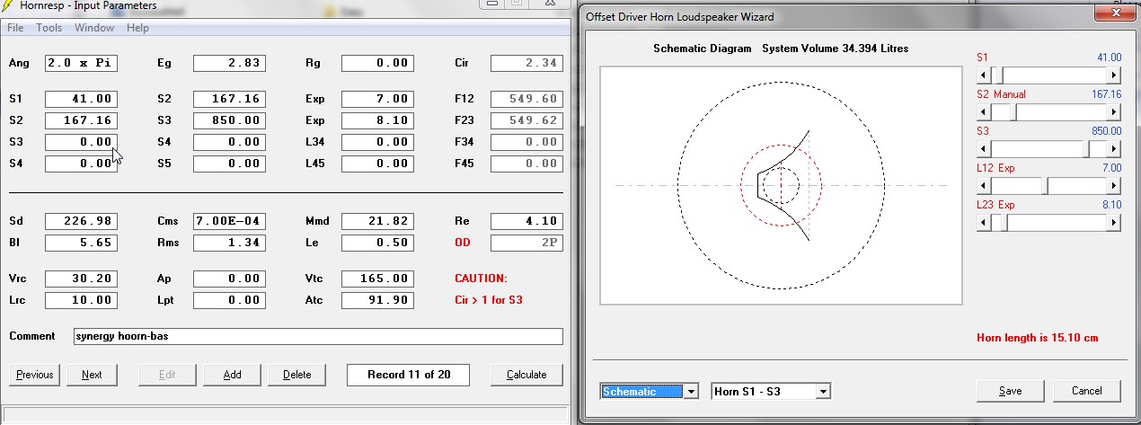

Have you sim this with hornresp? I did and I get not the export well, the two straight plates up and down is a problem when export the horn with hornresp, maybe you can tell me how you did this, I do like this one, and want a two way for home use covering 80 Hz to 20 Khz, if that low will work, but hornresp say yes.
The horn looks more exponential then tractrix to my eyes.

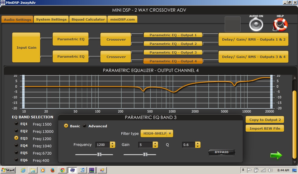

Thanks for checking it out and the encouragement. I guess you have enough of a system on your hands but you should fire up that old tractrix horn you have lying around. 🙂 I forgot to save the raw response but it needed a few notches (6.7khz for same breakup mode reduction, and 400Hz) and a high shelf from 1200Hz and I added another one up high at 13khz for more "air". The negative notch at 1.04kHz is the one I would have preferred not to use but I made it wide. Following the general practice of not applying positive peak EQ, if notches go wide and stay away from 500Hz to 5kHz range. Here is the PEQ snapshot of what was applied. I will have to retake the raw data when I do vertical polars (by flipping horn 90 deg).

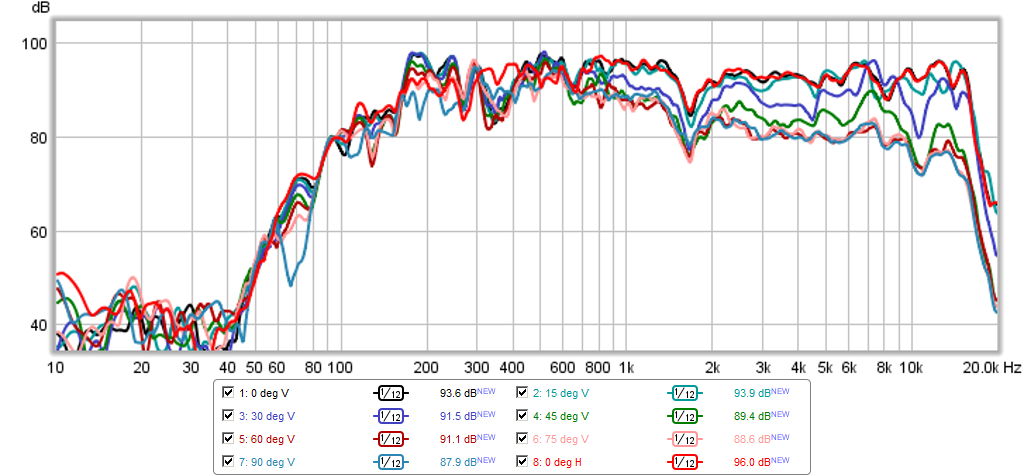

Vertical Polar Measurment
I rotated the speaker 90 deg about its axis in order to do the vertical polars. It seems there is a floor bounce that is more pronounced than the other orientation. It is pretty flat over +/- 30 deg. Also shown in the 0 deg horizontal trace for comparison. Note that this is using a newer EQ where I smoothed out the peak that was at 180Hz and I reduced the notch at 1.04kHz (actually shifted to 1150 Hz).

Indoors. Let me give that IR window a try. I am adding a second layer of foam with household latex caulking in between for a constrained layer damping. Just finished top and bottom. The curved sides will be tricky because need to make another curved panel and needs to be clamped while drying... Maybe add patches of CLD rather than one big sheet?

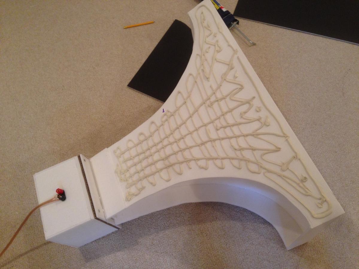

Here are some progress photos of the constrained layer damping that I have managed to add to the top and bottom (latex caulking between 2 layers of foam core). I also trimmed down the panels to reduce radiator area for sound emission.
Liberal dose of latex caulking for the constrained layer:
attachment.php
Panels added on top of caulking:
attachment.php
Closeup of the driver and driver chamber (sitting below) - that's a lot of Nd magnets for a 5 inch driver:
attachment.php

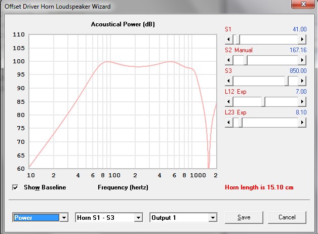

Unfortunately, that 1.7 kHz dip is not a back reflection but results from a 4.1 in path cancellation corresponding to the diagonal distance from one vertex to the opposite vertex in the horn throat. Only way to fix this is to use a phase plug or maybe make a round throat that transitions to square. So, no hats off to me I guess... 😀 In any event, the raw vs EQ'd response looks not so bad, with that cancellation dip being the only major blemish.
Code for Tractrix Synergy
