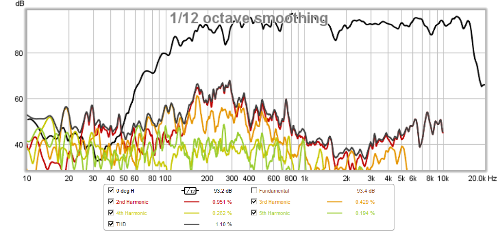

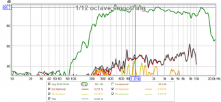

Constrained Layer Damping (CLD) Reduces HD
As I noted earlier that the foam panel vibrations were contributing to the harmonic distortion, my idea was to use a combination of CLD and bracing. Well I have the CLD implemented so far using two layers of foam core and latex caulking in between. I haven't gotten to the bracing yet but took some measurements to see if there was a difference. I actually had music playing through the horn during the CLD process and started noticing that it sounded different, in a good way. Vocals got clearer, and the volume got louder. I could feel that the walls vibrated significantly less. It is quite an improvement in the reduction of HD as you can see from the graphs below (before & after but same EQ).
Before CLD:

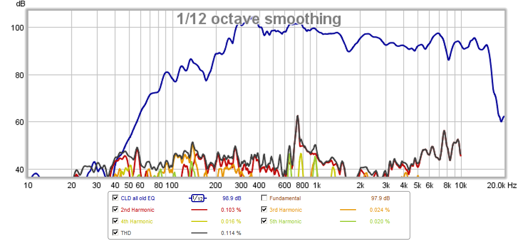

After CLD with same EQ as above - a HUGE improvement in HD, now with levels in the -50dB and as low as -60dB at certain frequency ranges:

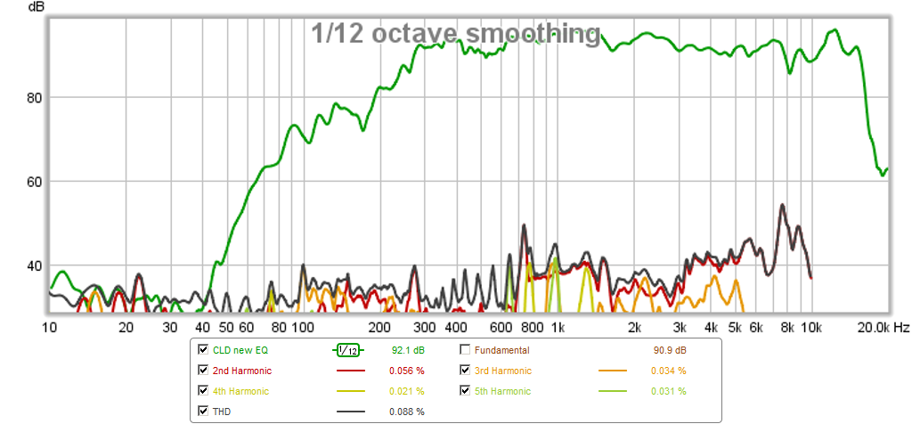

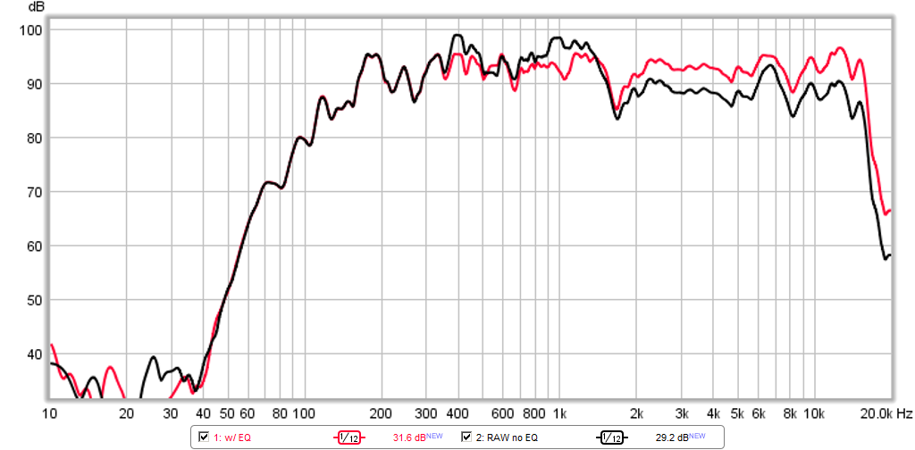

Here is the response and HD with the new EQ applied (I even used a positive peak EQ to flatten the 1.7 kHz dip caused by the horn throat cancellation and the distortion is still intact):
What do other horns look like HD wise? This is at a pretty decent level of 93dB average SPL.
Listening to it, I think it is clearer and very nice. Not sure if I still need bracing?
I will post sound clips later for you all to hear. So far though, I would have to say that this project is a success and will stay out of the trash bin.

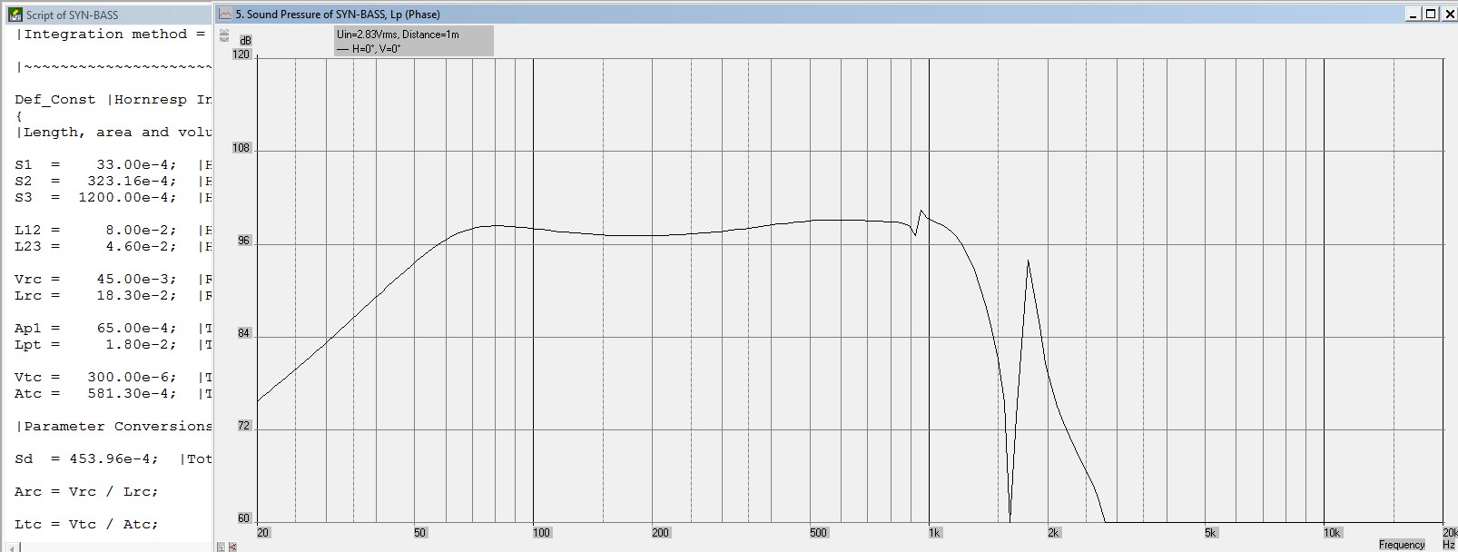

Kees,
Look at the raw response data from this horn (black curve).
That is not a terrible response - I could have just applied a low shelf cut and ignore the sharp peaks and it would be close to what I have for the red curve. I have seen a lot of horn responses that have looked worse, and these are factory horns, DIY conical horns, exponential horns, etc. I haven't seen one that only requires less than 2dB tweaking on EQ. Like Anthony Bisset said, this horn opens up a opportunity for those not able or willing to integrate a CD, mid driver, and bass driver in either multiple horns or a Synergy with requisite time and spatial alignment. It's hard work to get a Synergy integrated properly. Here we have ability to do it with one driver plus a supporting sub. There are limitations and compromises certainly. It is not going to sound like a Danley 9-driver SH50. A wonderful speaker but super complicated and probably beyond the capability of many a DIYer to replicate (both cost and technical difficulty). I think the dip at 1.7kHz is the big issue and that can only be fixed with a phase plug. As I have said before I am trying to replicate something more along the lines of a Funktion1 Axehead single driver horn. A few things that should be noted is that this project is accessible to one without a wood work shop or powertools. The only tools I used are a razor, straightedge, and adhesive. No sawdust. I made it over three 2 hour sessions and the cost of the materials not including $105 driver is $15 ($8 in foam core, $4 in caulking, $2 hot glue sticks, $1 binding post).
Yes, AkAbak predicts HF above 5kHz, and measurements seem to show this. What was surprising was the wide polar coverage rather than a narrow beam as many have said would happen. How this is happening is probably diffraction/reflection effects in the horn so it may not be a true spherical wavefront? Not the end of the world as many speakers (Karlson) and even some horns (diffraction horns) use this to good effect.
If we accept as dogma what some pioneers have laid down as theory and principles not to be pushed, there would be no innovation and no progress. I wonder what many experienced horn builders pre-Danley said when he decided to use the concept of pressure injection through wall mounted ports! How crazy is that? I bet they all said that will never work etc because it will mess up the nice smooth wall and wavefront of the vertex mounted CD. What do you think all those people who said it will never work are saying now? They still make huge triple horns I guess.

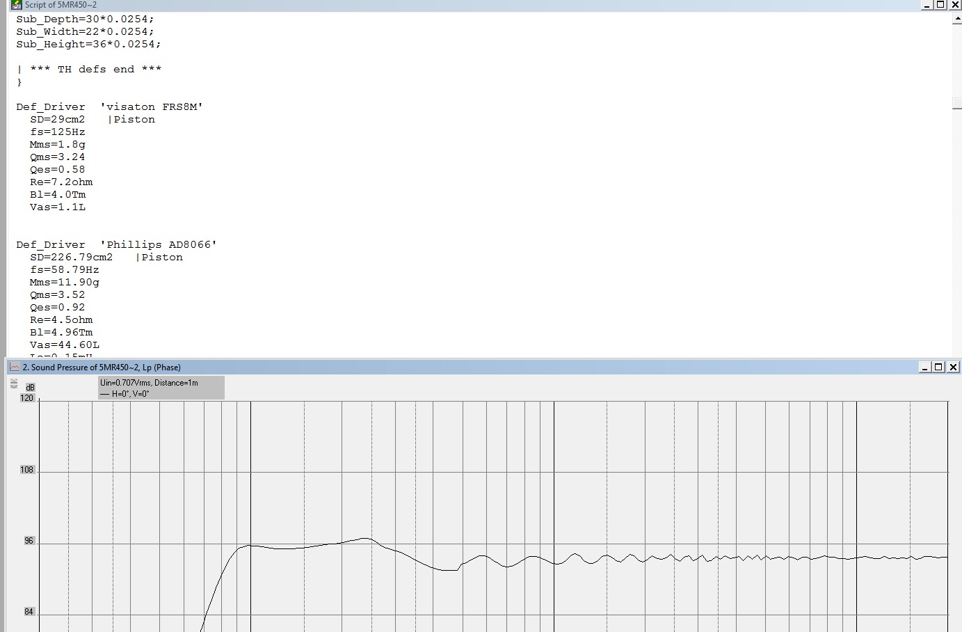

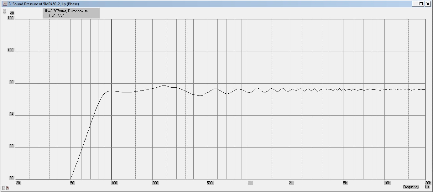

Hi
I have change your script, remove the tapped horn and filter and use only the bas mid.
Do you use only a high driver then I do not now if this is working well, but when a synergy it looks it does, I have some thought that it is not tractrix? you say that hornresp can not make much segments but dos calculates the flare I need there I can put the segemenst I need in cm, I have drawn the export see picture, some time ago.
The other photos are the visaton wideband speaker and the old 1976 phillips woofers, I put two on both sides I do not now you did also in script.
And yes I need to build it, I do not want a dB canon, it is for home use, I can also try to replace the frs8 for a tweeter biut most have not thiele small parameters and I do not now how to measure that with limp if it is possible, I think use a tweeter will be better, I go simulate a bas alone to see how far it extent.
I have download the volvotreter program but when use phillips it mass rollof in atractrix is 235 hz, (80 hrtz start), and it is nog so easy because I need autocad with it.
pictures are my drivers in your design, nothing changed but phillips have little more efficienty so on picture two I have change mid gain to 1.5.
regards kees

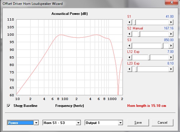

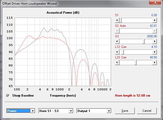

NEO Dan,
Unfortunately, that 1.7 kHz dip is not a back reflection but results from a 4.1 in path cancellation corresponding to the diagonal distance from one vertex to the opposite vertex in the horn throat. Only way to fix this is to use a phase plug or maybe make a round throat that transitions to square. So, no hats off to me I guess... 😀 In any event, the raw vs EQ'd response looks not so bad, with that cancellation dip being the only major blemish.

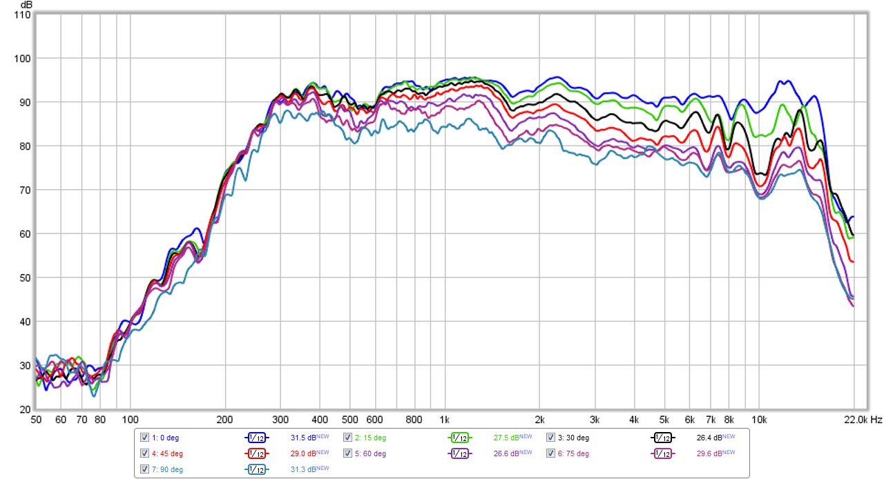

New Polar Data with CLD Tractrix

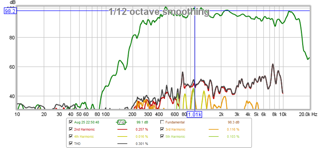

I wanted to see if the constrained layer damping (CLD) affects the polar response - it does. I also ran the horn at a higher drive voltage to see how that affects distortion.
In order not to clip the mic, I had to move the mic back to 2m and got about 98dB, or 104dB at 1m. The HD still looks pretty good:

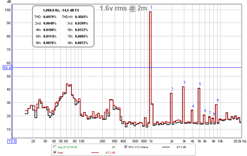

And here is the RTA with a 1kHz sine wave has the THD at less than 0.1%:

You have low noise measuring equoment, mine have massive phantom voltage/mic driver noise that rises towards the LF. What mic/mic amp/sound card do you use?
I would be interested to see how horn's damping affected the raw response, compared to the old raw.
