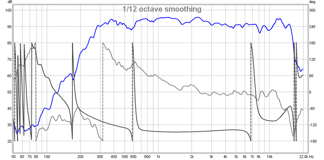

Phase data at 1m w/ EQ
Here is the response as measured at 1m away (on axis) and acoustic signal phase. Surprisingly, the 1.7kHz boost did not throw the phase out of whack - appears to still vary linearly at the region I was most worried about. I would like it not to have any sudden phase wraps from 500Hz to 5kHz where all the point-source imaging signal cues are held. This horn actually did pretty well except for the one wrap at 600Hz. I don't know what is happening there but don't recall applying any EQ there.

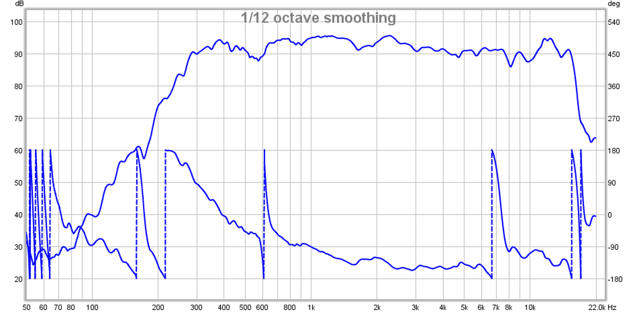

There is a check box to unwrap the phase in the settings panel in the upper right area near the deg corner of the graph. IMO looks great between 700-6K. Great overall really :nod:
You mean like this? But then you lose info of where the wrap happens?

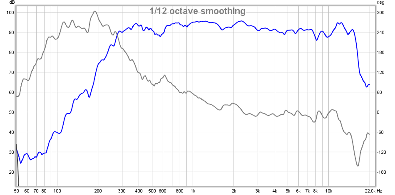

Or one can show it as minimum phase and excess phase, where the region bounded by 700Hz to 6kHz is clearly seen:

and a repeat
Did you ask this before and I never replied? I will see if I have any phase data from near the mouth as you will get phase wraps when far away due to pathlength difference.

Byrtt,
The 250Hz XO was indeed turned on in the above plots. That is probably cause of phase wrap near 300Hz.
Sorry I misunderstood your "repeat" - thanks for the kind words. I guess we say "two thumbs up" to mean same thing.
The more I look at the data and my listening impressions of this horn I am more certain that it is a worthwhile project for someone looking to try a fullrange horn as a project and do not have a wood shop to build one. The foam core with CLD is a very viable alternative for a home audio horn. Its light weight makes it very easy to place in room or move around. I had a lot of fun listening to it and now that it is put away, I am starting to miss its sound. The impact of the horn sound is unmistakable. You can be much farther away and it feels like you are in front of it. Vocals also have an enhanced intelligibility. I might have to build the stereo pair now😀
The data is only lost/altered permanently if you extract and then overwrite the original record with the minimum phase data.
The phase is constantly falling so when it is unwrapped it no longer fits the scale of the graph, you can change and offset the scale to get it back in the display window.

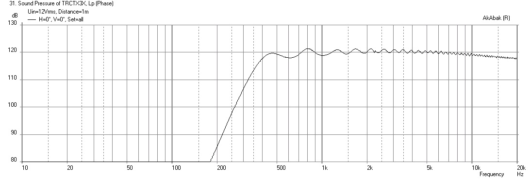

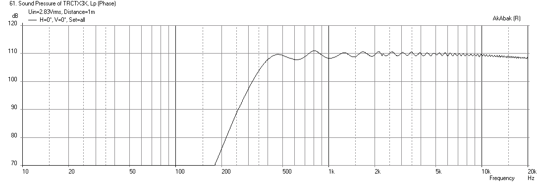

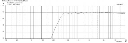

0.70x scale tractrix with 3 inch fullrange driver
I am exploring the possibility of a smaller less expensive version of the tractrix horn but still with a similar killer performance. Not sure if possible until I build a prototype but if the sims hold up for this none like they did for the 5MR450NDY, it could be really interesting. The 0.7x scale provides a very manageable size of 20 in wide x 12 in tall x 15 in deep. This means that a single sheet of foam core can be used for the top and bottom panels, thus cutting foam core requirements in half. The horn should be able to provide about 400 Hz on the low end and upwards of 18kHz on the high.
Here is the predicted SPL at max thermal load of 40watts or 12v, cone displacement here is 0.9mm so xmax is still far off so HD should be very low:
Sensitivity at 2.83v is about 108dB at 1m.
The best part is this driver only costs about $20. Anyone interested?

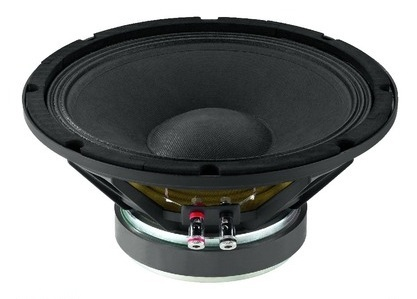

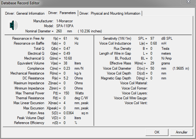

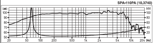

Know it's early in process but for 2 way home system combine this 10" available in Europe at cost 63€, your teaser 20" x 12" horn, XO 800-1000Hz area, and DSP'ed system.

There is an 8ohm version of the 3FE25, it probably works fine too. Slightly higher Qts - but I am seeing that in the sims, a higher Qts is not necessarily bad for a horn. Probably want lower Qms though to damp out oscillations. That Monacor 8in looks like a nice driver. Are you thinking of putting it to an injection port a la Synergy or separate sealed box?
Was thinking off sealed because of simplicity, but now you ask remind me i haven't thought of the wave distance between the two drivers center related to XO frequency, need to check.
