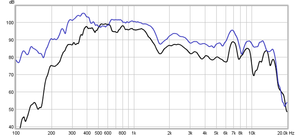

Here is raw response of the 5MR450NDY in the 1x(blue curve) vs the 0.7x (black curve). The drive levels are different as are the HPF settings. However, trends are there and you can see that they are similar with the 0.7x having more attenuation of the HF content, and it exhibits more harsh peakiness above 6kHz and big dip at 10kHz. Also, the low end reach on the 1x is 300Hz and 400Hz on the 0.7x. It could probably made to work.
Nice is it wrong mayby expect some pretty good response when you do some tactical clever DSP EQ'ing. If you later on intend digging deeper be nice viewing EQ'ed plots and listening a soundclip.

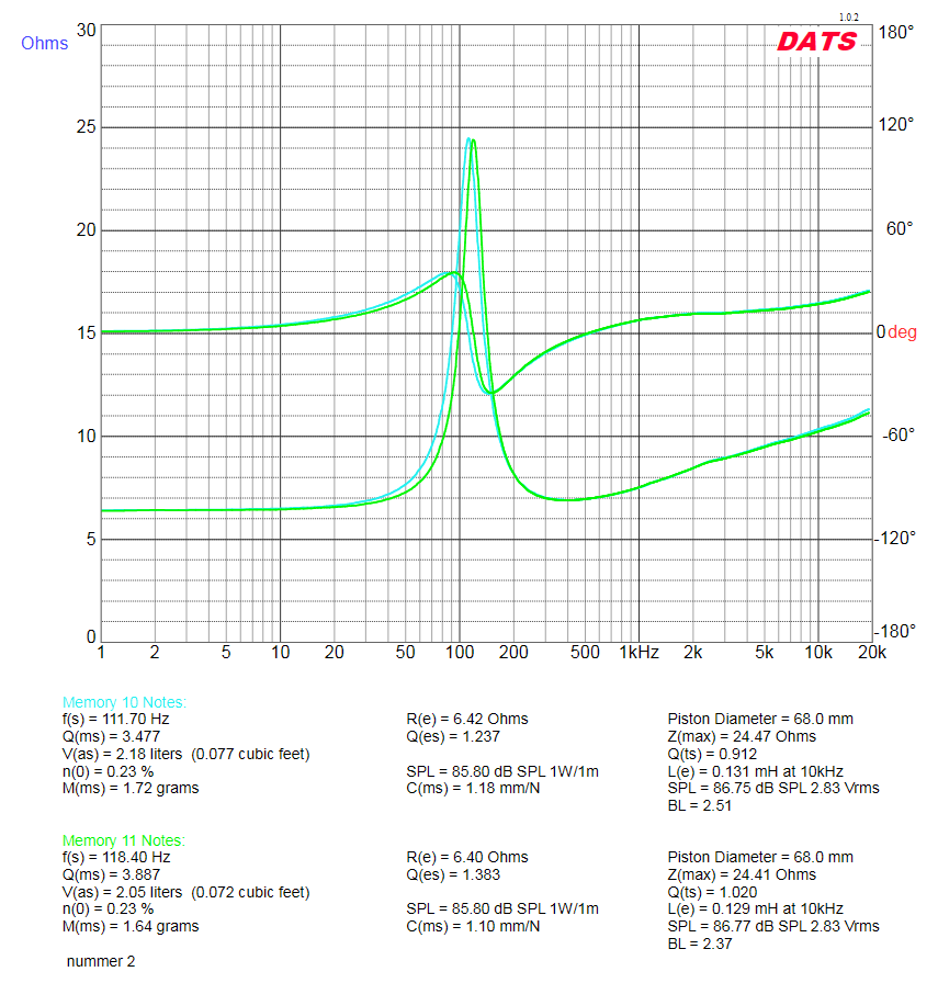

Both Vifa's impedance and TS data taken by DATS unit:

Btw, your Vifa's measure very well - you have some nice lower fs units. Mine measured at 125hz.

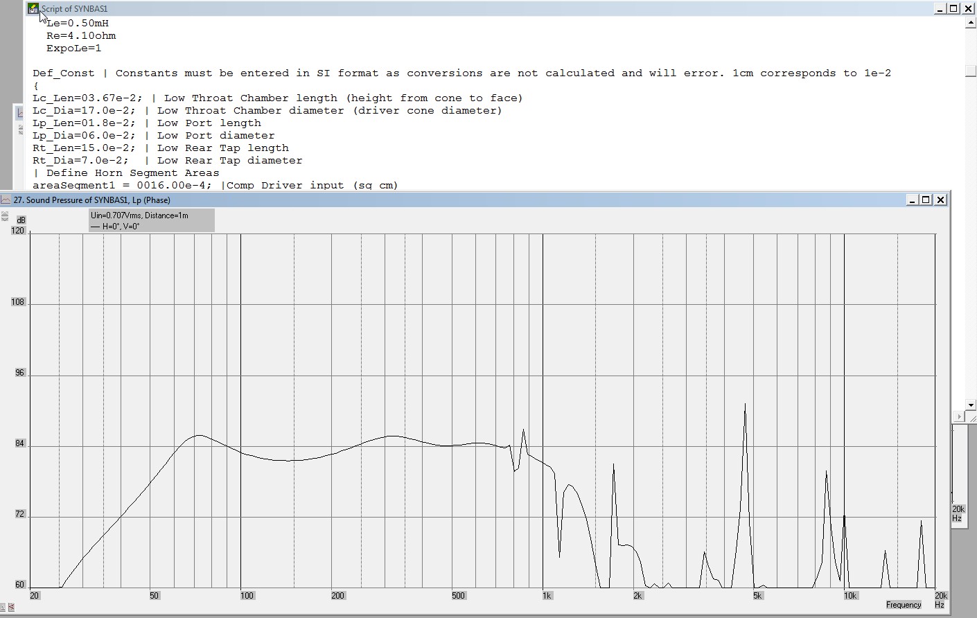

I have a little question.
Enclosure 'Low Rear Chamber' Node=70 Vb=40L Lb=20cm
Driver 'Low Driver A' Def='LowDriver' Node=30=31=70=71
Duct 'Low Throat Chamber A' Node=71=73 dD={Lc_Dia} Len={Lc_Len}
Duct 'Low Port A1' Node=73=130 dD={Lp_Dia} Len={Lp_Len}
Driver 'Low Driver B' Def='LowDriver' Node=31=0=70=72
Duct 'Low Throat Chamber B' Node=72=74 dD={Lc_Dia} Len={Lc_Len}
Duct 'Low Port B1' Node=74=130 dD={Lp_Dia} Len={Lp_Len}
Duct 'Rear Tap 1' Node=70=140 dD={Rt_Dia} Len={Rt_Len}
Duct 'Rear Tap 2' Node=70=140 dD={Rt_Dia} Len={Rt_Len}
Waveguide 'WG1'
how are the speakers connected? serial or paralell.
I think I get slowly understand akabak a little, special when I have examples, it is quite readable.
this here I see that the low port input and low tap are on the same distance? like on left and one right of horn .

here some sim from the phillips, I have drop the mids because I want
two way, I go for conic horn with a tweeter driver..
See a fase shift at 800 a 900 hz cancel the sound off, I did also see phillips
like closed back more then port support. Also the extra flare on the edge of the synergy horn do give for me a more badly response (peak on 800 hz.) do
not now why because it has to smooth out, not for all speakers i think.
here I have the inspiration from.

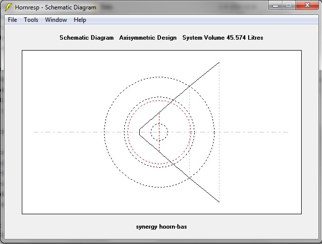

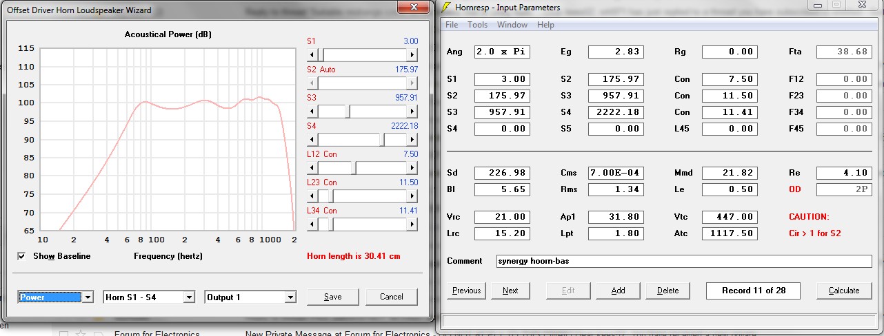

Hi
What concerns the serial or paralell conection of the woofers it is only the akabak where I did ask for how to node this.
I have not interesting in a three way box, but two way, the sim you see is with mid,s removed and the phillips x 2 woofer in stead of the big 12 inchers who are first.
The extension of the phillips woofers go above 1 khz and there I go put a tweeter not a CD.

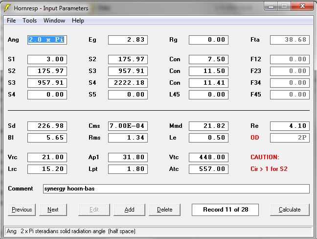

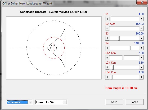

here are some sims from hornresp who can fine with conic flare horns, see the nice plot, but i still not understand the ATC well, this cross sectional in cm2 is 557 devided by two and 0.448 liters for the woofers who is X two.

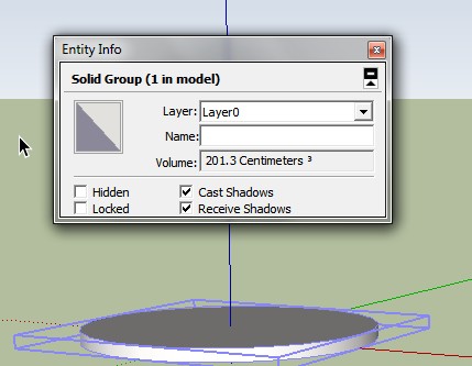

It looks so big when put that cut out circel in sketchup and calculate the square cm it is much lower then it is in hornresp, I do something whrong not now what it is, cc and cm2 on that place is confusing..
What concerns your design, I have to see how to make the horn first, the little visatons are a nice candidate, but I need to decide what I do now get to much at once confuse me, I ma afcourse a amp designer not box.
Hronresp input is from Mike Seddon, I have change some things for the plot, woofers going from 80 to 1100 hz. port is 7.5 cm from throat.
