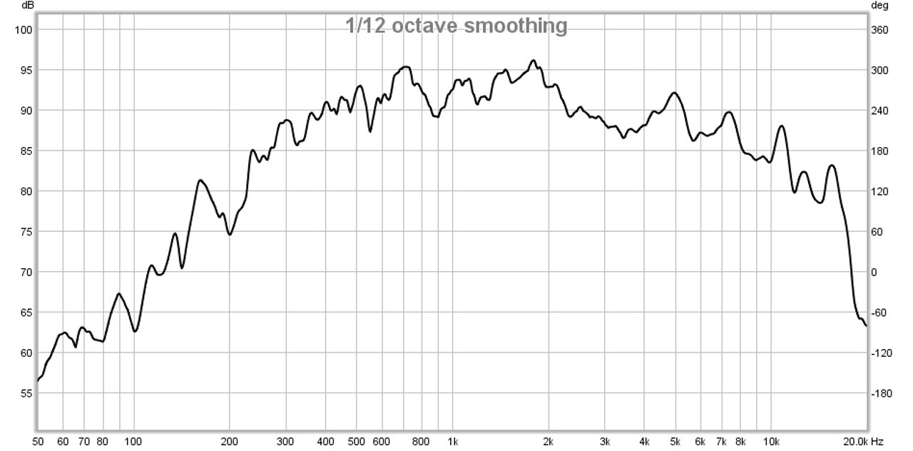

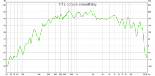

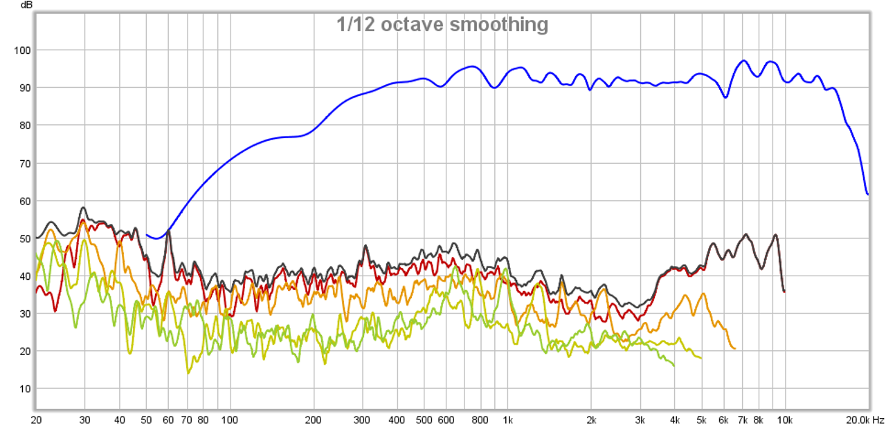

OB Data with higher resolution
Here is the data for the 5MR450NDY mounted in my OB setup (slot loaded OB) with 5 dB major tic increments.
0 deg:
attachment.php

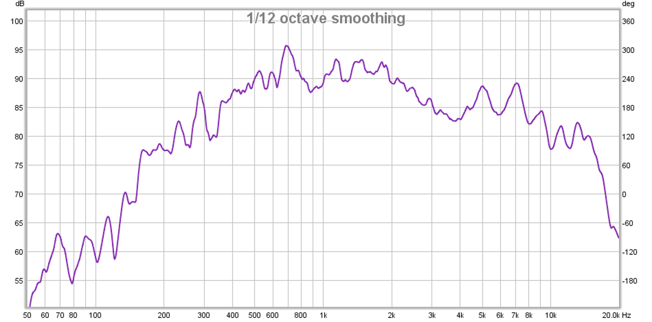

15 deg:
attachment.php

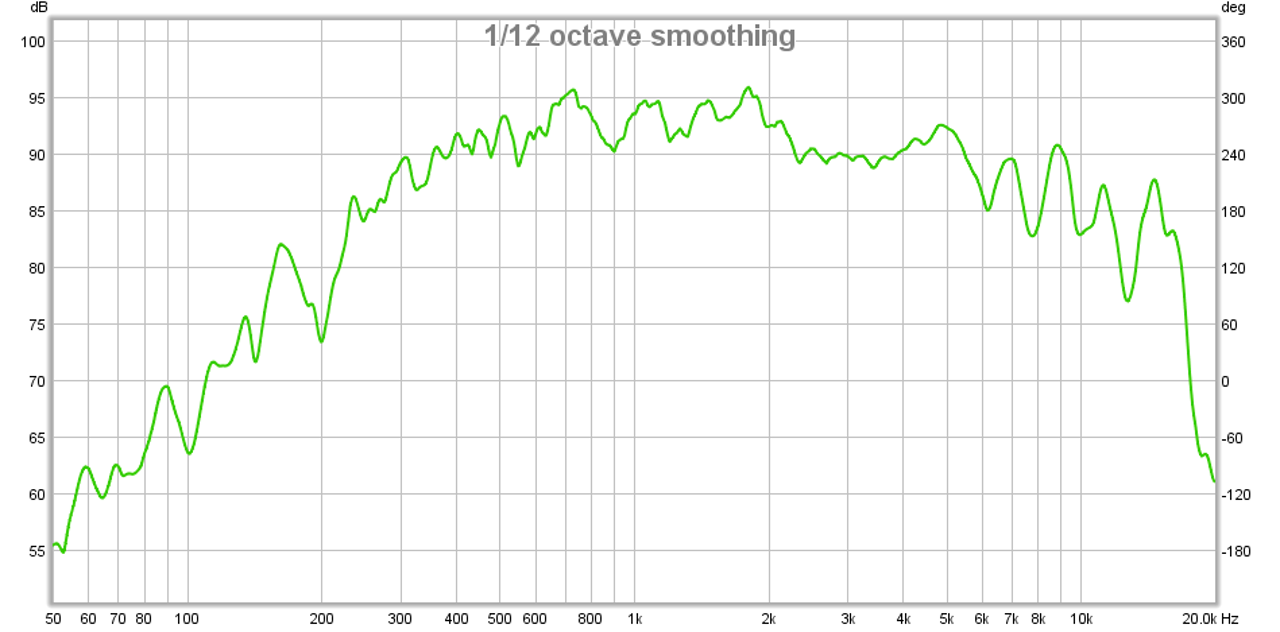

30 deg:
attachment.php

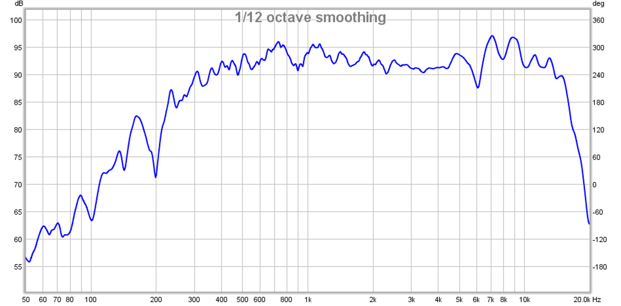

45 deg:
attachment.php

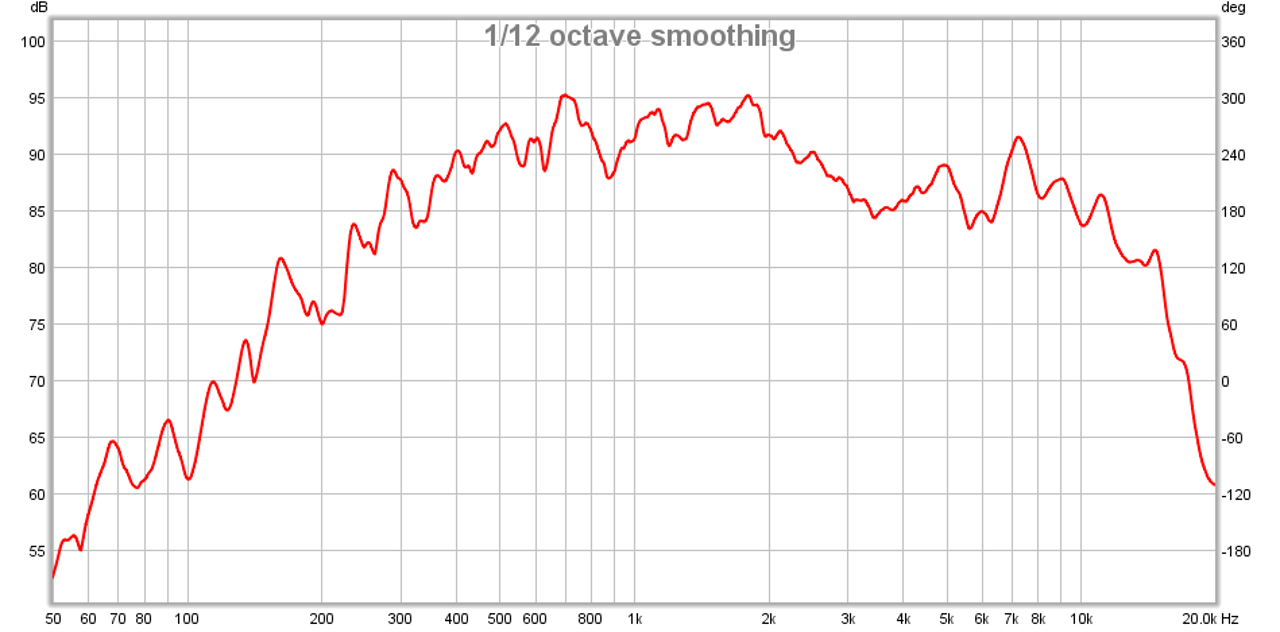

60 deg:
attachment.php

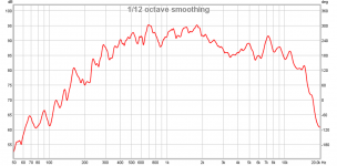

Here is the HD for the 0 deg case with a 10ms gate applied to remove near field reflections:
437413d1410151601-prv-5mr450-ndy-fast-applications-5mr450ndy-ob-0deg-hd-10ms-gate.png

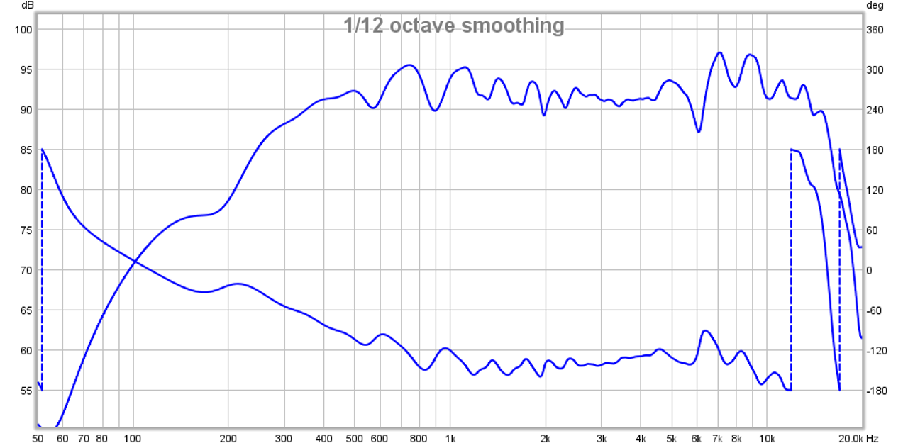

Measurement of this driver in the slot loaded OB (SLOB) http://www.diyaudio.com/forums/full-range/249984-cheap-fast-ob-literally-39.html#post3995444 using the Breeze Audio 2.1 class D TPA3116D2 amp with built in XO for sub and tops run fullrange (NEW TPA3116 50W+50W+100W 2.1 HIFI digital power amplifier HIFI beyond TPA3123 TDA2030 LM1875-in Amplifier from Electronics on Aliexpress.com | Alibaba Group). The perfect integration of the falloff at 340 Hz and the woofer channel was pure luck as the XO frequency on the amp is not adjustable - just relative gains. Anyhow, it measures pretty well given that this is raw with no DSP, no EQ. Straight from source to amp.
