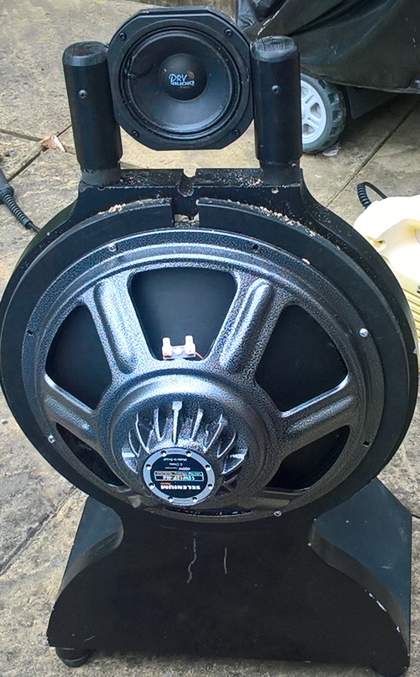

It was a handy way to use the Neos without the need for large baffle or frame and worked really well Also was a neat way of using my old baffles but chopped (used to have hawthorn duet)
I use Inuke to power the bass drivers
Crossover around 280 (active) Have a bit of bass lift around 200
Sounds fantastic having the PRV in free space just gives so much freedom to the sound
Lots of speed and detail with great scale and very powerful bass
Here a similar design Trans-Fi Audio - OB Speakers
Cool! Why isobaric on an OB? Usually isobaric is used to allow use of a smaller box volume as it cuts Vas in half.
How does it sound and what is XO point?
Isobaric OB is not teh best way, you need here volume, and that is halved.
best what I have seen is big 18 inchers in a dipole, still I do miss the sound of them, I do not now a horn and tapped horn will be better.
X I did thought about a constant directivity horn with bas injection ports? because conical do better with ports.
regards
I heard a few 18" open baffles and to be honest they both lacked a bit of agility in the bass. AE 18" and forget the other models but different rooms/different systems so lots of reasons
What 18" driver did you like
I did try the speakers With one 15" driver on top and the other on the bottom but this works better in my system and my friends system
It is not pretty though

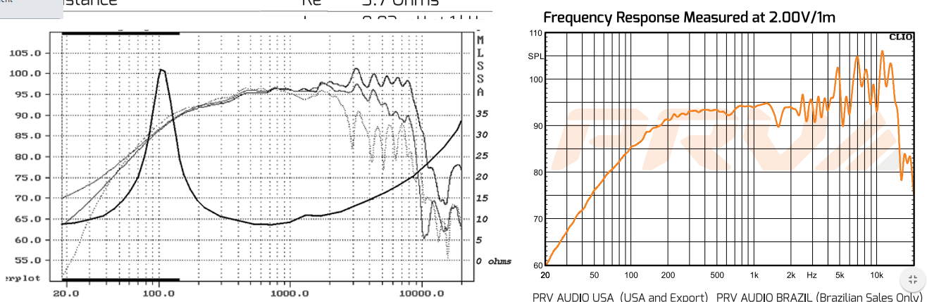

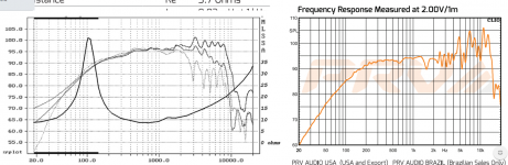

For
a) "high sensitivity, making it suitable for a low power (tube) amp"
b) avoiding "ear bleeding" treble
...if you were going to consider wide band units (300Hz - 6kHz or thereabouts), the Audax PR170M0 might be another option to look at. Slightly more efficient, and apparently a bit smoother than the PRV. The higher impedance could be a good thing with tube amps. Used in jillions of systems.
The only drawback I see is the 2cm increase in radius.
