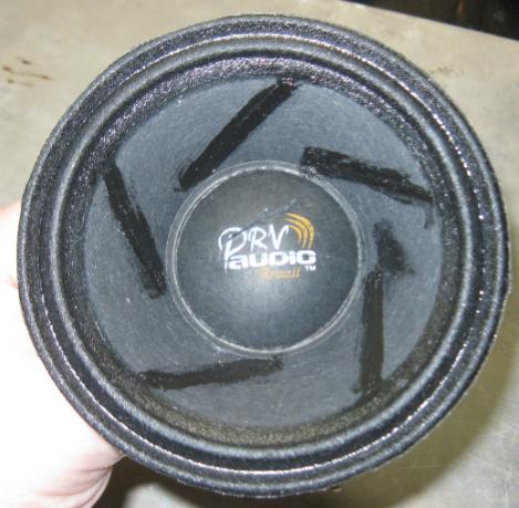

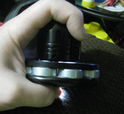

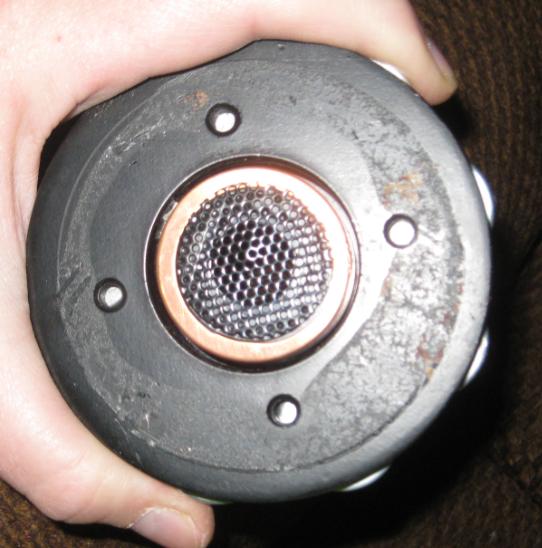

Thanks for the info, Wolf. Very interesting - do you have autopsy photos?
I could take some and post them, as this magnet is too pretty, fun, and strong to get rid of. What happened was during assembly, one NeFeB magnet was impacted by something that made it shatter on the outside. This had to have been before the spider was glued down, because the shards were inside the magnetic gap between the voice coil and the gap. I sent a measurement of the good and the bad unit, and they told me I could keep it. I did try and remove the bits, but they are actually too large to be maneuvered back through the gap and removed. I saw they had a recone kit, and that is why I attempted it. I also used the bad unit's cone for an experiment in the case I thought I'd need to attempt it later.

Here's the photos...
You can see the magnet particles NW of the center. The wrinkle due East is self inficted as I was trying to see how thick and far in the copper went. I pried with a screw-driver. Yes- I did slit the cone and apply adhesive black silicone for the damping and sealant- just to see if I could!
