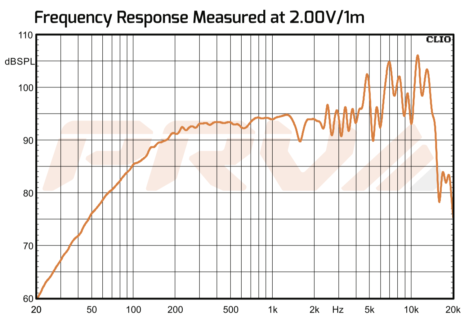

IIRC, it was 110dB to 115dB in a tractrix with a 30in wide mouth. A simple 1st order high pass set a little higher than the peak hump will probably equalize everything flat to 108dB or so.
that would be just about perfect. I may be getting some Audax mids just for sihpping and assume from the description (had foam surround but replaced with cloth) might be PR170 (?) - they just need new dustcaps and may work ok on the right horn

I might be off by 5dB, I think 105dB to 110dB. I know that a properly designed tractrix adds 10dB. If you start at 95dB it’s not hard to get 105dB. There is a 5dB (15dB total) overshoot at the low corner. I might have to retake the data again as my data was lost in a HD crash a while back. I do recall my ears ringing from sweeps since I did not wear earplugs.
Why pros don’t use this? Tradition I suppose - people seem to think a CD is louder. The PRV is very stiff in suspension and has a massive Nd magnet assembly. Putting it on a 30in wide tractrix isn’t something other people have really tried on this driver. In a way, you can think of this as a very large compression driver that can take 225w thermal. It could use a phase plug to get rid of those dips.

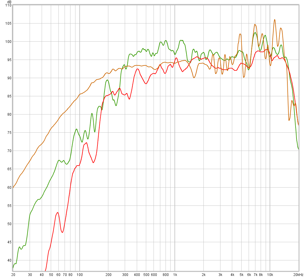

Sorry if you've already seen me mention this, but it seems that using a non symmetric throat works quite well for removing dips*.
e.g. use a 3:2 rectangle throat (rather than square), and ~randomly place a few big blobs of felt to partially fill the gap between the cone and mounting surface.
* the mention of phase plugs reminds me: I got several Scanspeak 15M/4624G for exactly this reason, but shipping delays were so huge that I'd moved on to another project by the time they arrived! I still haven't tried them on a horn. I should dust them off soon 🙂

I think it's worth listening to the 5MR450 driver, naked if needed, first to see if that peak in the treble is acceptable. For me it would be a no go but my ears are fussy that way.
