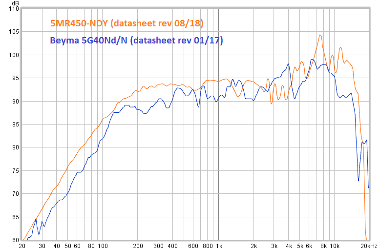

...On the other hand the beyma will be more controlled and goes higher in frequency...
Beyma list Le @1kHz 0,2mH and show impedance graphs, PRV in old datasheet never list Le and never show impedance graphs, where in new rev. they list a ultra low 0,03mH @1kHz.
...Scale not quite the same, but you get the gist........
Overlaid same scale and note latest rev of datasheet is used, the two resonse files is hanged on below as txt-file, rename to frd-file if that is needed.
Agree that is not optimal and wonder why.

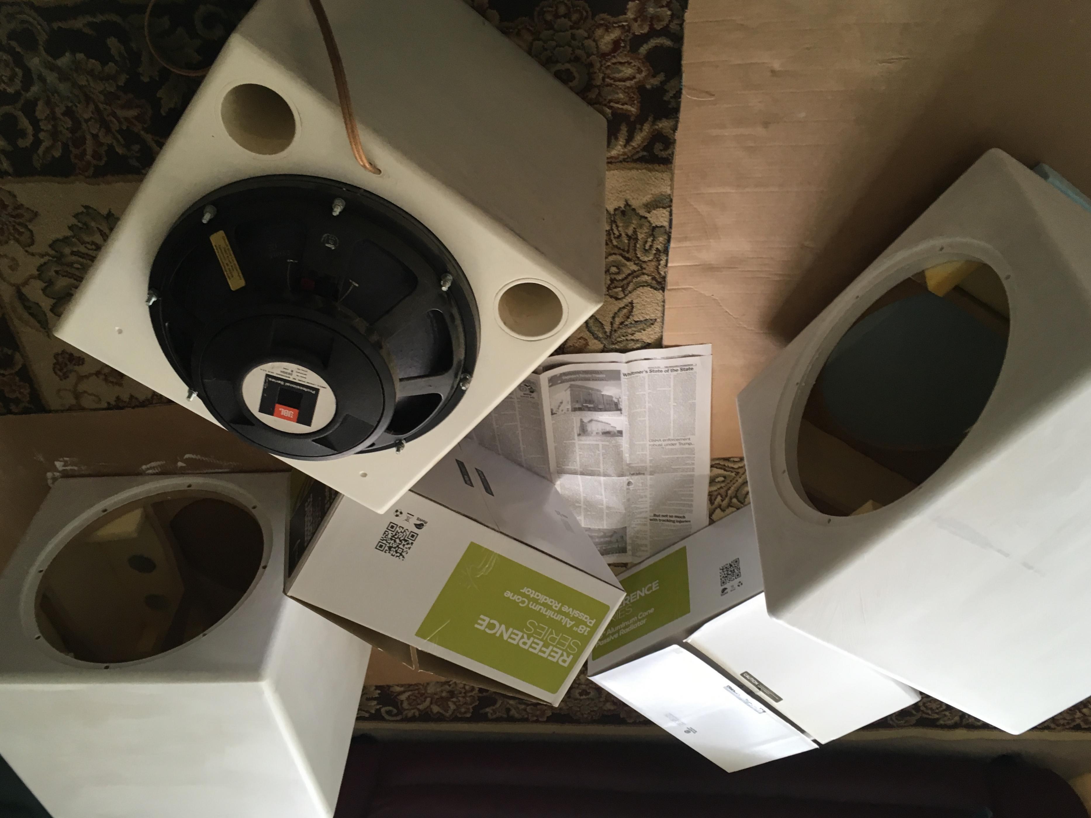

I’m getting closer on My project.
I purchased 4-PRVs and going to try one vs two.
I just put the first coat of paint on and in the process of divorcing My JBLs
They’ve served their purpose well but on their Own they will flourish!
Very soon I will get to experience the FAST awesomeness!
I want to like this driver, but the roller coaster ride starting at 2.5kHz seems quite wild.
That's when looking at the factory graph. Your measurements do not show such a wild ride, but just a small plateau at 6.5kHz.
I'll be hunting off axis measurements in your thread.

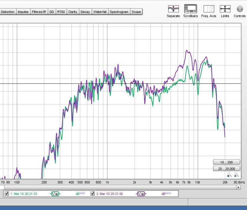

Some quick prototyping to tame that 7.5khz peak - a parallel filter of 0.12mH, 3.8uF (3.3 and 0.47 parallel) and about 35 ohms all in series with the driver - this is the 8 ohm version
The resistor can be varied to increase/decrease the peak
Preliminary listening shows that it has a slightly more bland presentation, but there is a loose connection somewhere in my setup, so maybe tomorrow i'll make a second filter set and listen to it in stereo
Thanks for sharing.
I don't think that driver is for me.
Maybe using DSP to flatten it a bit at 1.4kHz, and then take care of the wild ride 5kHz and up.
It doesn't sound as bad as it looks.. i'm pretty happy listening to them as is, but thought i might as well aim even higher. So far it's the best sounding wide range driver i've heard
I agree, I like smooth FR drivers too but this one is special. Off axis is not a problem and the benefit you get is immense clarity from the low distortion while play loud. Perfect for heavy metal or classical which demand high dynamic range, high peak SPL, and low distortion. Compare them to Fostex or Lowther responses. None of those can get this SPL though.
Thanks for sharing.
I should clarify.. the 1.4khz hump is probably from being on a large baffle. The measurement is just a quick one to show the filter
