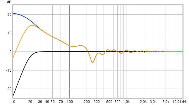

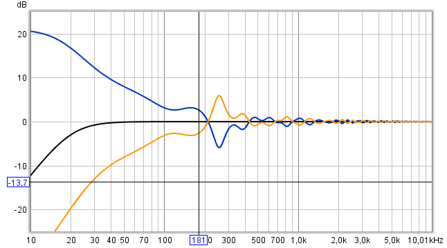

OK, I think I understand now, blue line is room gain
Orange is My target.
Recommendations are to achieve the black.
My room is 13’ wide 8’ tall 17’ deep.
Large openings on left side opening into dining room.

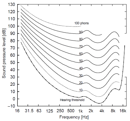

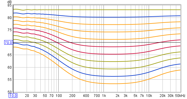

After digging into room response I’ve fallen down a path including;
Fletcher-Munson curves.

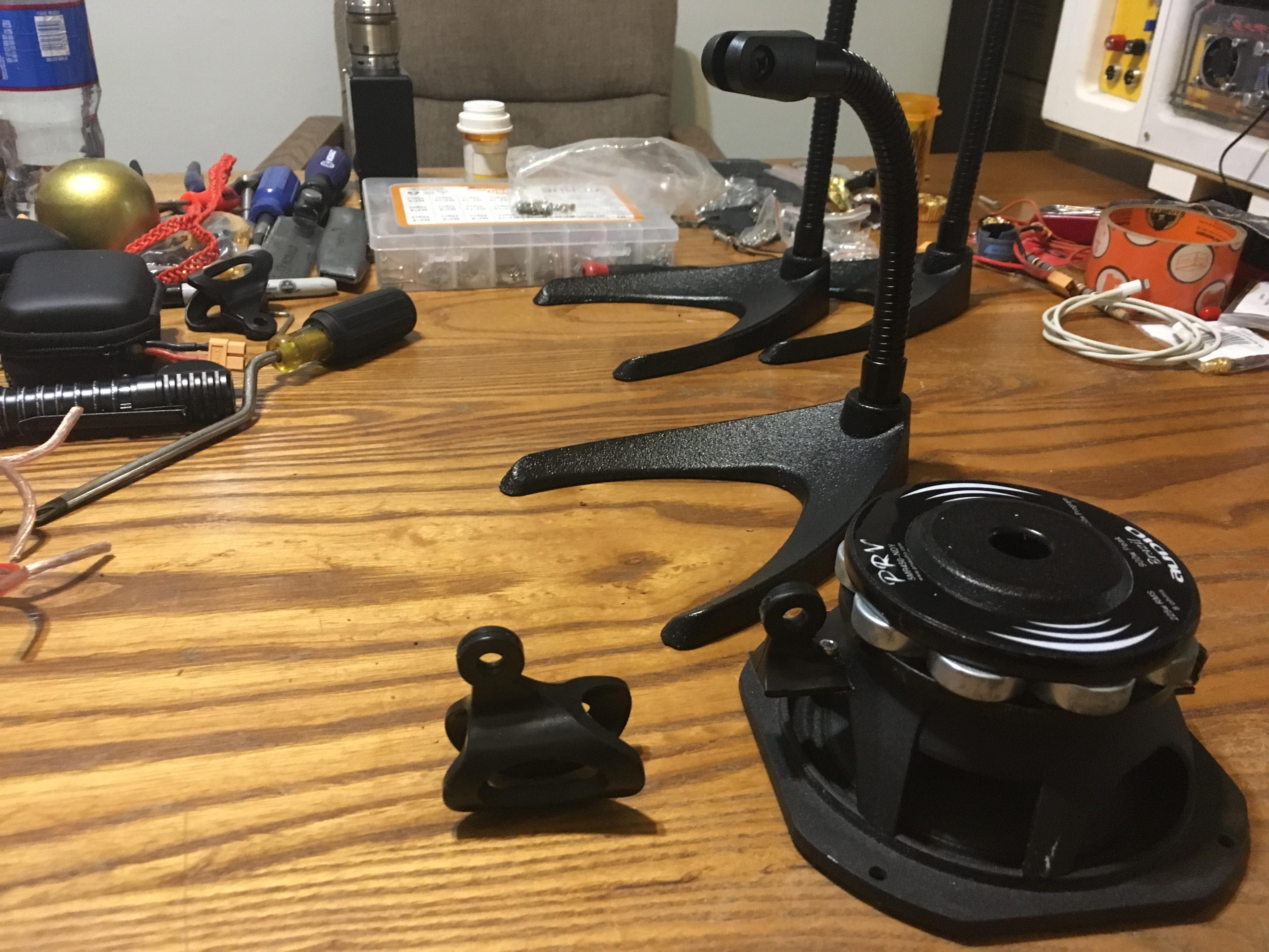

Upon closer inspection, I don't think the frames are the same. The PRV's cast aluminum bezel is a squared-off or truncated circle (like a large TC9FD), whereas the Beyma is a true pincushion bezel (with rounded sides - no flats anywhere). So I think we should stop comparing these like they were made by the same factory. The Le (at 1kHz) of the PRV is also 6.7x smaller than the Beyma.
Beyma pincushion:
PRV truncated circle:

Your most helpful information has sent Me down a rabbit hole of research.

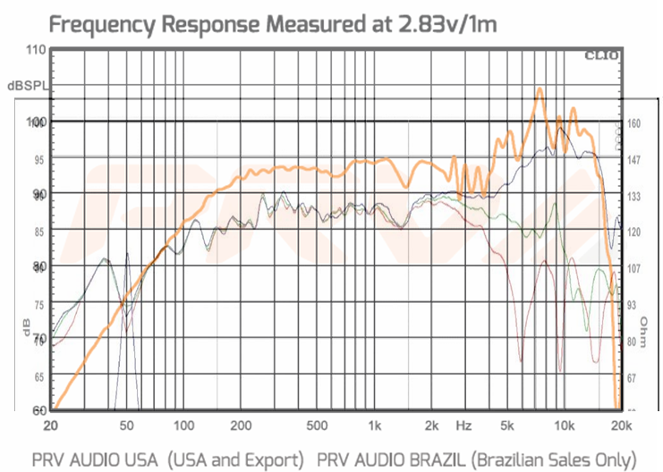

i just compared both of their MLS result and basicly they share same typical response. in real home audio usage, will the extra muscle from PRV has any advantage compared to more popular 5" like Satori or illuminator?
on the graph, orange is PRV and blue-green-red is from Satori

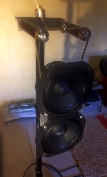

JBL/PRV functioning!

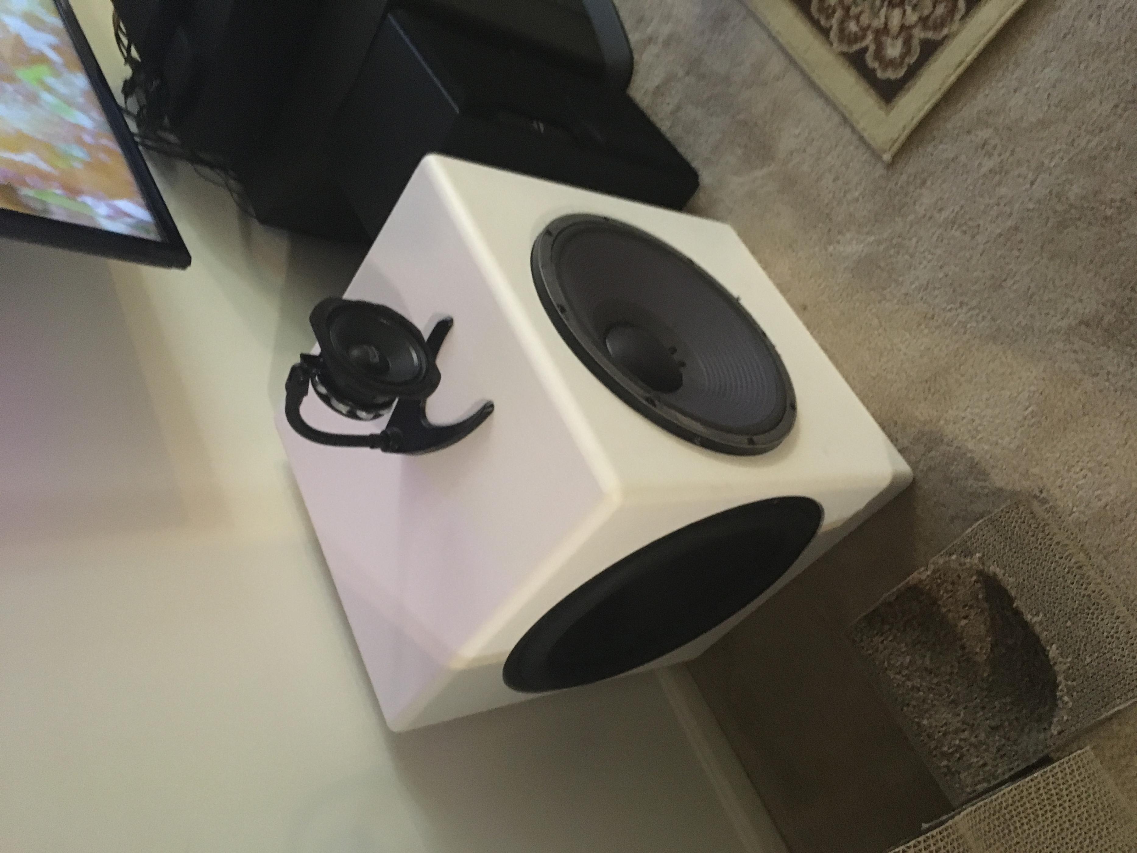

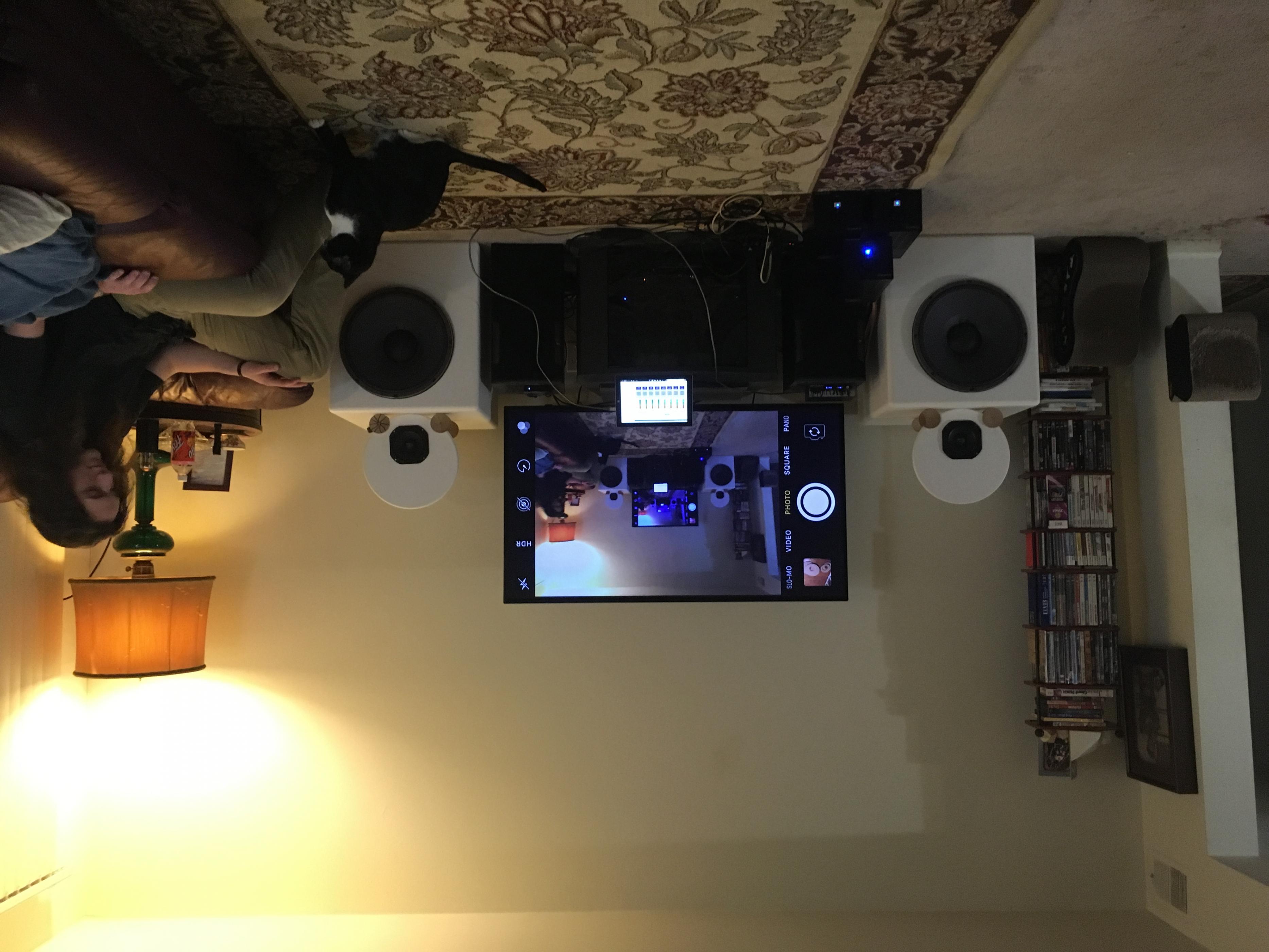

Progress report!
Woofers are complete, PRVs mounted in the baffles, temporarily wired up and functional.
I need to build some nice support stands for the PRVs to set in but for now this will work.
Using My theater Minidsp processor temporarily until the 2x4hd arrives.
A quick crossover at 500hz and setting the gains by ear “no equalization or adjustments for room” I’m hearing things in material I didn’t know existed!
The speakers completely disappeare audibly!
I’ve never experienced anything like this before and I’m awestruck!
Everything is effortless and the sound is as I’m in the room where the music is being recorded!
Tomorrow I intend to get My microphone out and adjust for room and get everything close to where it should be.
I have no idea how this will sound dialed in but one thing is certain, I’m currently in new territory for the most amazing, real sounding, audio reproduction.
I never quite understood “the speakers disappear” until now!
Thank You Everyone for being a part of this journey!
Thank You for Your help and posting discussions as I’ve learned much and benefiting in ways I never knew were possible.

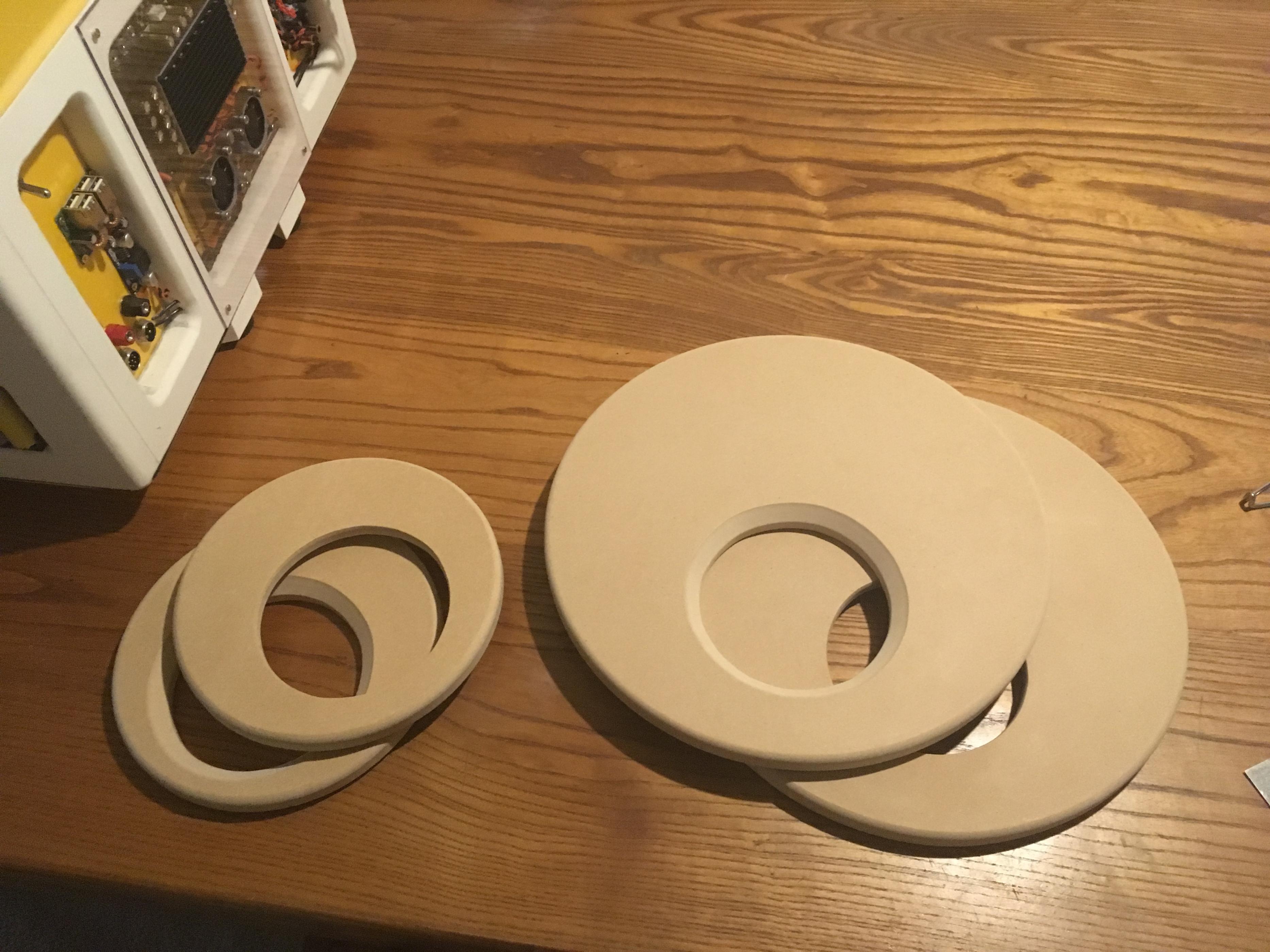

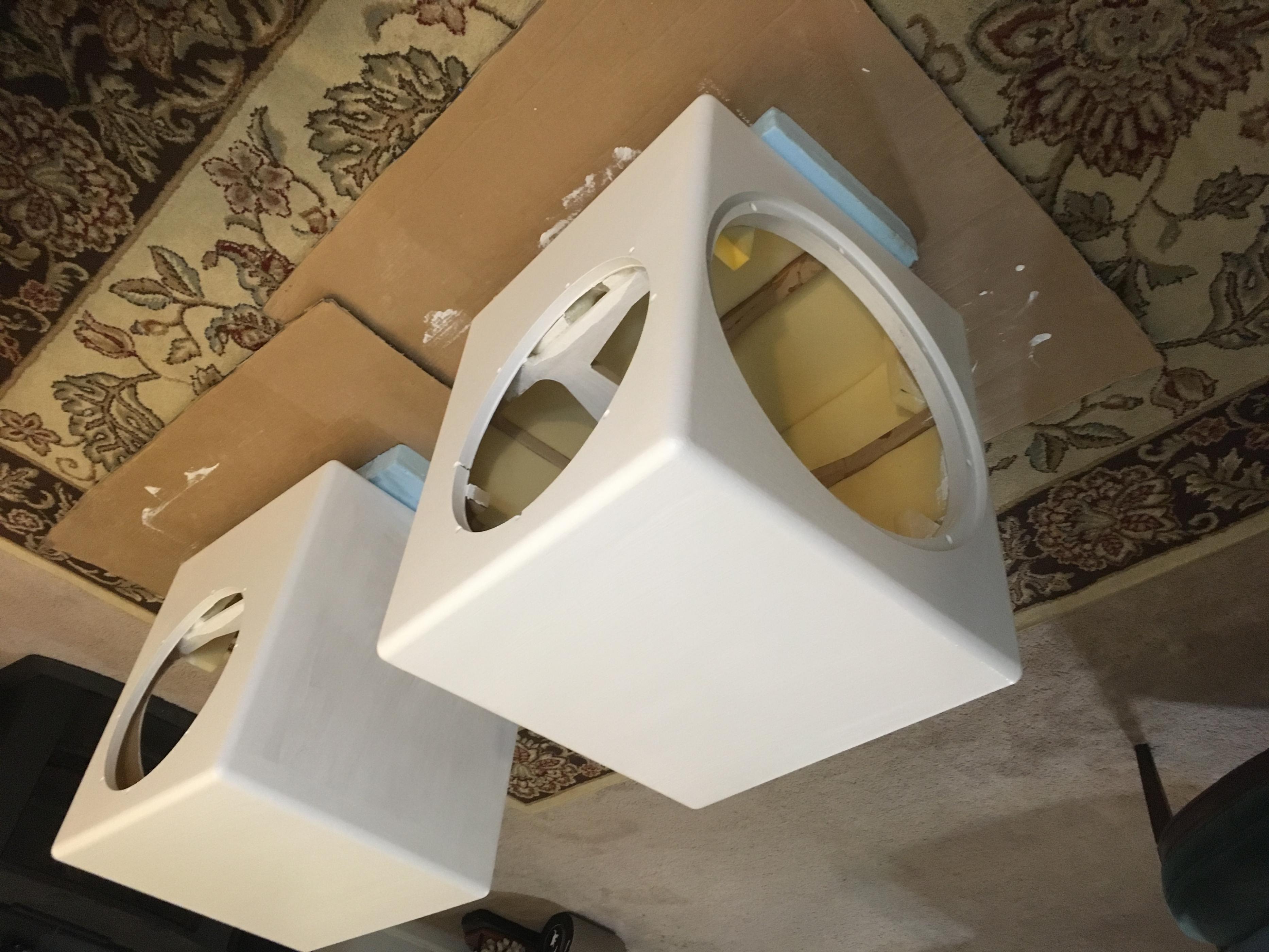

I’m at 50% photos posting right side up...
Perhaps one day I’ll get this figured out.
Once dialed in, I’ll play around with baffle shapes and see their effects.
The bit of research I’ve done, My thinking these should be decent for My higher crossover point.
Having the drivers offset on a circle should eliminate the edge diffraction being the edge is continually changing length from the source?
Does this make sense?
Thoughts?
Thoughts?
Thoughts?
Personally, I would get rid of the baffle which just colours the sound and disrupts imaging . With FAST application you dont need to worry about bass loss.
With a suspended type arrangement, you could still place the PRV's on the Bass cabinet and isolate from vibrations, which would be severe.
Nice work JeffreyAmes. I like the plain white cabinet look.
A circle with offset is good from diffraction standpoint, but probably not as good as a trapezoid or a Fibonacci spiral as those are more asymmetric, whereas there is a diametric symmetry on an offset circle - but probably fine. Definitely better than a symmetric concentric circle - the worst baffle shape from diffraction standpoint. It looks great though.
That’s great that it sounds good out of the box without any microphone measurements. If you are looking g for a good mic, Cross Speectum Labs sells third party calibrated UMIK-1 for $105.
Progress report;
I picked up some little table top microphone stands on clearance at parts Express, I really wanted to showcase the magnetic structure on these drivers.
I’m VERY pleased with this no baffle look!
I’ll probably try the smaller circles on the other stands to see how they look as well.
The microphone stands were only $9.00 USD each!
XRK; I do Own the Minidsp microphone for measuring, today My new Minidsp 2x4HD arrived so I’ll be getting some measurements soon as all is hooked up!
I only needed to cut up the microphone holder to form a bracket, then drill a hole for a M3 screw, the unused termination tab on the opposite side is tapped for the M3, I might use a drop of lock tight and or add a nut later.
This system is very close to completion!
Just in time for My kids spring break!
