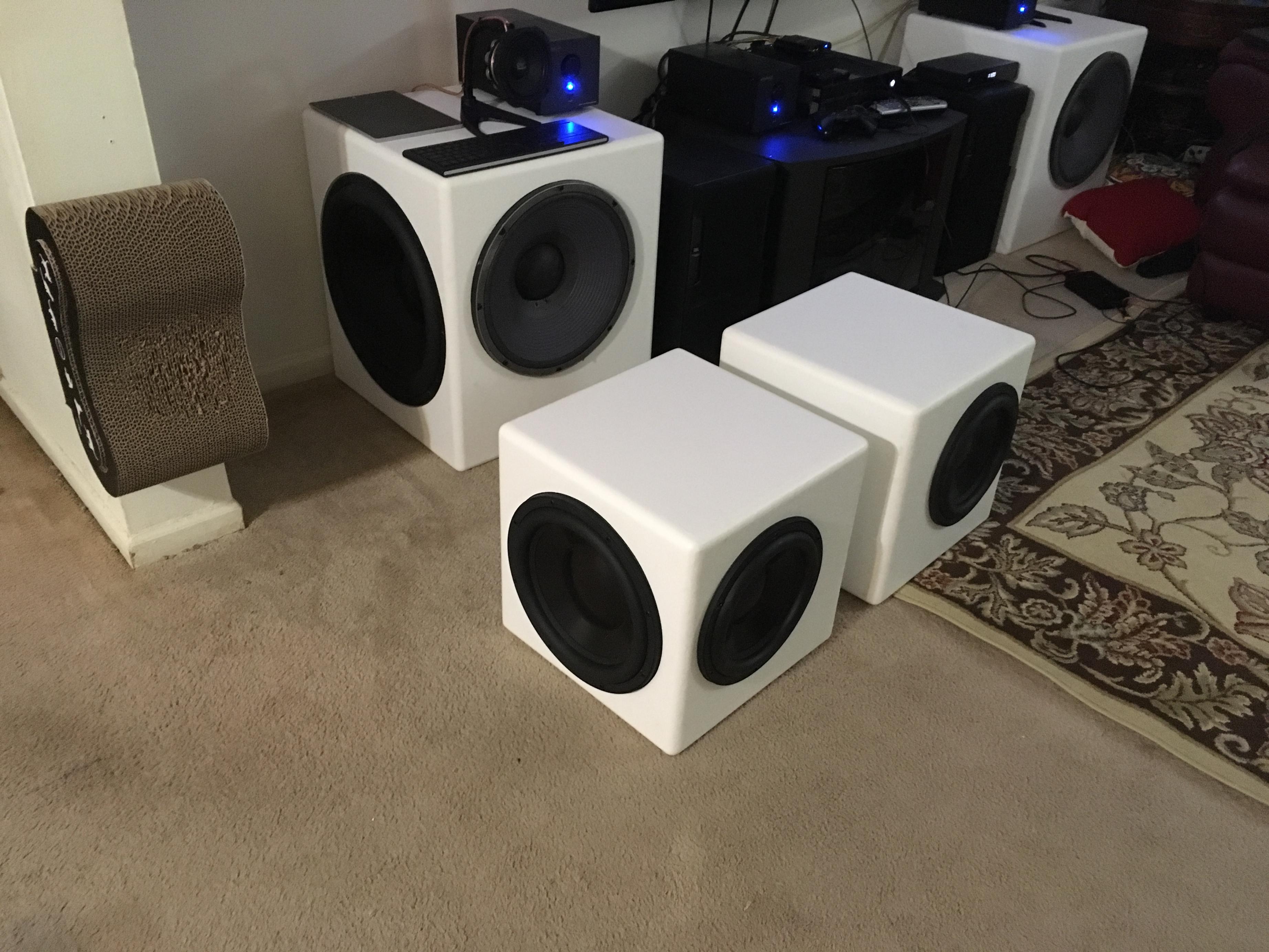

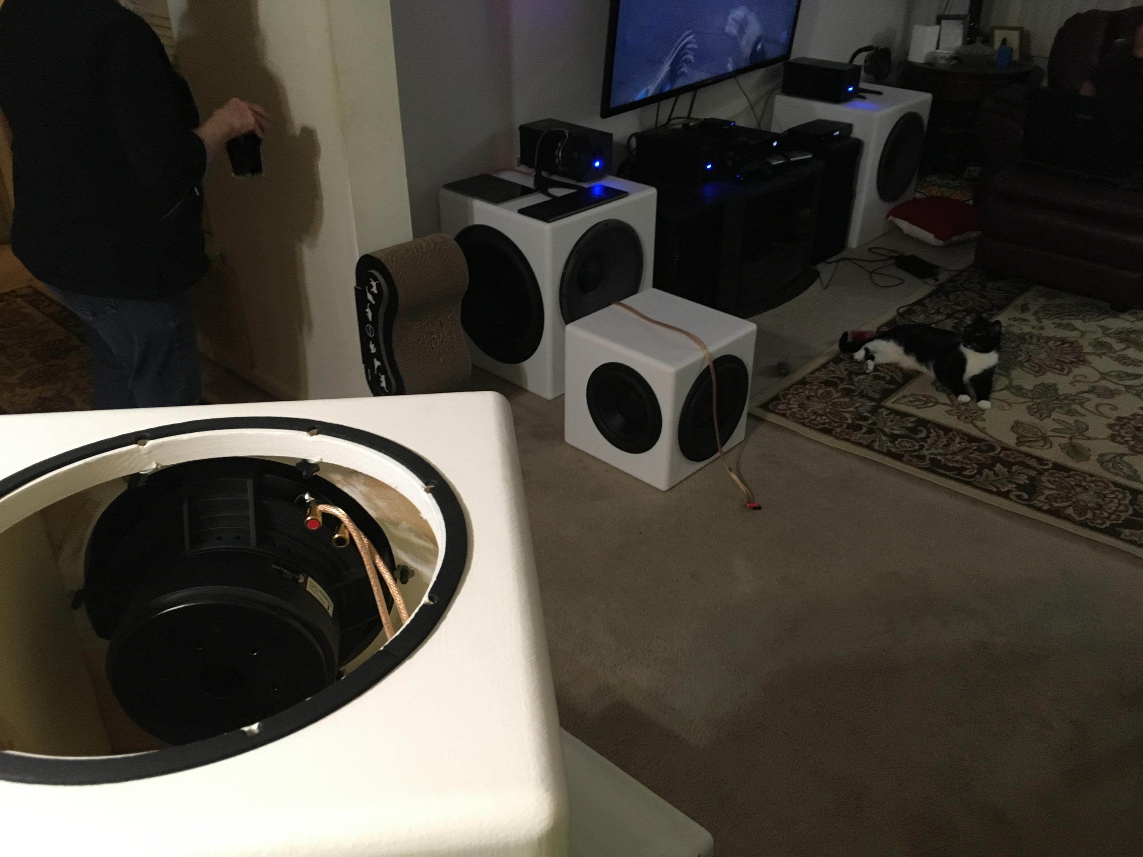

Today I finished My Mini versions of My JBL woofers!
I’m using the Minidsp avr hda as a preamp “currently in Hong Kong being repaired” I still need to mount the PRVs to the microphone stands and chose an amplifier to use.
Fun little bedroom system!
I also have 2-Buttkicker LFE tactile transducers bolted to My bed for that extra little something something!
For the love of audio is there ever enough?
Currently using the boombox I built till the Minidsp returns.
Honestly the boombox with tactile transducers are more than plenty but I like building stuffs.
Sorry about the rant, I’m very excited that I’ve finished another set of woofer enclosures and looking forward to having this sound in My bedroom!
5yrs ago I had a spinal fusion surgery gone wrong leaving Me disabled, these are HUGE accomplishments for Me and priceless time spent with My Sons building memories!

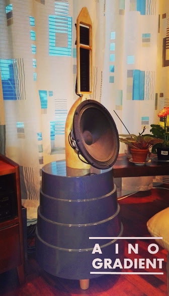

boxed subwoofer to prv only? I'm not sure how the midbass integration but i will suggest additional woofer and use lower filter for the boxed subwoofer like Aino Gradient project
Aino gradient - a collaborative speaker project
this was also my interest but decided just build separate sealed subwoofer and keep all OB design
