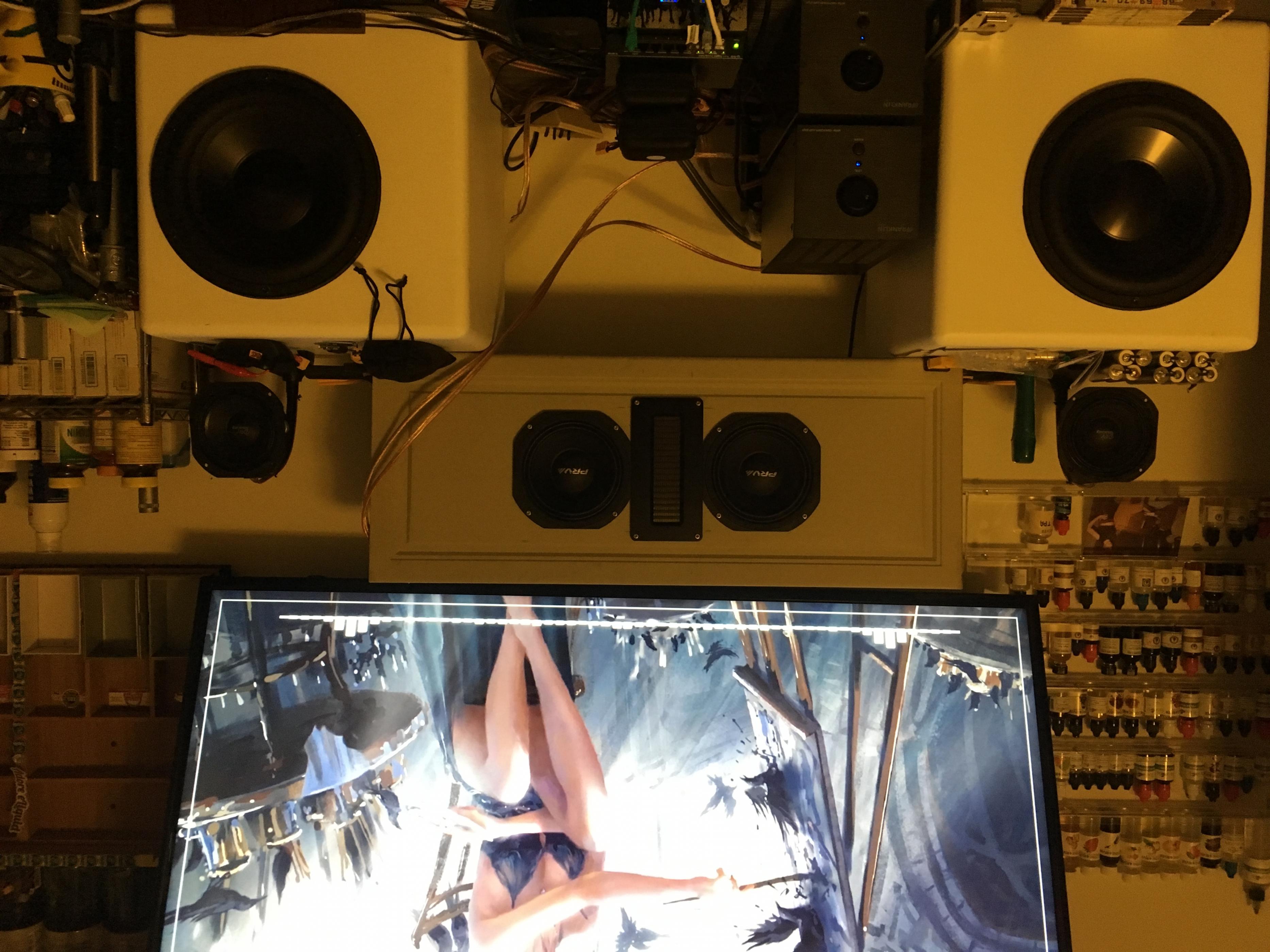

Hello fellas!
I ordered some tweeters to play with;
Dayton Audio AMTPRO-4 Air Motion Transformer Tweeter 4 Ohm
I also ordered two prv-6mr500 drivers to create a center channel using the tweeter in the middle.
My thoughts are to have the left and right speakers 450 tweeter 450 all vertical and the center 500 tweeter 500 horizontal with the tweeter in the upright position.
I’m using DSP for crossover and equalization, My thoughts are to overlap the drivers so similar to a line array but use a high shelf for one and low shelf for the other where both are covering the same frequency.
*What do You think?
*Is My idea crazy?
One more question;
*How big a baffle would I need to be usable down to 300hz with the prv450s?
Surly there’s a calculator somewhere?

The centre speaker laid out horizontally was only for commercial purposes to fit under a TV screen in most households, and was not optimal.
If you can, keep the same vertical arrangement for the centre speaker, as with your R / L speakers.

That makes sense!
I’ve been playing with expanded PVC and polyethylene sheet as well, both materials cut well with a router.
The expanded PVC can be heated and formed, perhaps curving the baffle like I see in high dollar line arrays...
First things first... FOAM-CORE and listening!
I created a test baffle with an old cabinet door just to see how the drivers perform in this arrangement.
ABSOLUTELY HORRIBLY!!!
I expected the tweeter to have a narrow vertical pattern but with the MR6-500s on the sides they destroy the horizontal as well.
There’s no need to get a microphone out, the 6” versions of the PRVs are completely different animals and absolutely require a tweeter above them.
I have My heart set on using the AMT tweeters, I just need to find the best combination to implement them.
I wish the horn and baffle computer programs weren’t so confusing, I could probably eliminate a lot of cutting/testing.

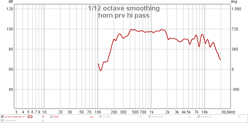

It has been some months when i've build my PRV horns but this weekend I had the chance to take everything outside and get some measurements.
There is one wooden surface that could reflect some things but it is on the side at a few meters distance so the mausurements altough not perfect can still be used.
The microphone is calibrated at the spot using a calibrator so the dB values are correct.
I however didn't measure the voltage going to the speaker.
So first the raw response of the horn loaded PRV 5MR450 with a wooden tractrix horn, Hi pass at around 200Hz
at around 2kHz it dips a few dB but doesn't really drop off.

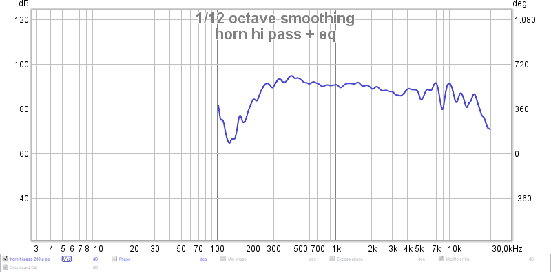

So after a little bit of EQ this was the result.
The HP is at 200Hz where some 15" folded horns take the rest
Didn't EQ the high end ripple so it's not perfect but it goes from 200Hz to around 15kHz.....
Last but not least here is the prv horn in combination with the 15" folded horn after time alignement was adjusted.
Doesn't look to bad I think

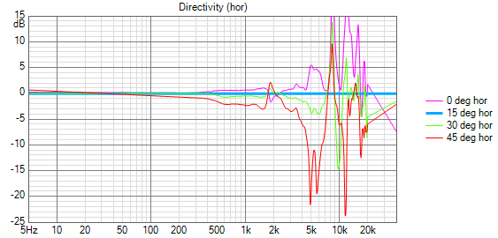

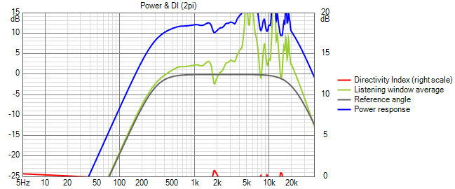

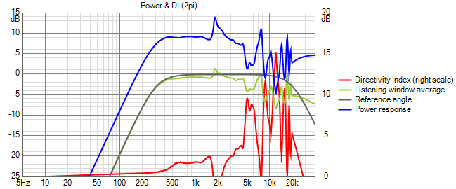

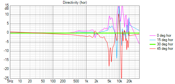

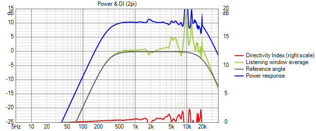

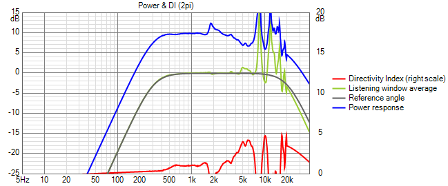

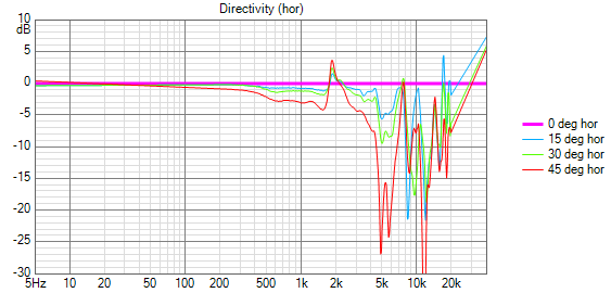

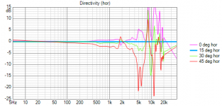

For interested xrk971 in past shared impulse response and 0/15/30/45 degree axis on a trapezoidal baffle and Nautaloss rear chamber over here: https://www.diyaudio.com/forums/ful...n-4in-class-range-drivers-21.html#post4234001.
Why i guess xrk971 is right about horn loading helps improve tweeter band is seen below using those 0/15/30/45 degree axis from above link into simulation using free VituixCad.
In below 5MR450-NDY at 0 degree axis is EQed smooth as a pancake for a 300-20000Hz BW2 bandpass seen as the grey curve, design axis (listening window) is at 0 deg and we could hope for we listen to some delicate smooth response but sadly forget about that dream other than near field on design axis because look at the mess at the other three curves, a less diameter driver or real tweeter will help improve tweeter band and run over 5MR450 used as direct radiator tweeter or use a horn solution as xrk971 talked about to smooth out that tweeter band area.
Here is normalized view for above 0 degree as design axis.

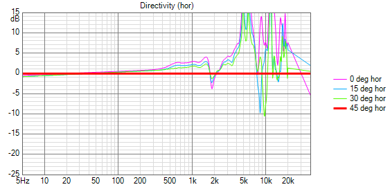

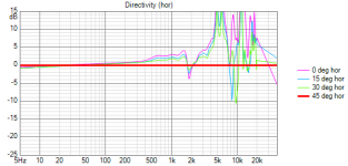

5MR450-NDY at 15 degree axis is EQed smooth as a pancake for a 300-20000Hz BW2 bandpass seen as the grey curve, design axis (listening window) is at 15 deg and we could hope for we listen to some delicate smooth response but sadly forget about that dream other than near field on design axis because look at the mess at the other three curves, a less diameter driver or real tweeter will help improve tweeter band and run over 5MR450 used as direct radiator tweeter or use a horn solution as xrk971 talked about to smooth out that tweeter band area.
Here is normalized view for above 15 degree as design axis.
5MR450-NDY at 30 degree axis is EQed smooth as a pancake for a 300-20000Hz BW2 bandpass seen as the grey curve, design axis (listening window) is at 30 deg and we could hope for we listen to some delicate smooth response but sadly forget about that dream other than near field on design axis because look at the mess at the other three curves, a less diameter driver or real tweeter will help improve tweeter band and run over 5MR450 used as direct radiator tweeter or use a horn solution as xrk971 talked about to smooth out that tweeter band area.
Here is normalized view for above 30 degree as design axis.
5MR450-NDY at 45 degree axis is EQed smooth as a pancake for a 300-20000Hz BW2 bandpass seen as the grey curve, design axis (listening window) is at 45 deg and we could hope for we listen to some delicate smooth response but sadly forget about that dream other than near field on design axis because look at the mess at the other three curves, a less diameter driver or real tweeter will help improve tweeter band and run over 5MR450 used as direct radiator tweeter or use a horn solution as xrk971 talked about to smooth out that tweeter band area.
Here is normalized view for above 45 degree as design axis.

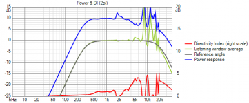

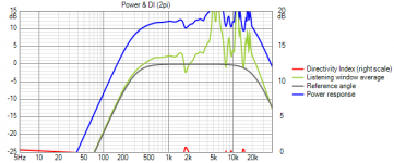

Thanks for those simulations, Byrtt. I think they match the hash we see in the measurement a near 10k. But as I recall, it doesn’t sound too bad in reality. Sounds quite nice actually and probably not as rough as the simulations are predicting.
