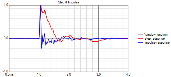

Probably you right about the 10k hash in that here is IR/SR (48kHz rate) prediction for 0 deg axis trapezoidal baffle and Nautaloss rear chamber from that previous link:

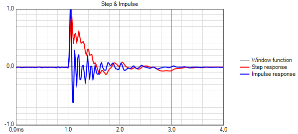

Same trapezoidal baffle and Nautaloss rear chamber but a sum of the four axis at 0/15/30/45 deg:

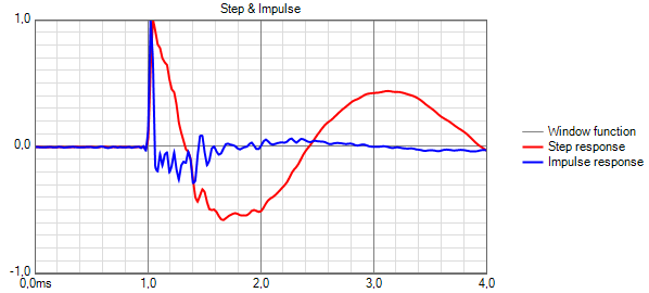

And here is IR/SR (48kHz rate) prediction for member Vintage Audio Projec's 5MR450-NDY horn bandpass named "horn hi pass + EQ" (blue curve), and it seems have similarities to above sum of 0/15/30/45 deg axis:
Now i don't know if your sound conclusion is based on 5MR450-NDY as direct raditor on trapezoidal baffle and Nautaloss rear chamber or 5MR450-NDY tractrix horn loaded, but think that post 538 visual analysis is educating pointer to look for clues of direct sound verse later reflections from room/enviroment mix because there looks be non ideal flaws up there in tweeter band teritory.

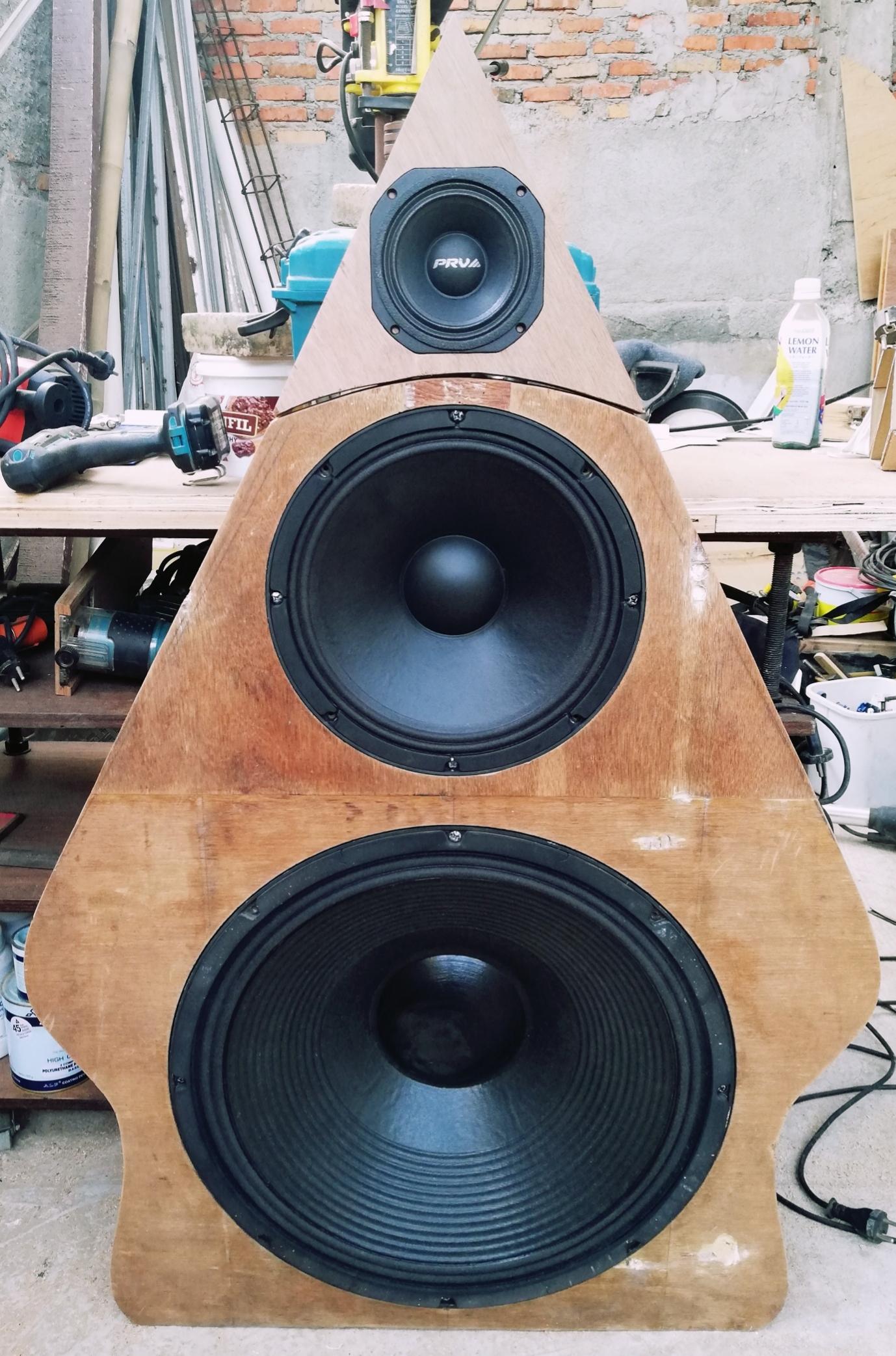

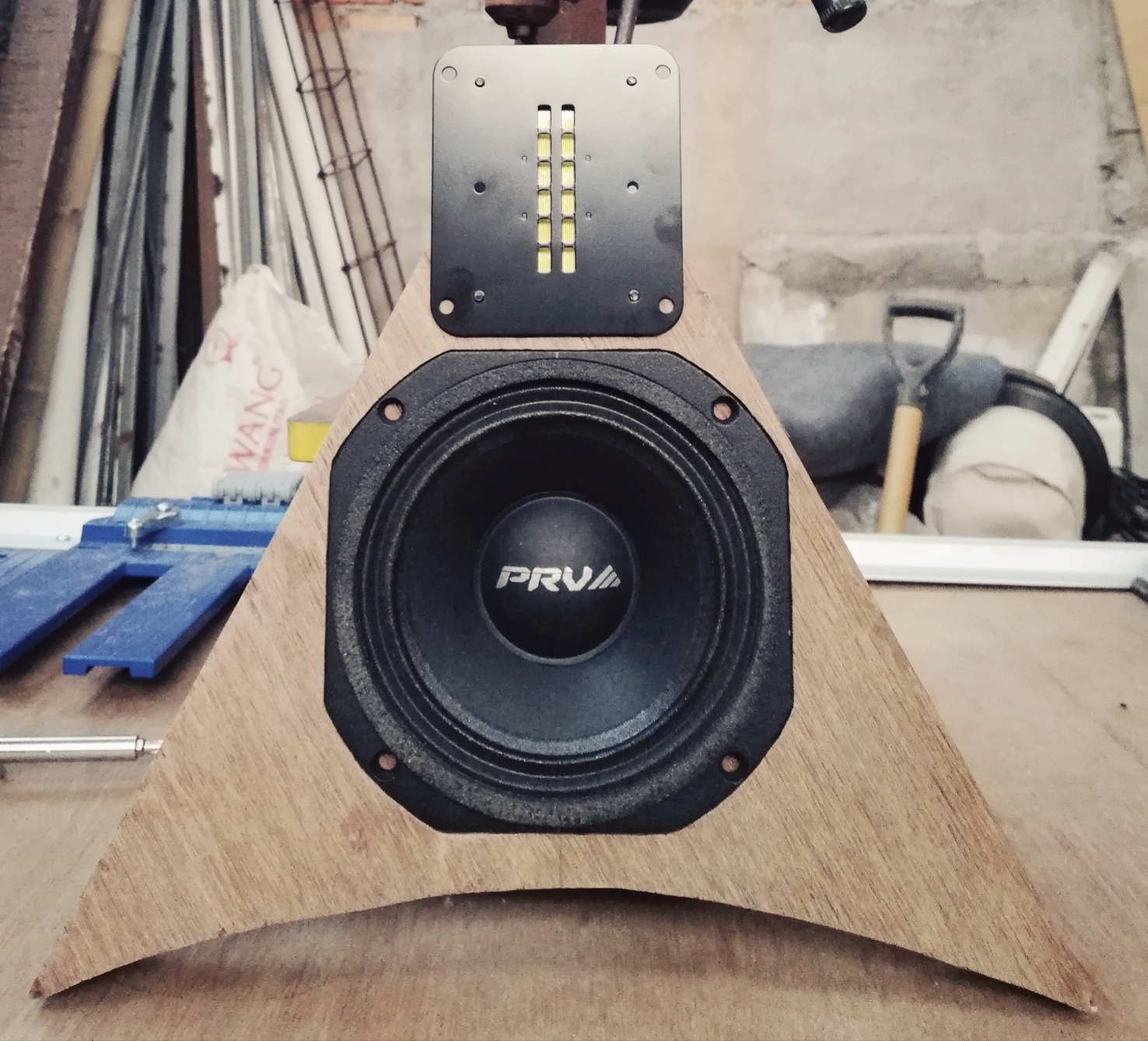

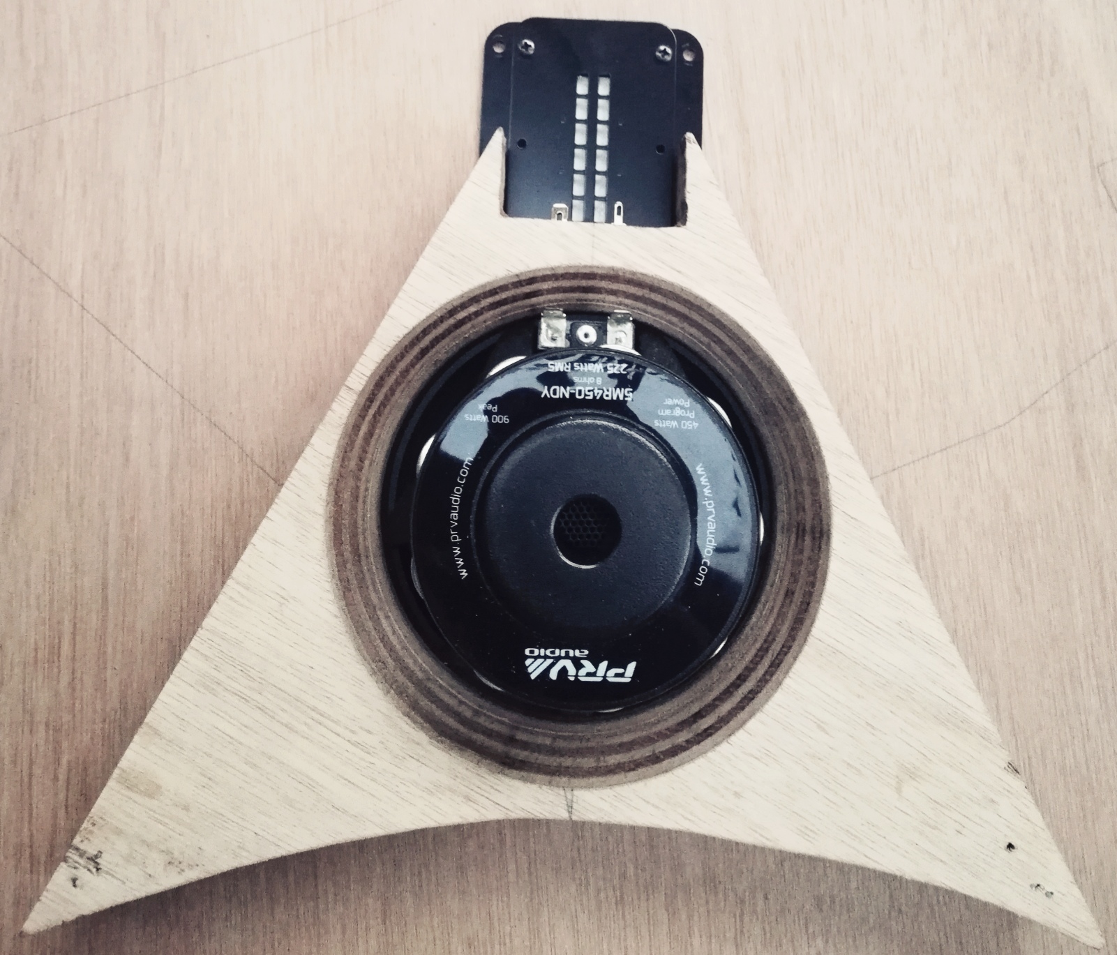

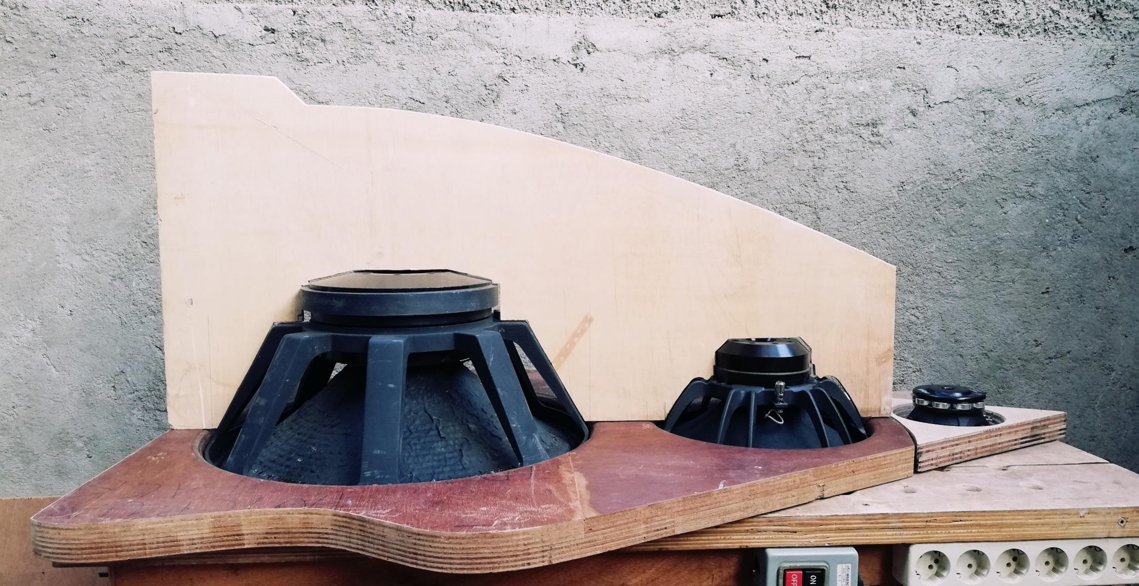

just a glimpse of my 3 way active OB with an influence from kyron kronos but using the shape of my local culture, all pro audio drivers. the hardest part of basket routing shape of bigger driver are completed, I'm a little OCD to match basket curve 🙂 for PRV i might just use egg curved shape to reduce air blocking.
PRV baffle is separated from below baffle to avoid any vibration, the baffles will be glued + screw enforcement.
hopefully they will slam in my house 😀

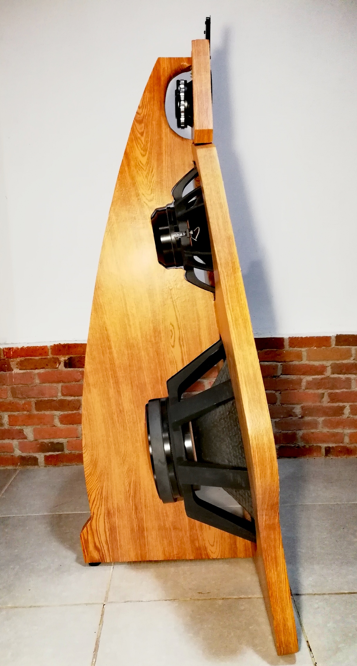

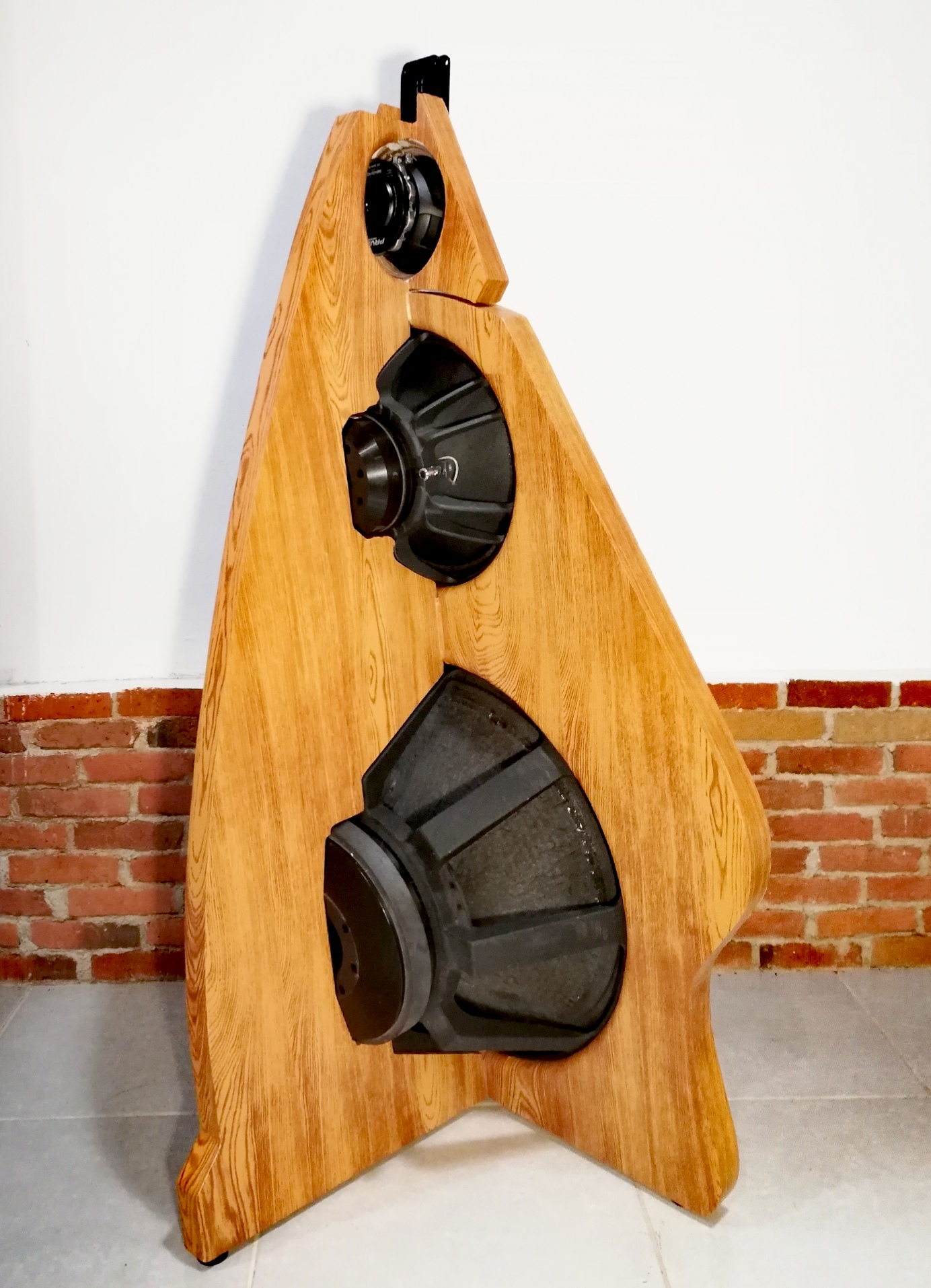

spare some time for my hobby, from my previous plan to make 3 way (nu3000dsp + minidsp 2x4hd) become 4 way and i need to get another minidsp. I'm using beston rt002-dipole with removed waveguide as super tweeter

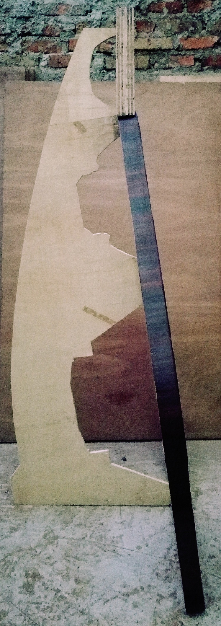

back support template completed, will be followed by cutting 2 layers plywood of 18mm
Very impressive setup this will be, Gadut. Why don’t you get a 2x8 DSP? I have run two independent 2x4’s and that works too but have to program it twice.
Check out Analog Devices ADAU1452 eval board. $250 I know but very powerful SigmaDSP studio software and FIR capability. Plus you can add your own I2S input or output.
I had plan to use nanosharc and build my own multichannel dac but then it's too complicated for me. I decided to build 4 channel monoblock amplifier and put each 2x4HD on each amplifier box
i chose HD version due to standard 2V output, lower noise and better parts used compared non HD version. FIR is a nice feature but not my priority because i will start with Harch xo. i think duplicating config file 2x is simpler than playing with dsp encoding + i2s 😀
i'm more to hardware man instead of software, i might still cut plywood in the next 2yrs building speaker set and room treatment

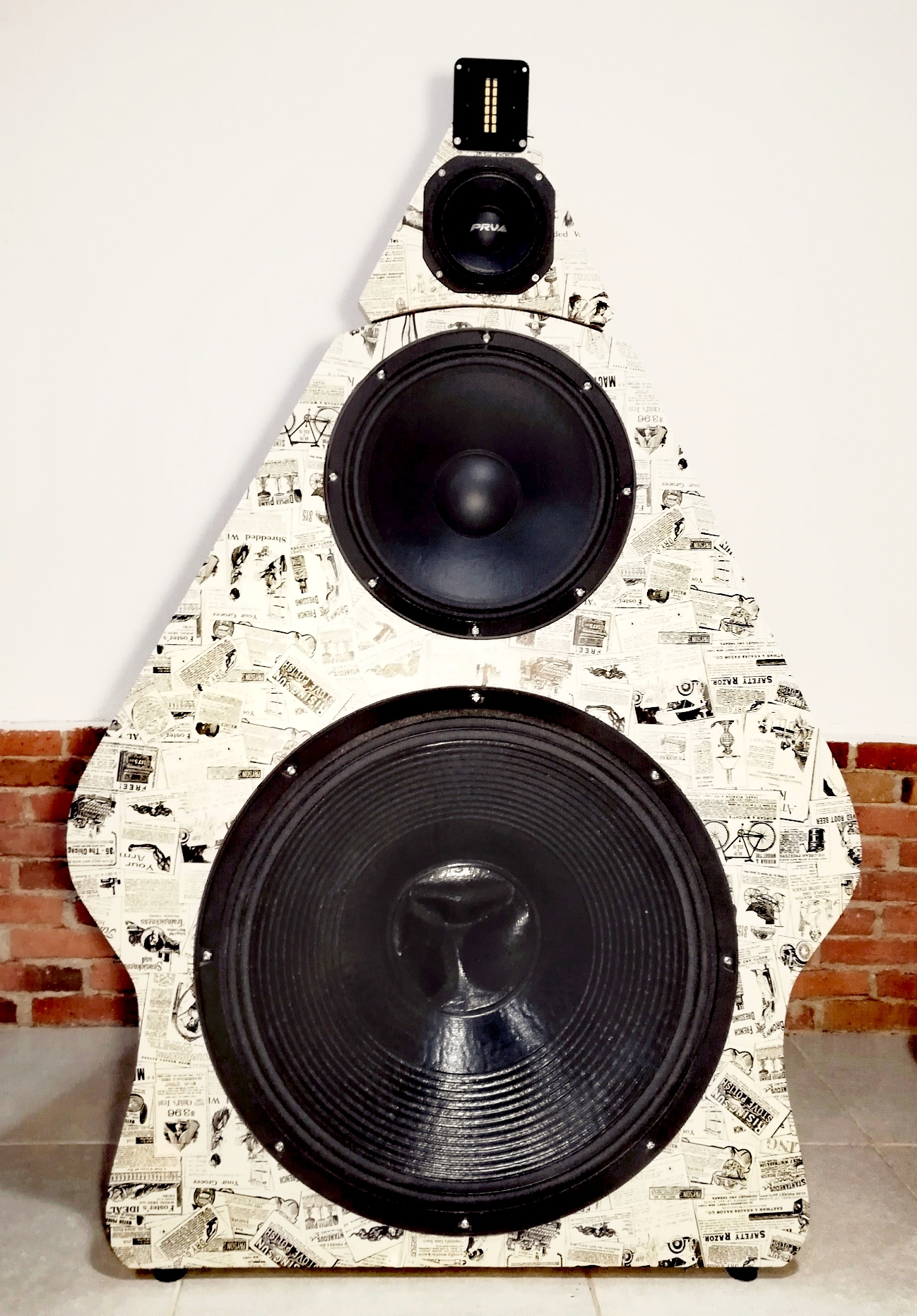

2nd set of minidsp 2x4hd arrived and 1 side baffle is completed. I'm ordering class d amplifier D4K5 with 90Vdc supply for subwoofer and apex B500tef for woofer.
since PRV has power rating, i might try b500tef just in case it matches with good class AB or A

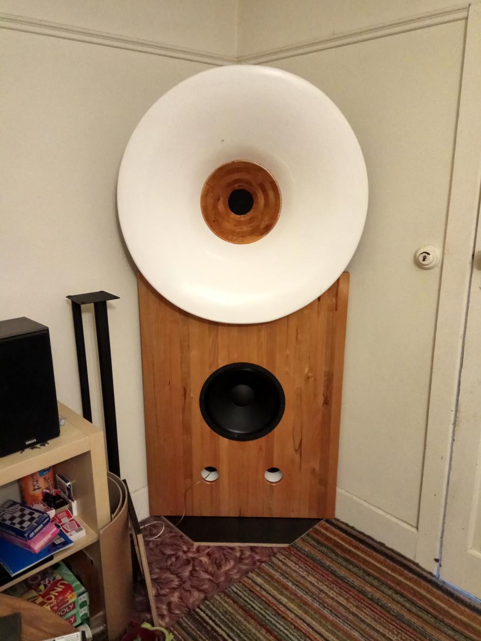

I had the PRV drivers for about a year now and love what they do.
I recently blew a driver and ordering two replacement drivers to the UK was proving to be very expensive so Vic suggested I go for the Beyma Beyma 5G40Nd
I only had them playing for a day but I am pretty impressed. In my set up they extend better and the sound is a bit more natural. I am needing a bit more support from the bass more but this will probably improve as the system burns in
For those of us in the UK, it is a good alternative to the PRV for FAST applications
