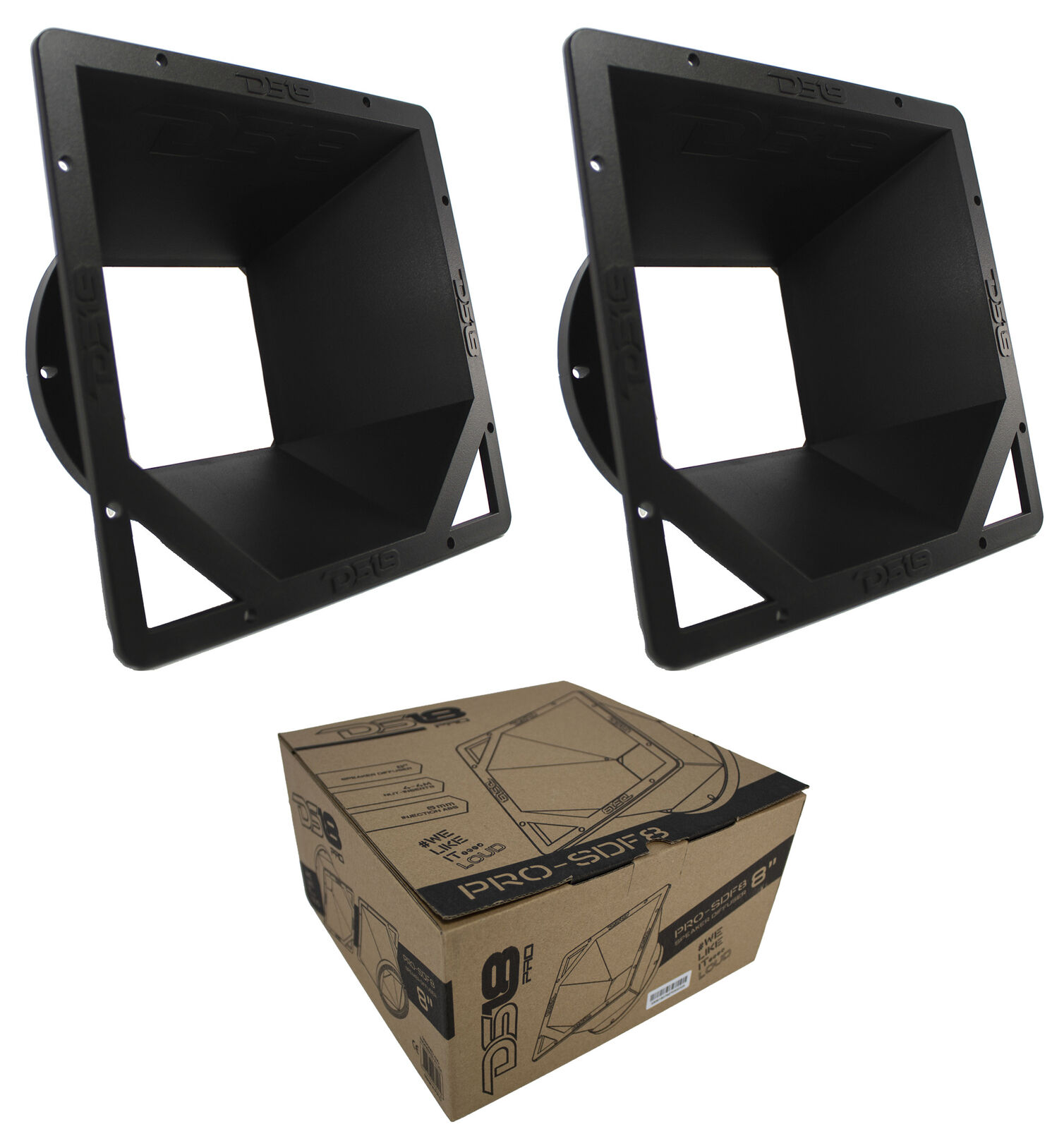

Horn flares
Are there any designs for mid-range horns? For the PRV 5MR450- ?
I bought a 6.5 inch horn from China, but have not found a suitable driver so far.
I have an 8 inch speaker with the following specs; I bought a horn flare to suit, but seems small; I need to crossover at 250 to 300HZ .

In this thread post 96:
https://www.diyaudio.com/forums/ful...ndy-fast-waw-applications-10.html#post4033969
Go to Volvotreter’s website - there is a spreadsheet for tractrix horn design.
Tools – Volvotreter Homepage
xrk971
Thanks very much!
I will check the website.
I do have a Dr Edgar tractrix horn, made many years ago
Phil
Thanks very much!
Phil
