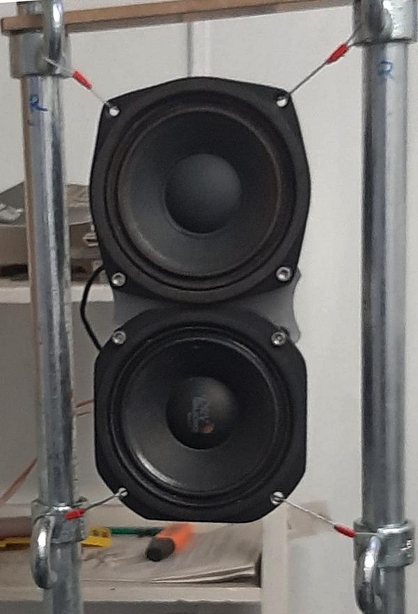

I now use the PRV 5MR450 with the Beyma in a Baffleless line array design
I found the Beyma a bit light in the mid-bass region but better in the treble. Now have the best of both designs
I listen to a lot of progressive metal, Fusion and contemporary classical music. Using the FAST approach works really well
Because they are not trying to do deep bass means the drivers are not working as hard, leading to a very fast punchy sound that manages to do complex music justice.
I have my sub coming in around 340 with quite a steep curve, but I am using in Baffle-less design I am not cutting off with the PRV drivers. I think my friend bass comes in around 300 but might be lower but he is using 4 PRV drivers per channel
I am using a Behringer INuke DSP to control the bass crossover and power the bass drivers
