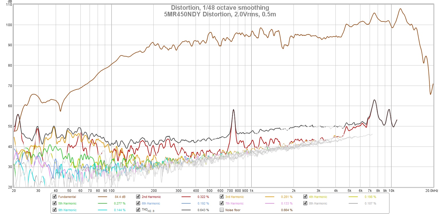

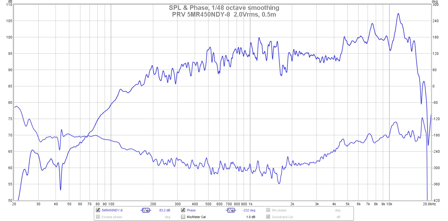

A member asked me if I had impulse response measurements of this driver. I did but lost in a hard drive crash years ago. Anyhow, I repeated the measurments today using the following gear:
UMIK-1 USB mic calibrated by Cross Spectrum Labs, REW software on Win 10 HP Laptop with 32GB RAM and 2TB HD Corei7 CPU, USB Khadas Tone Board DAC running at 48kHz/16bit (REW compatible), BTSB preamp, LSA Warp-1 (TPA3255 amplifier with balanced XLR inputs from BTSB). Vrms measured with Fluke 116 at speaker terminals. SPL level calibrated at 2.00Vrms 1kHz sinewave tone using Dr Meter SPL meter on dBA scale. Measurement made at 2.00Vrms and distance of 0.5m (allows equivalent translation to 2.83Vrms at 1.0m) and avoids ground reflections.
Freq Response:

Harmonic Distortion:

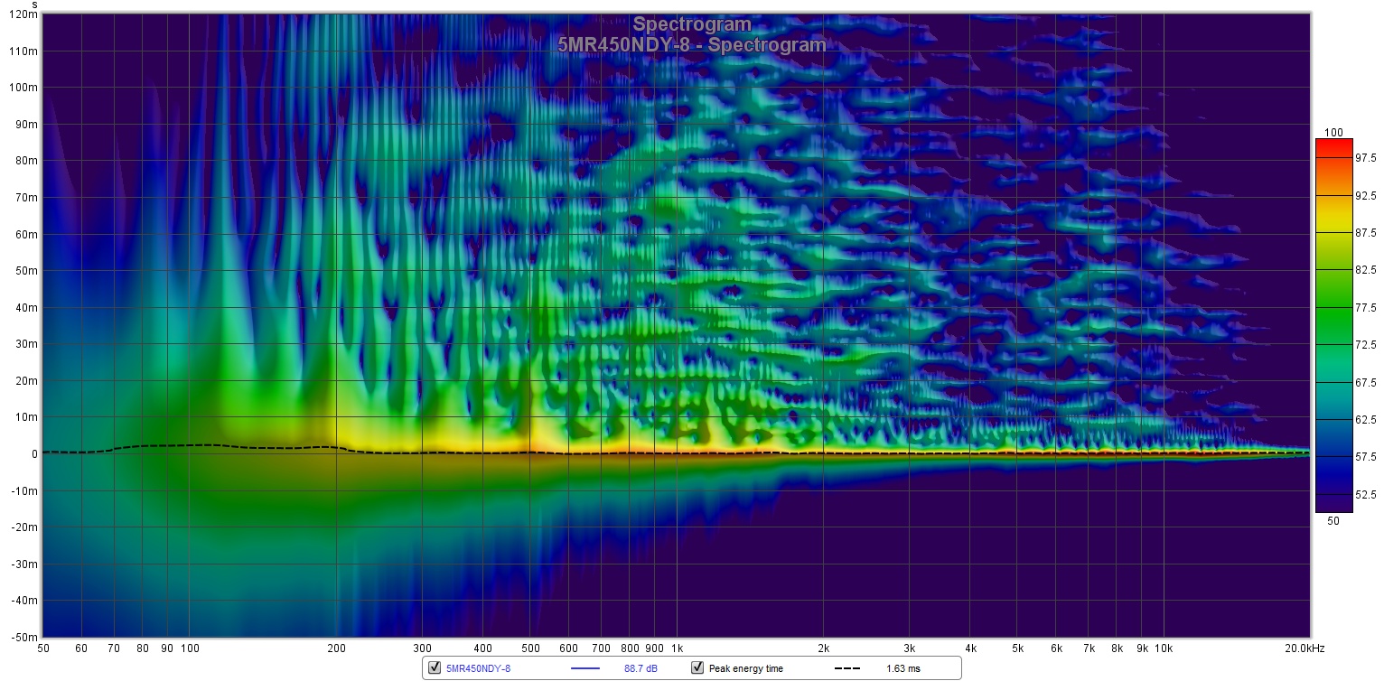

Spectrogram:

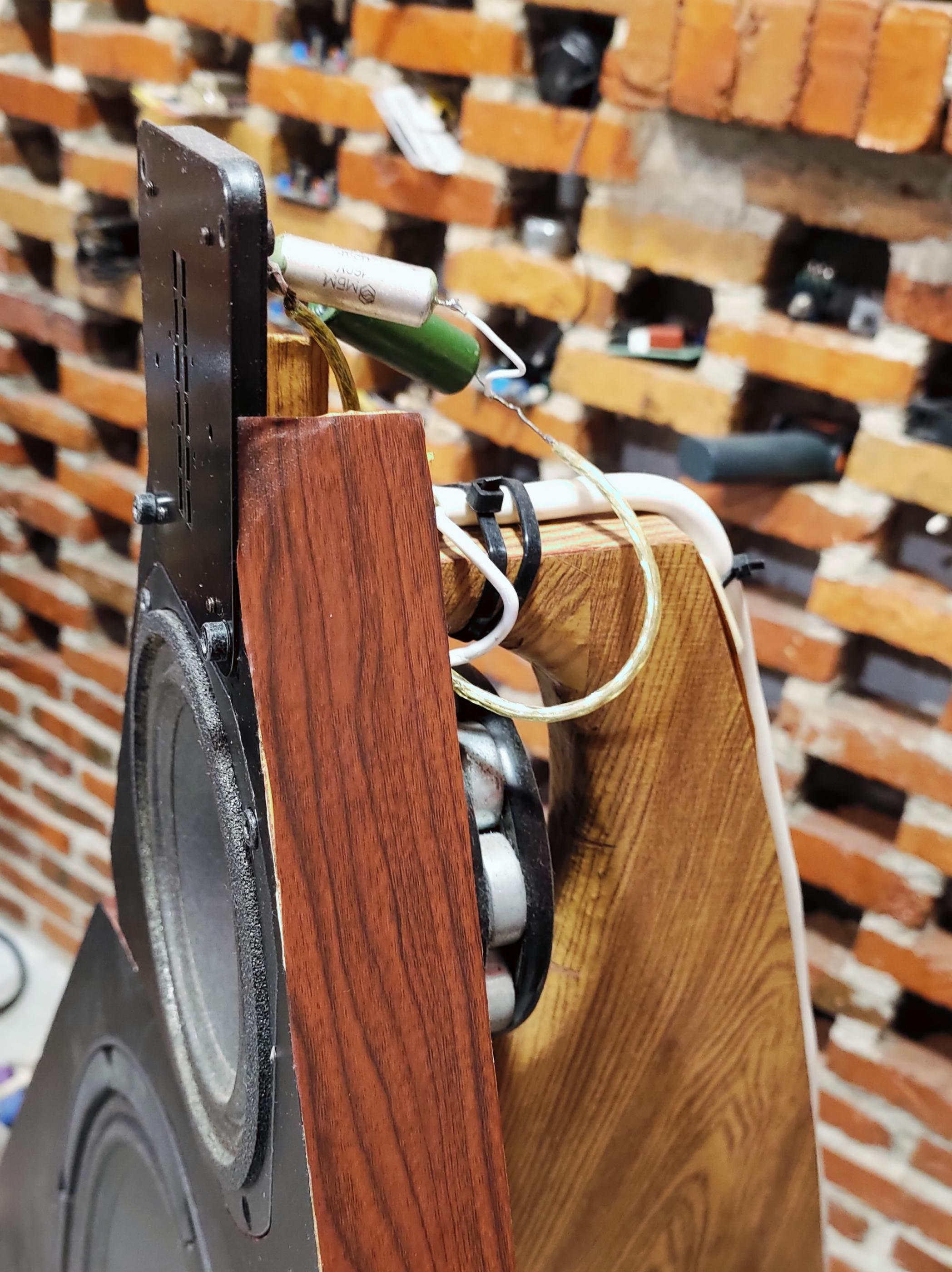

with harsch xo @320Hz, i put additional eQ on 12 16 20kHz gradually 2 4 6dB. it sounds better
with beston rt-002a given 1.5uF filter, it's getting better for the airy impression. previously i used 3.3uF but it was too dominant that jeopardize overall sound
I removed the faceplate just because of practical option in order to match with the baffle. with faceplate will make it unbalance look
due to high crossover cut, i don't notice any difference with or without faceplate, maybe different story if you cut it lower.
previously I had tried to cut lower around 4-5kHz then i found it was unpleasant. better to cut it higher above 7-8kHz

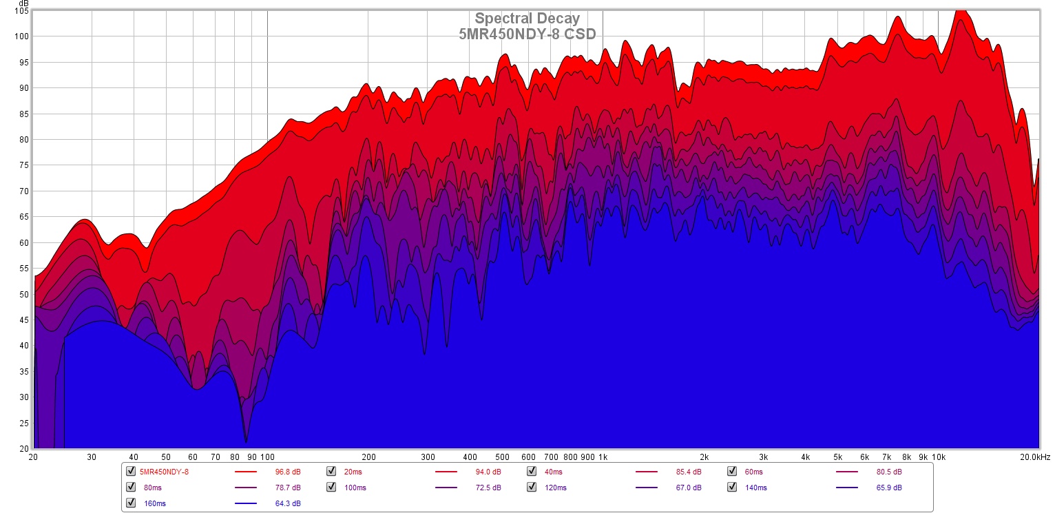

I had a request via PM for the CSD of this driver. Not sure if these were made with the correct settings.
CSD (200ms window, 50ms risetime):

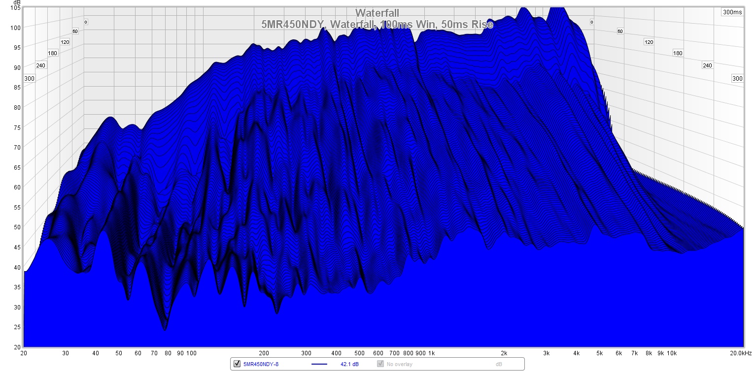

Waterfall (100ms window, 100ms risetime):
attachment.php
Waterfall (200ms window, 50ms risetime):
attachment.php

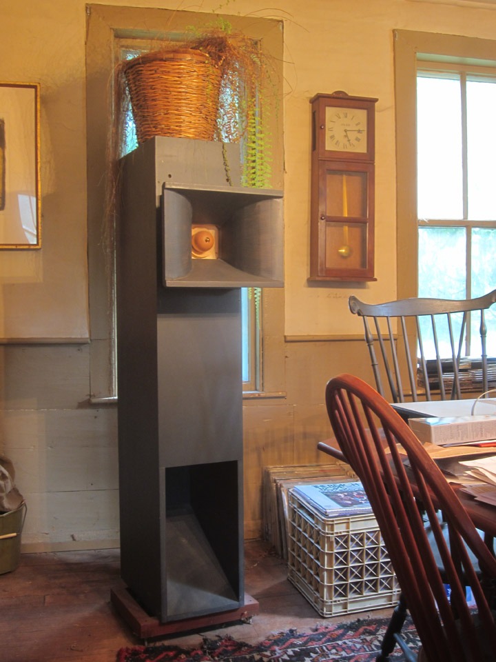

Hi, This thread needs a wake-up! Well, perhaps to keep this thread going, and to confess that I ordered a pair of the PRV 5MR450-NDY from Parts Express. on the basis of positive reviews for them here... I read the first three and the last three pages of this thread and I was hooked.
What will I do with them? I arrived here (somewhat late) from a search for the <Bruce Edgar Show Horn>, which interests me for frequencies up to 400 Hz or so. My current system has music playing through what I call Front Firing Fidelios (FFFs) with Lowther PM2As with (made by) Bruce Edgar front midrange horns having 4 x 4 inch throats, see attached.
So, my immediate thought is just to remove the PM2As and do what's necessary to replace them with the PRV 5MR450s. and give a listen. ....
What to do for frequencies less than say 400 Hz.? Well, I have a pair of Petite Onkens that should do for a starter try if deemed necessary. But I'm really curious about the Edgar Show Horn...unfortunately there's not much to be found about builder's experiences online. I've considered Karlson X15 and K15 and I have Altec 515-8Gs, but at present no affordable Karlsons are available unless I were to build them...same goes for the Show Horns.
Amplification is Loftin-White 24A/45/James 6123H (5K), Preamp is 5687 WOT from Sound Practices issue #10.
I'm curious to hear your thoughts on this if you would care to reply...what to do?
