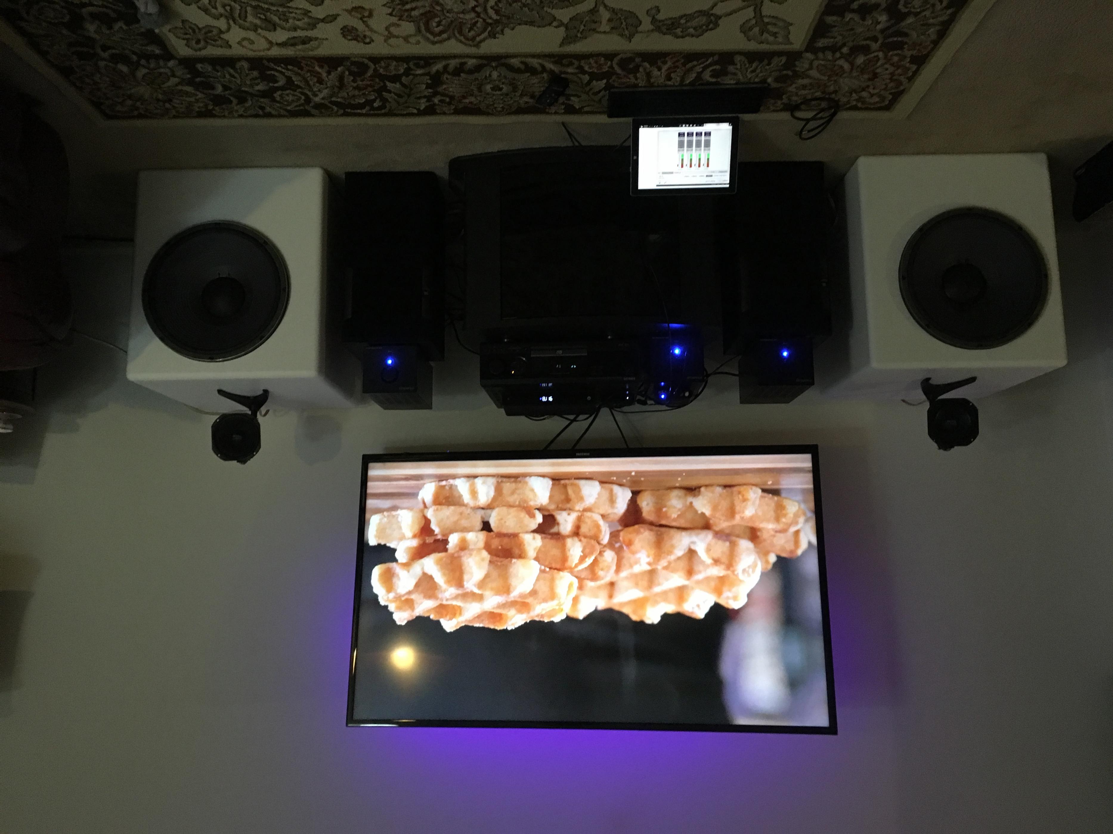

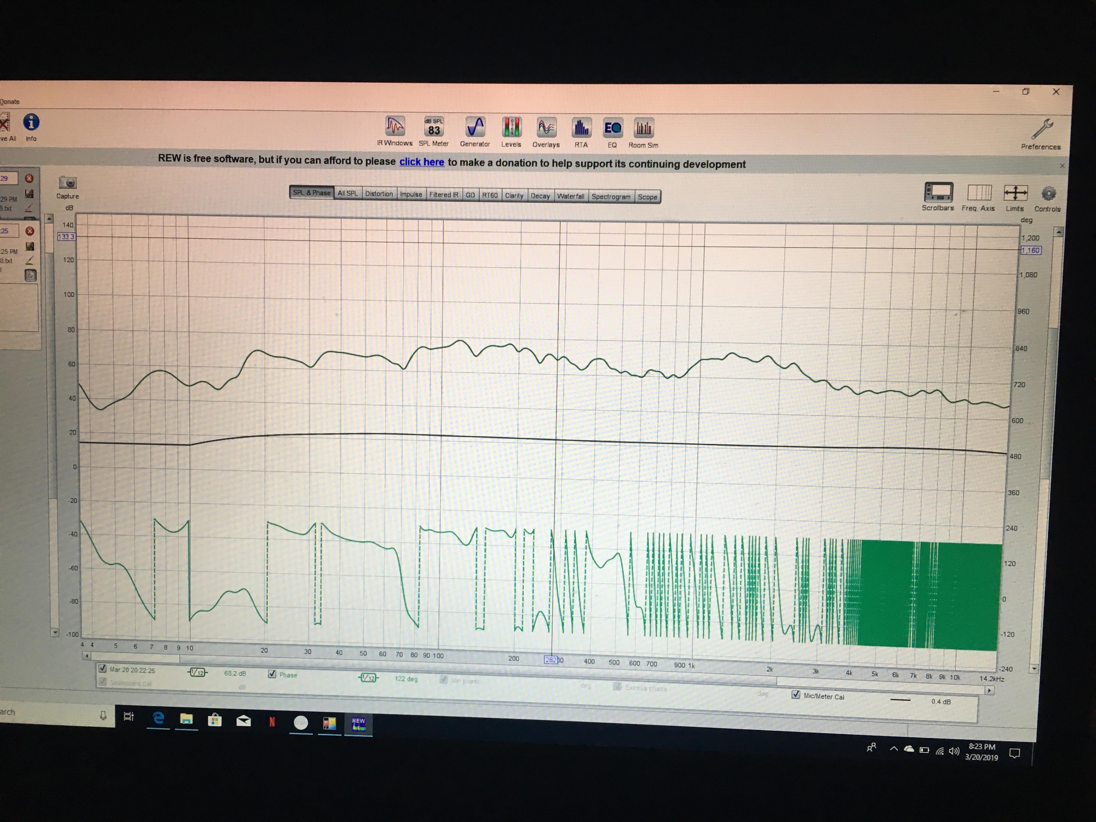

Initial testing without any equalization...
I’m telling You it sounds amazing straight out the box!
Movies will need a bit of a bump toward the bottom but music is absolutely stunning.
It’s too late to really get the cones moving, tomorrow will be a new day hopefully finding strange room nodes to eliminate.

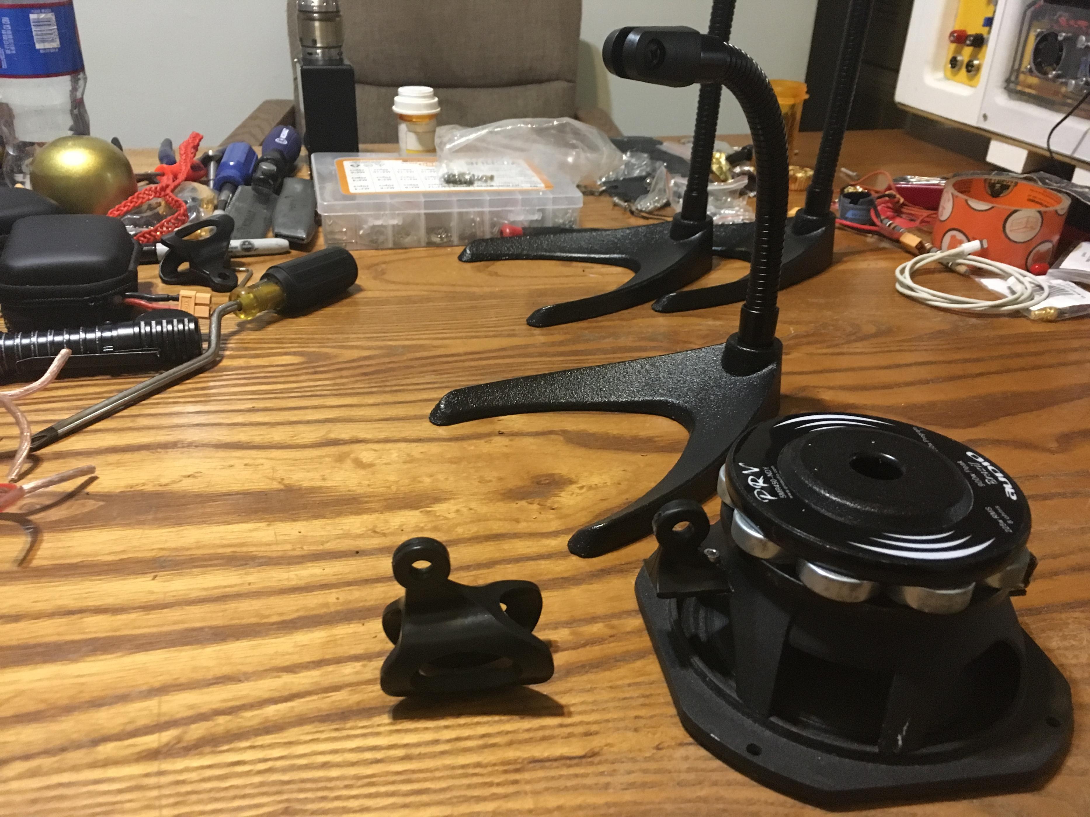

What initially caught My eye was the neodymium array while I was digging around looking through the open box deals at Parts Express.
My further research online brought Me here!

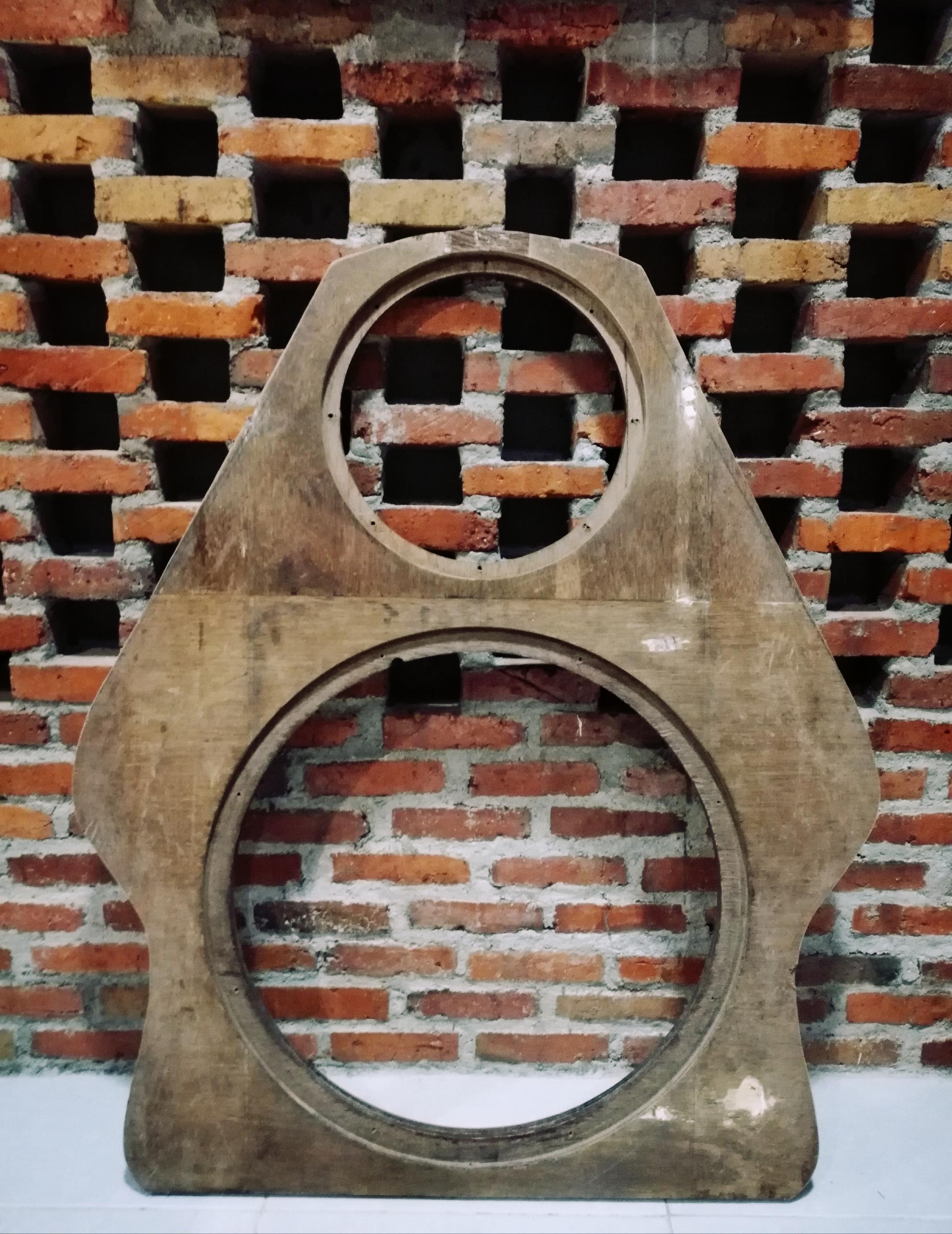

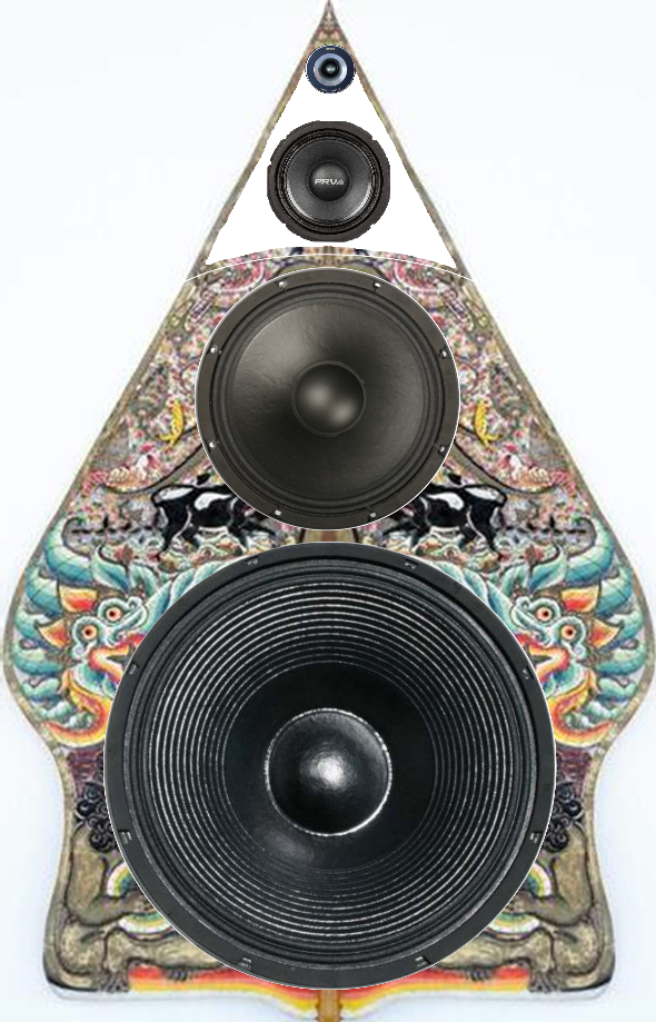

here is my OB design with 21" & 12" pro audio drivers, sketched using ms paint. top baffle either steel frame or crafted bb/cc plywood, already cut the lower baffle.
I have behringer nu3000dsp, minidsp 2x4HD, and LXmini board from diystore to be completed.
3 class a amplifier for prv, aragon2004/myrefC gainclone for 12". also a pair of 2x12" opposed subwoofer is on my workbench which will be powered by behringer, either 21" to be driven from LXmini board or the prv.
hopefully this a can be completed this year.
