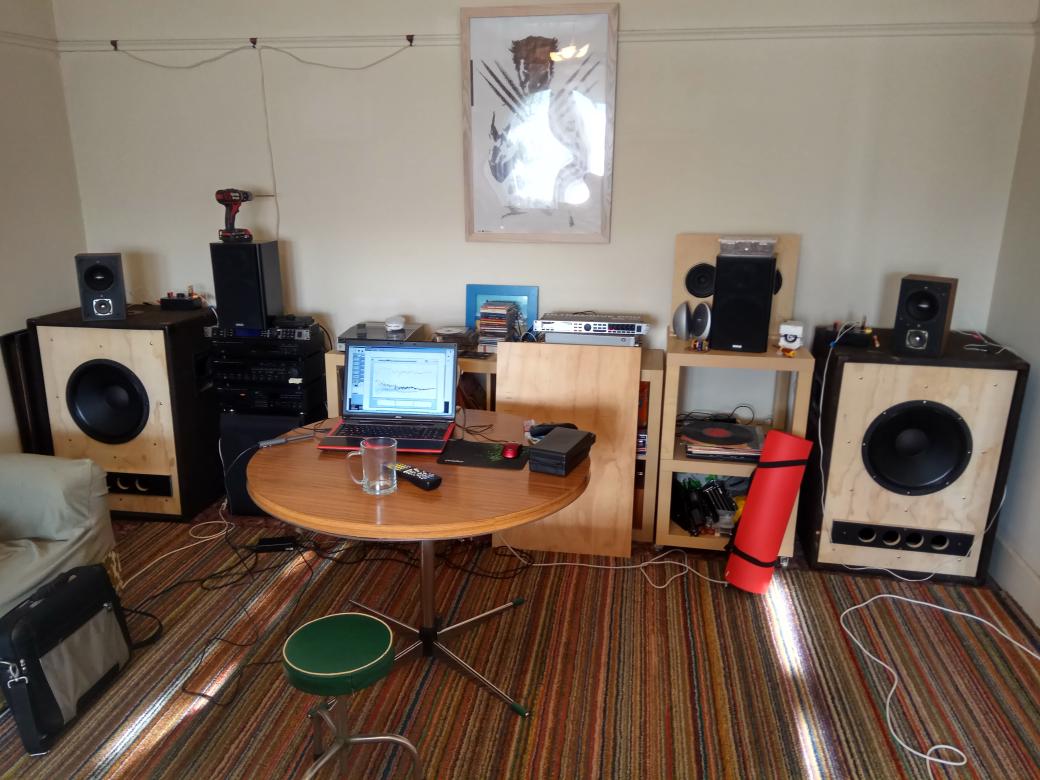

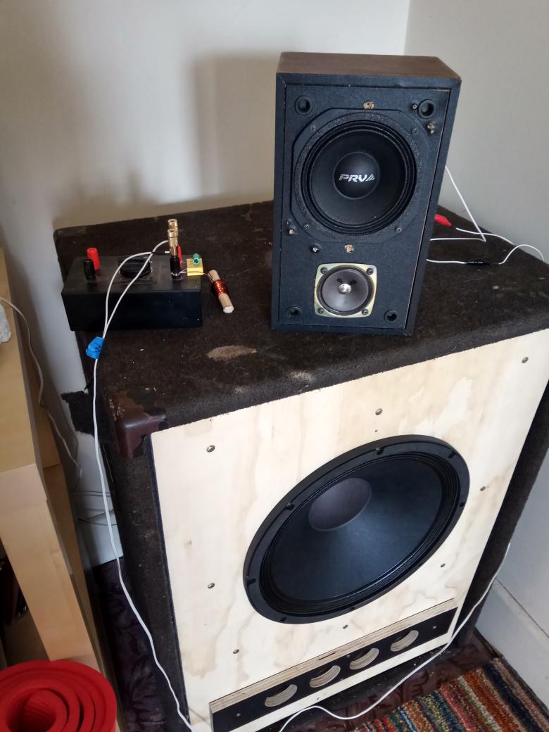

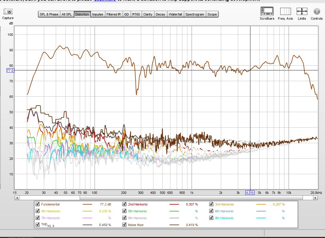

I've included an in room measurement 1.5m from the PRV, in room. There are a lot of issues with this room, but the whole setup sounds great all things considered. Actively crossed over at 360hz, 12db/oct and same levels for low/high
Next is to work out an enclosure and then a passive crossover

If you don't toe them in so much, it should level that little rise at the end, still giving you air.
Too bad your room is not suitable for OB.
As for the enclosure, make it a "dagger" style, not very wide, but a long "tail". Stuff the tail and it should sound very good.

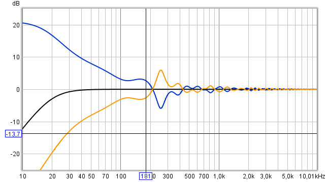

Forgive me i can be wrong here but looking up the living room in post 381 it looks woofers get two very close boundery's and ploting such numbers in a dirty quick room simulation show you need about a 2nd order -3dB point roll off at 100Hz to arrive a final 2nd order system 20Hz roll off (speaker+room). Black trace below is 20Hz target as most track material is referenced to when mastered then divided by blue room curve result in orange target curve for JBL's : ) and a guess is your planned low end roll off is much too hot to sound any natural in room situation at post 381, but as said i could be wrong what is the real situation : )
