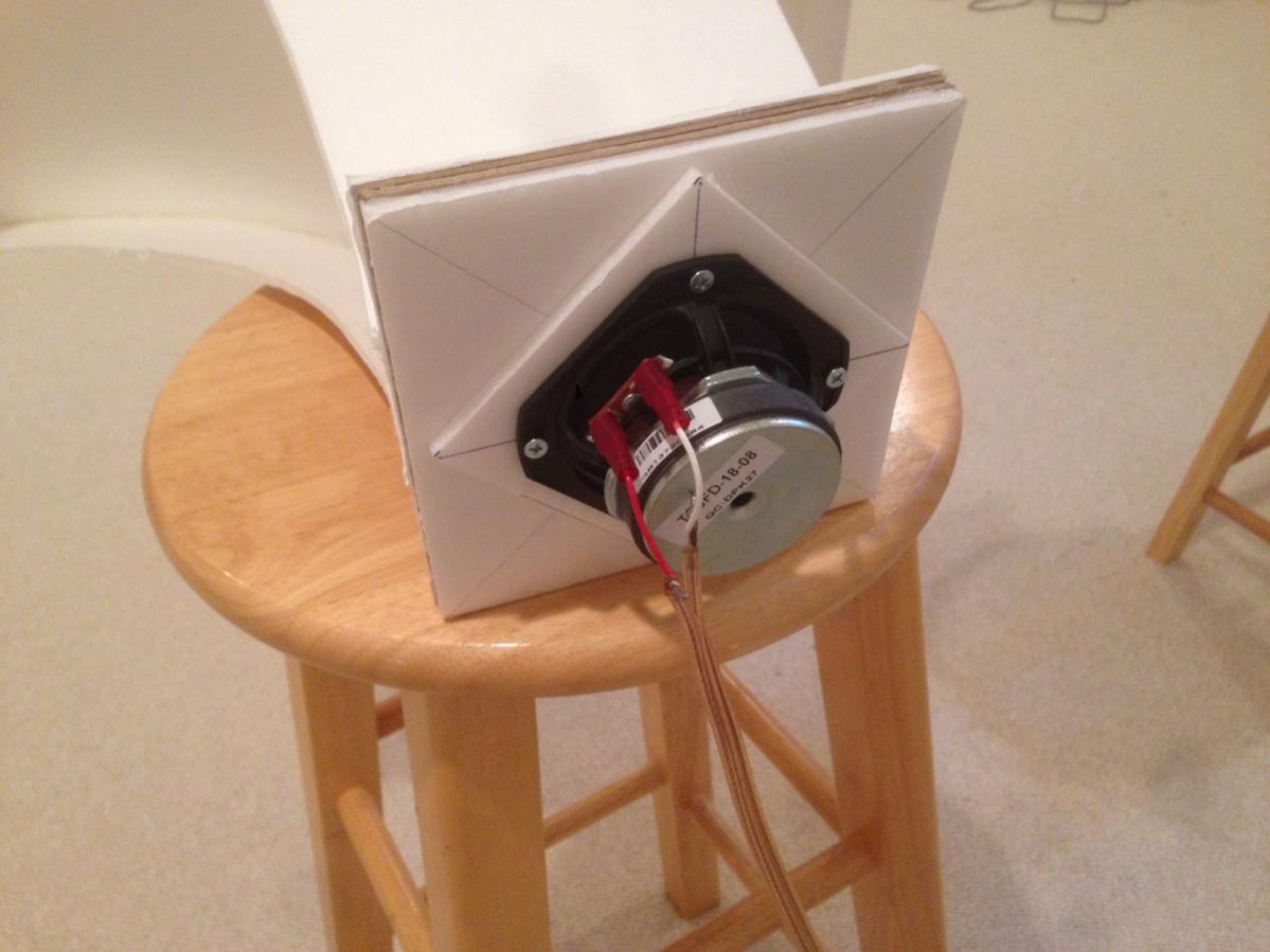

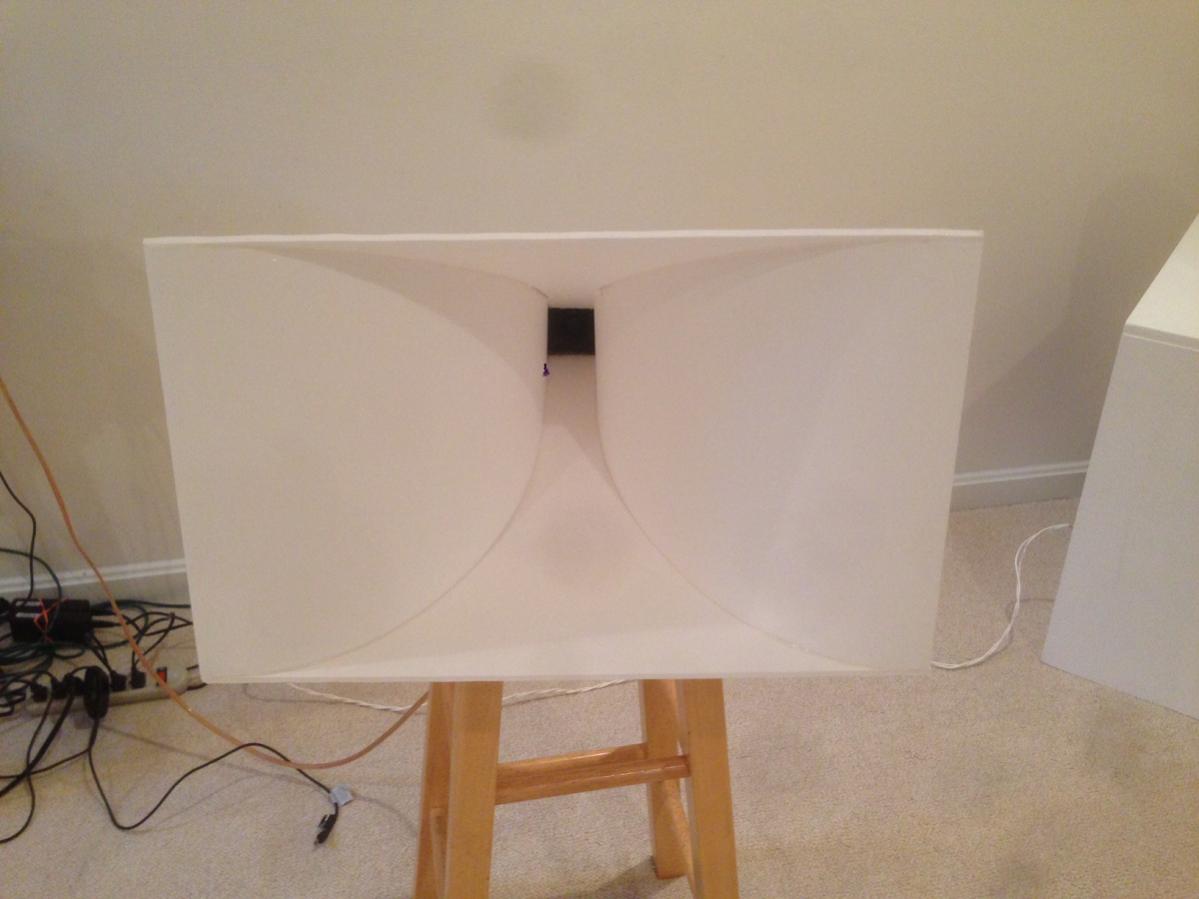

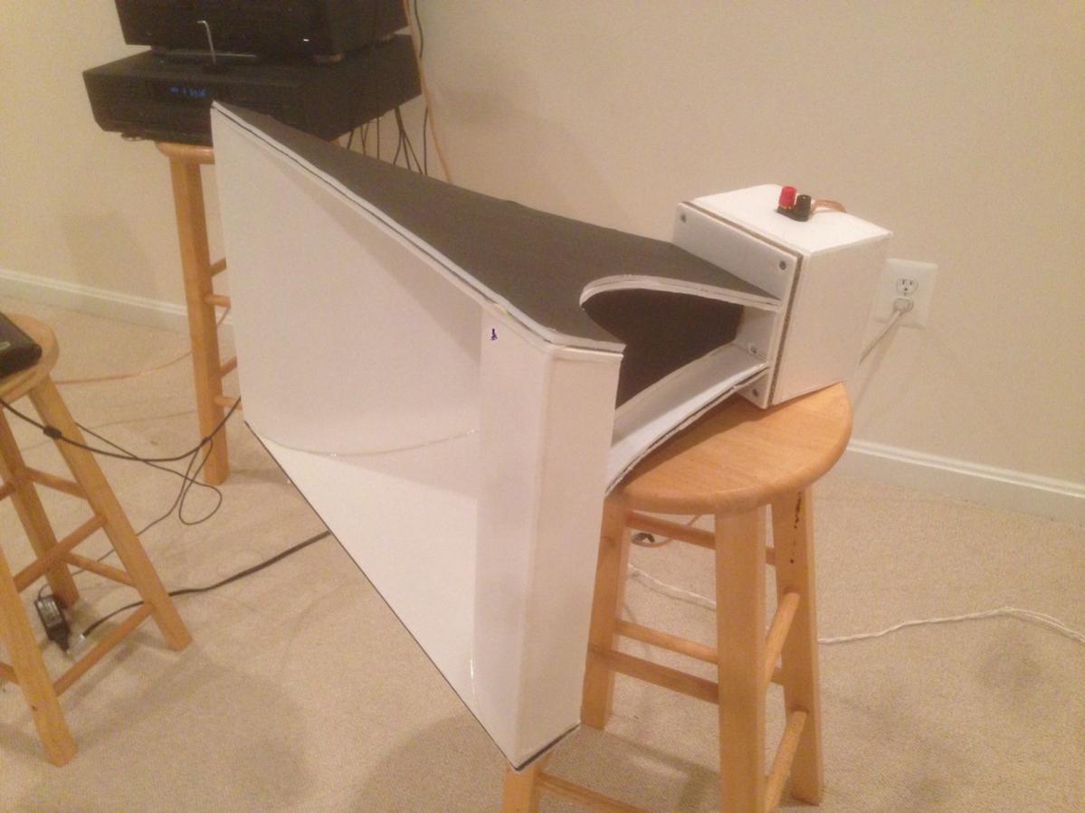

0.70x scale Tractrix Build
I threw together another tractrix, this time at 0.70x scale of the first one. The dimensions ended up being 20 in wide x 12 in high x 15.8 in deep with a 1.95in square throat and a 2.3liter rear sealed chamber. Having done the first one provided lessons learned that made this one go very quickly - 4 hrs total. Also, the smaller size made it a lot faster to cut. The design is for a Faital Pro 3FE25, but while waiting for that driver to arrive, I thought why not try out the Vifa TC9FD? It is probably ill suited as a front horn driver with a very soft suspension and a rather weak motor for a high Qts of 0.89. Anyhow, I have them around so I stuck it in for grins. And it turns out not to sound so bad with some EQ'ing.
Here is a photo of the driver mounted onto the throat flange, I had to add a spacer to allow for the rubber half-roll surround to clear the flange:
Here is a photo of the finished horn complete with constrained layer damping (CLD) using caulking and a second layer of foam core:

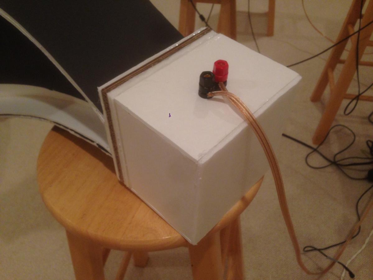

Here is a closeup of the sealed rear chamber (lined with gray open cell foam):

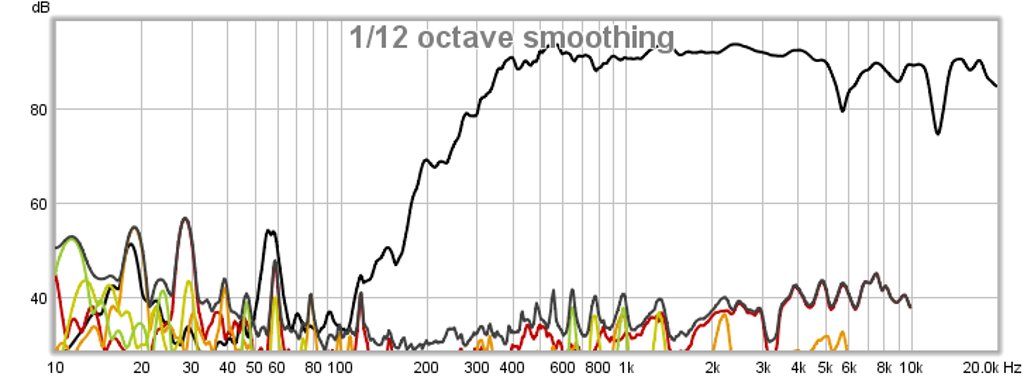

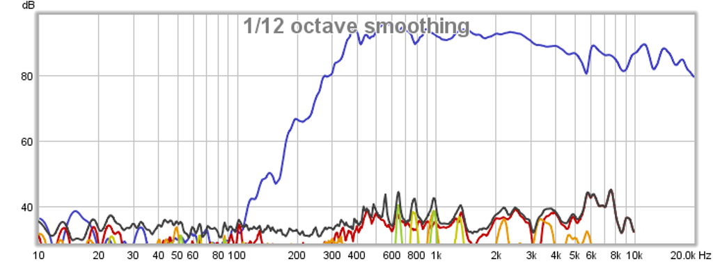

Here is the frequency response and harmonic distortion with the EQ on and a -24dB/oct BW HPF @325Hz. It really surprised me how much HF there is all the way up to 18-19kHz and HD is actually remarkably low:

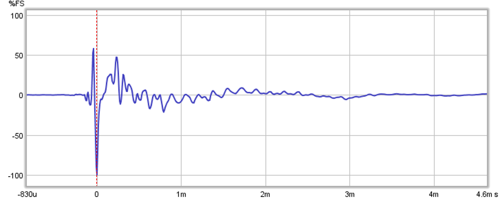

Here is the impulse response of the EQ'd horn:
The TC9FD, having a soft, under-damped suspension and a weak motor reacts to the acoustic impedance within the throat and chamber causing many peaks. However, with some EQ'ing, the response can be made to sound quite pleasant. Listening to it, it has the characteristic tractrix horn focus that enhances vocals and intelligibility, and most of all, it is quite loud but still clean and undistorted. I think I gained +10dB in volume after the EQ'ing.
Here are some sound clips to go with it. I think you will agree that the vocals of a Vifa TC9FD in a tractrix horn has a fluid like smooth quality to it.

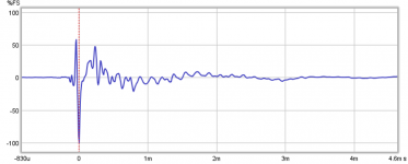

New EQ for 0.70x Tractrix w/ TC9FD

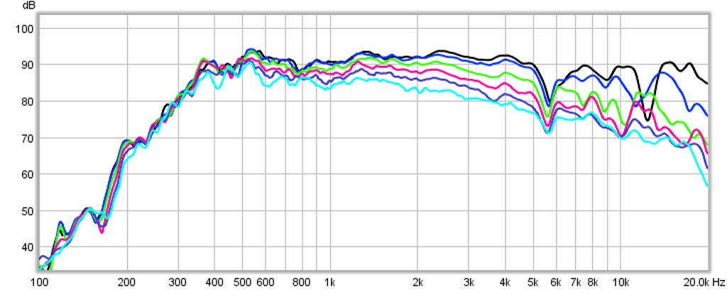

Ok, I could not resist playing with the EQ some more, and I admit, this is HEAVY EQ so don't flame me. It is just an experiment to see what it might sound like if I had the right driver.

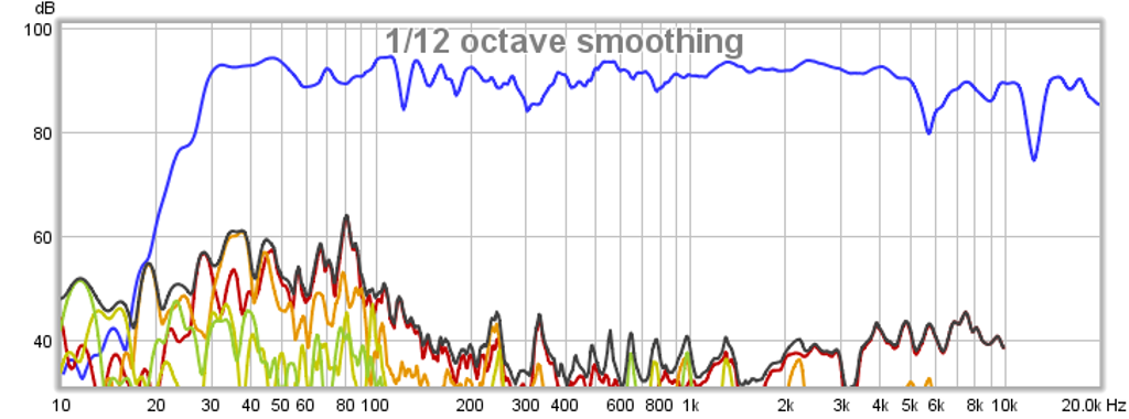

Here is the new response and harmonic distortion at 0deg. I EQ'd some peaks off-axis to improve the impulse response and smoothness for a more general off-axis case but they show up as dips at zero deg.
Here is the Polar Response with the new EQ:

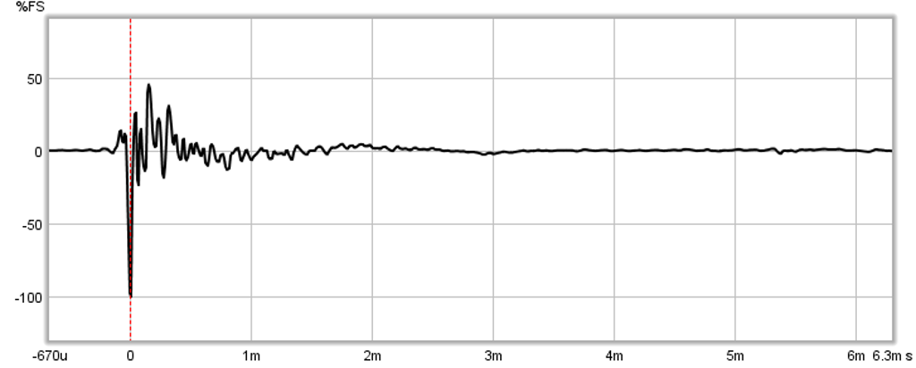

Here is the Impulse Response at 0 deg:
Here is the system response with sub woofer added (24dB/oct BW XO @ 325Hz):
Listening to it, it sounds better - more balanced, less "hollow sounding" and transients on percussion are more crisp.

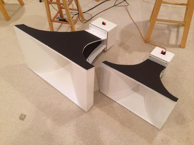

Here is a photo so you can see the difference in size between the fullsize and the 0.70x - it makes a big difference. The smaller one is much more "home friendly".

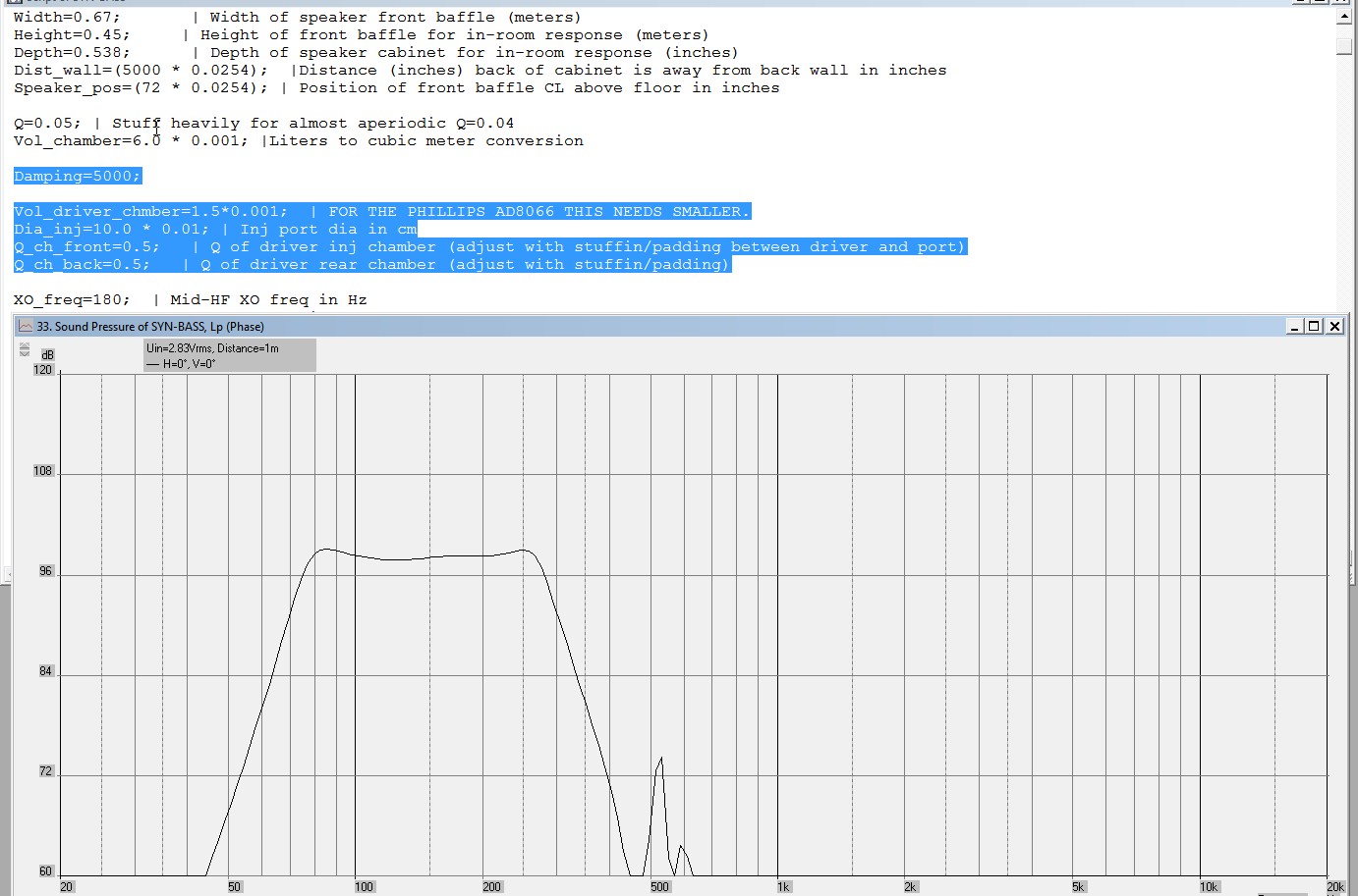

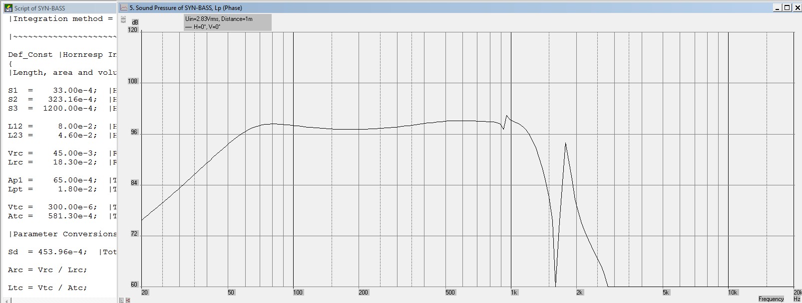

Thanks, I did post a sim from your script where i did use a phillips driver.
remove all others I have only the bass section simmed, I have put drivers is serie with the nodes. and make the chamber smaller and port smaller (10cm now).
see blue part in ficture.
I do not now what the resonance part of the high speaker will do sound, I needs high quality sound, maybe it is for this part better to co conic synergy who do sim also very good with high reach of the phillips woofers bass sections. see picture two, here I can use a CD driver or a normal tweeter.
By the way sim a tweeter in the port, how to do that best? most, better say all has no thiele small parameters.
change port in your design script to this because of 18 mm thick wood panels here.
BR_dia=6.5*0.0254; | BR port dia inches
BR_len=18.0*0.0254; | BR port length inches
script in zip is only for high driver, everything else is removed and is in 2 parts now, tapped horn is not yet needed and I have own design for this

here again.
Kees,
The default units in AkAbak are meters which is why I multiply inches by 0.0254. The BR port is a long port for capturing the back wave energy as a bass reflex and redirecting it into the horn mouth. This port is of order 25cm or more. The 18mm thickness you have affects the front chamber injection port. 18mm would be set as 0.018m in the other Len variable not the BR length.
